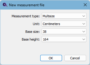

You start a new file in SeamlyME. Select Multisize and size 38 as your base size.

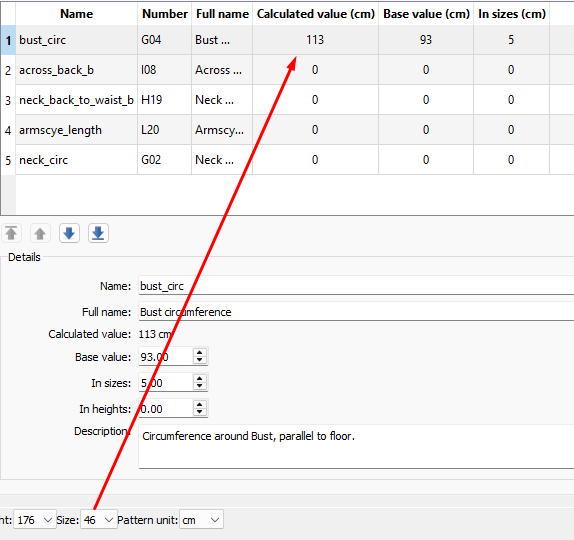

Once you have them listed, you go down the list adding the area’s base size measurement (for size 38) and the increment. Ignore the Height.
You will notice (in the bottom left) you can change the size:
As soon as you change the size, the Calculated Value changes:

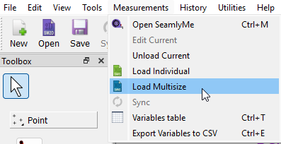

Once you have completed your Multisize Measurement File, you can save it (actually, I save often), open your pattern & go to Menu > Measurements > Load Multisize & point to your new measurements file:

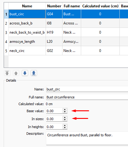

I created a Multi Size file in Seamly2D.
Then imported the T-Shirt pattern into It. Then below chose the size of the T-Shirt pattern which is 38. (And I specified It is base pattern on SeamlyME)
Now It is supposed to be Base Value Column NOT empty. Right? Or do I enter the measurements of the imported T-Shirt again?
You need to enter the measurements again and also the increment value for each measurement.

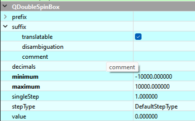

Could we switch it to a formula (line edit string)… sure. If that seems like a useful thing to do? It’s just a bit more work to validate the value, as a QLineEdit box does not come with a value range like a the QSpin boxes do. To be honest I’m not a fan of spinboxes as it’s easier to just type the number in by the time you spin to the number you want. It’s just that you can easily set the Int or Double range of a spinbox in Creator. Here’s the size increment box:
I have no idea why the range is -10000.0 to 10000.0? Unless it’s later being set in the code. A spinbox also has a validator that filters out anything but 0-9 and a period.

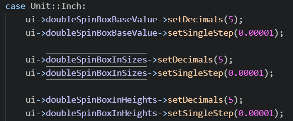

Just for heck I checked the code for the size & height increment spinboxes - while it doesn’t set a min & max for the range, it does set the decimal places depending in the units. What’s obsurd is it sets the Inches to 5 decimal places and the single step to 0.00001… that means the boxes step from -10,000,0 to 10,000.0 by 0.00001 of an inch. Sure… no problem measuring 1/100,000 of an inch. ![]()
Of course as I thought about it, since the size and height increment values are treated as real numbers, we’d have to change the schema so that they are strings to acommodate a formula. The tedius part being - as usual - that earlier versions would have to convert the number value to a string.
