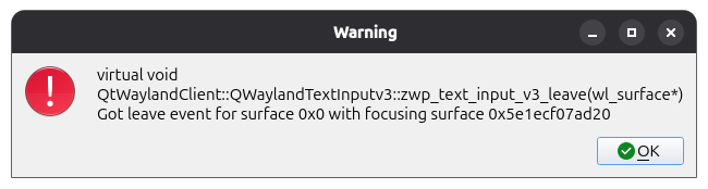

I have installed Seamly2D via Flathub on Ubuntu 26.04. Installation seemed fine but I have the following issues when running either Seamly2D or SeamlyMe (these pop up every few seconds):slight_smile:
Anyone has any idea?

The error itself is just noise from Qt’s Wayland code. The problem is Seamly shows every one of these noisy warnings as a popup dialog.
The issue has already been addressed, and the fix - which now just ignores the noise - should be in tonight’s / tomorrow’s release.

It’s been reported on Github that this issue was fixed in the latest release. :slight_smile:
