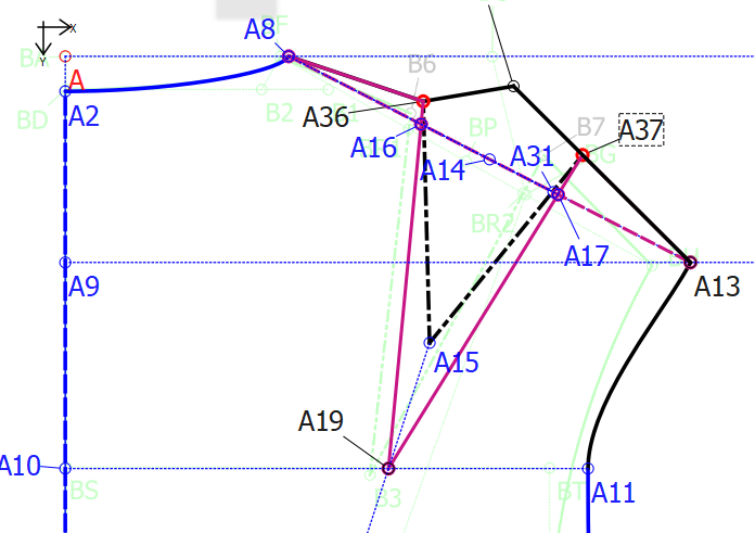

The True Darts tool does work very nicely. What you need to remember is that the real rotation point isn’t at the dart point, but normally quite a distance outside of the dart point.
For instance, the front shoulder dart rotation point is the Bust point but the dart point is normally 1 inch or 2.5cm above the bust point, so when you use the True Dart tool, you must ignore the dart point and use the bust point instead.
All of the darts on the front bodice can be successfully rotated to other areas using the bust point as the centre rotation point.
The shoulder dart on the bodice back is a little different. Normally the shoulder dart will be moved to the neck or the armhole, so if you create a point on the across back line, in a line from the centre line of the dart, the true dart tool works very well:

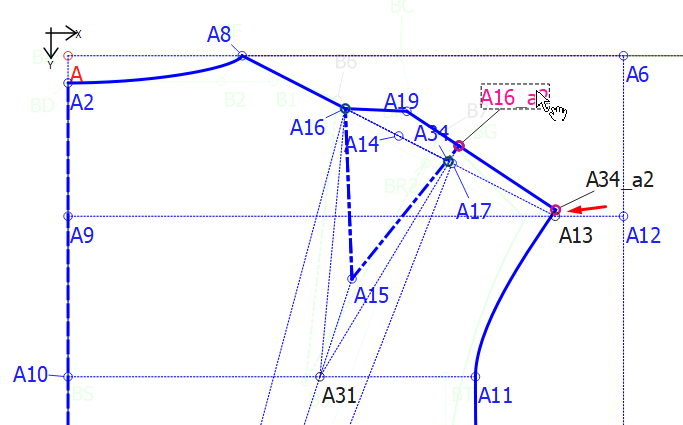

With the dart rotated closed and opened at the armhole:

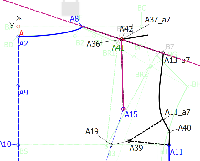

If you use the rotation method on the shoulder darts, the shoulder tip point will reposition so that it isn’t in the correct position any more, making the armhole height too low or too high, like this:
To get this difference to be so little, I had to use a rotation point at the centre waist, so this isn’t really a very good example, but it will give you an idea of how the shoulder tip point can move when changing sizes and rotating points for the shoulder dart.

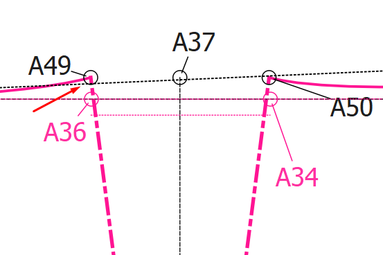

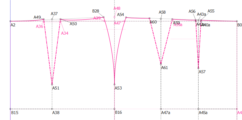

Skirt darts are like waist darts on the bodice, just upside down. You don’t need to use the True Dart tool.
Normally you will have a slanted line from the center front/back to the waist side. You mark the centre of the dart and mark the length of the dart downwards to the dart point.
Place a point half of the dart width on highest side and then use the Mirror tool to place a point at the same height on the other side of the dart centre line. Place a line from the dart point to the new points and use the angle of this line in the waist curve formula (+ or - 90°). Only draw the curves between the different sections - center to dart 1, dart 1 to dart 2, dart 2 to side seam.
Here’s a pic of a very old pattern that I made:
A close-up of one of the darts:
I didn’t use the mirror tool in this one but the principal is the same.
