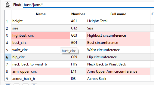

First of all, when you mouse over the .* button, you will see a tooltip which reads “Seach by regular expression” (@Douglas, I think we found a typo!) So when you click the button all you are doing is turning that search type on or off. A fairly recent addition, I haven’t experimented with searching by regular expression in SeamlyMe yet.

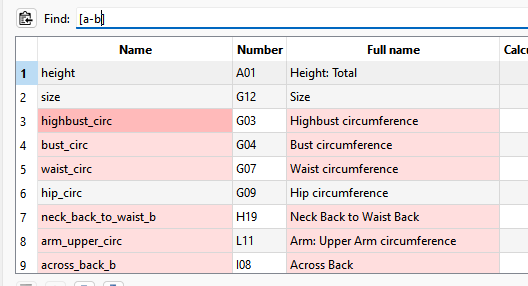

It’s probably overkill as it take some knowledge of regex syntax, but you can do more refined searches. Here’s simple find any te that contains an a or b (case insensitive):
or here any text that contains arm or bust

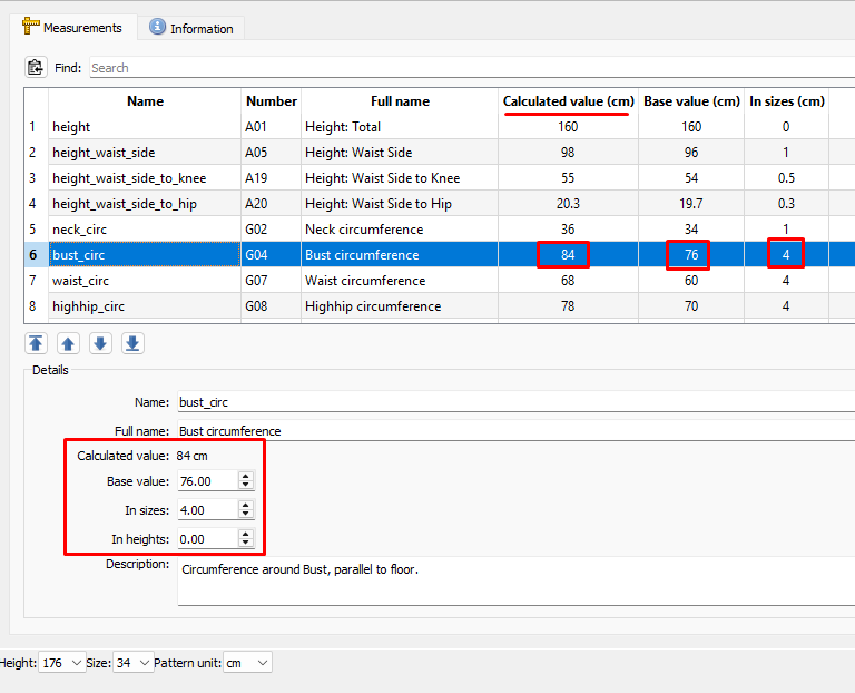

Currently, the multisize measurements don’t work on uploading each size separately but you enter a base size and add an increment value between each size. For instance, if your base size 76, for a size 30, and the increment value is set to 2, then if you change the size (in the bottom left of the screen in SeamlyME) to 34, then the calculated value will change to 80, size 36 will be 82, etc.
Here’s an image of one of my multisize files:
