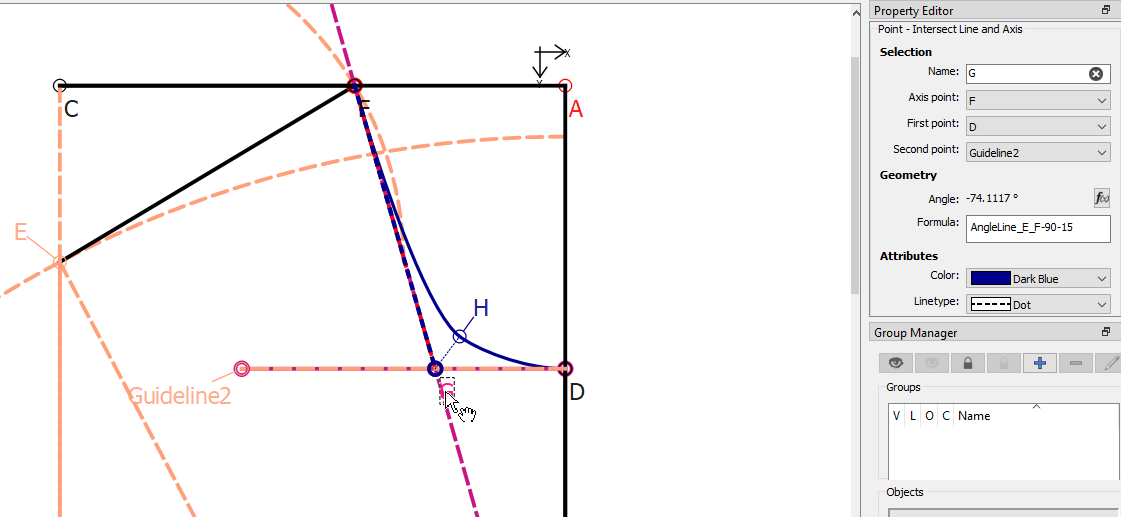

I changed the tool used to create G to the Point - Intersect Line & Axis tool. This way, you can fiddle the angle a bit (by just changing the value in the angle box) to get a curved neck line and I drew in the curve:
Whatever you change in the front neck line angle, you must remember to repeat in the back neck line when you get there so that, when you sew the shoulder seams together, the neck line will transition neatly between the front and the back at the shoulder.

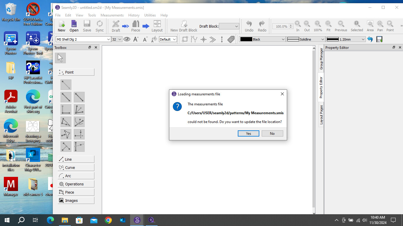

When I try to open the one you did I get this message
What am I supposed to do?
Just click on OK and point it to your measurements file. I saved the measurements file in the same folder as the pattern, so it can’t find it on your computer in the same place.

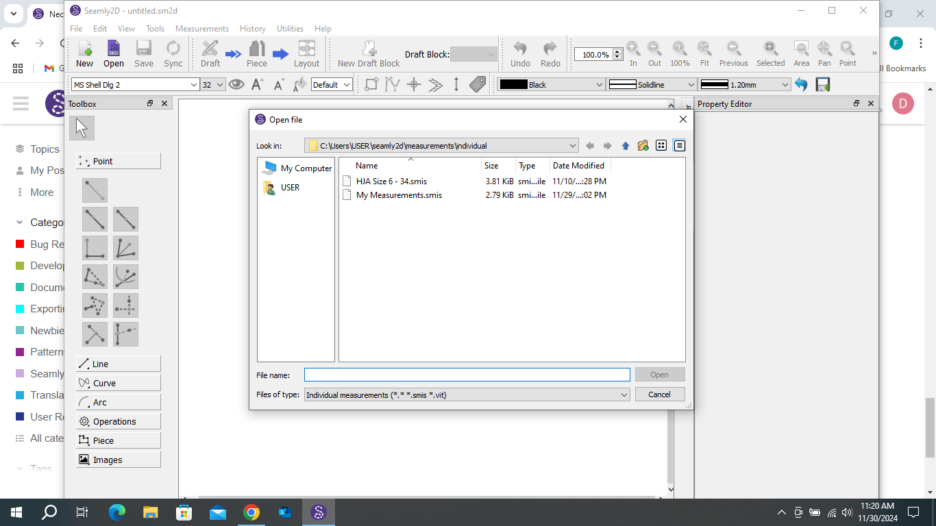

When I click on “yes” this is the next screen that pops up
Am I supposed to open my measurements file and give it a name and save it?? I’m confused, lol.
Just click on the measurement file & click on Open. It should load it into the pattern. Then you can save the pattern and carry on as usual.
