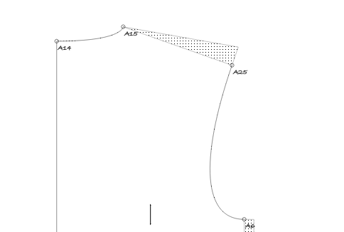

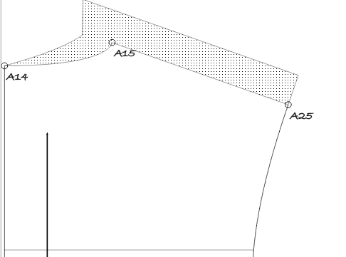

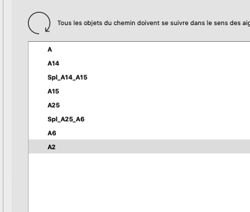

Hi! Can anyone tell me that’s going on there? I tried changing the SA angle but nothing happened. I also tried changing the path order and it just got worse…
For the fitting of the base bodice on my client, I don’t need any seam allowance on the neckline. When I removed it from the front piece, it did what I wanted, yet everytime I do the same thing on the back piece, I have this weirdness…
I don’t think I’d ever had that problem before but it’s now happened twice on two different patterns.
Thanks for helping me again
And sometimes I have this weirdness

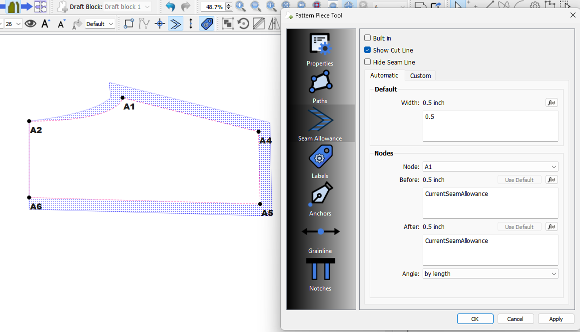

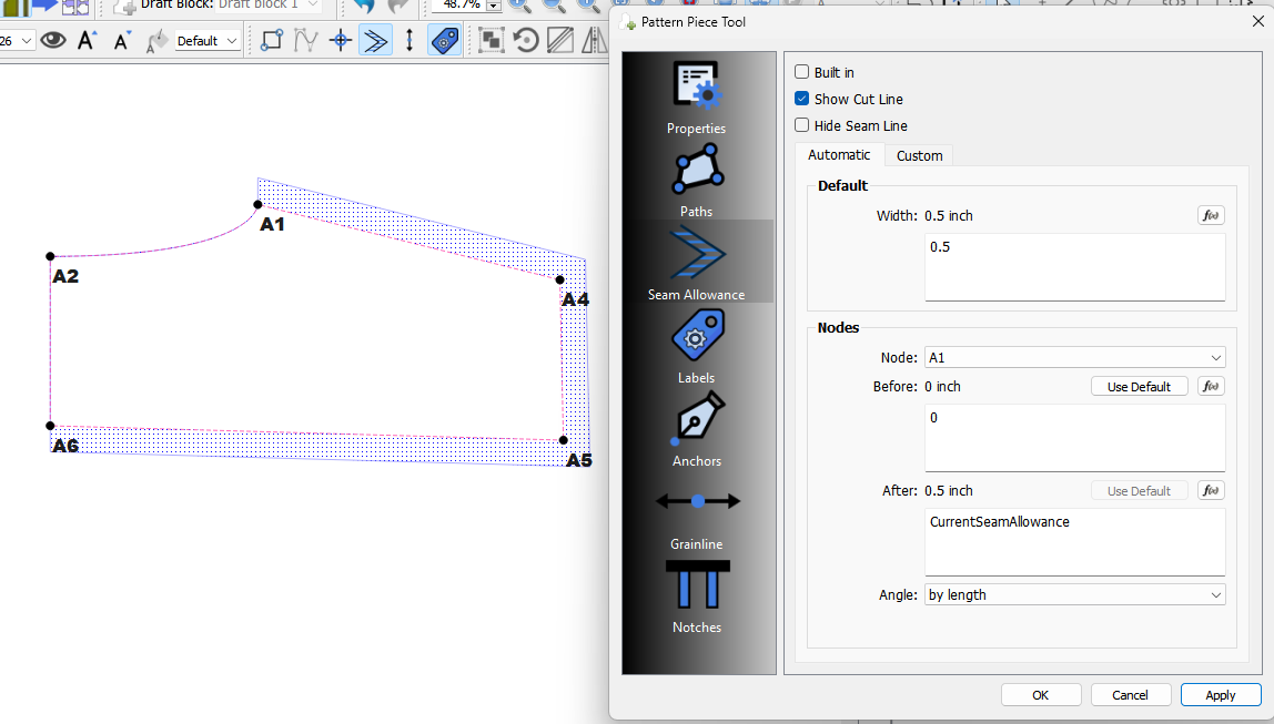

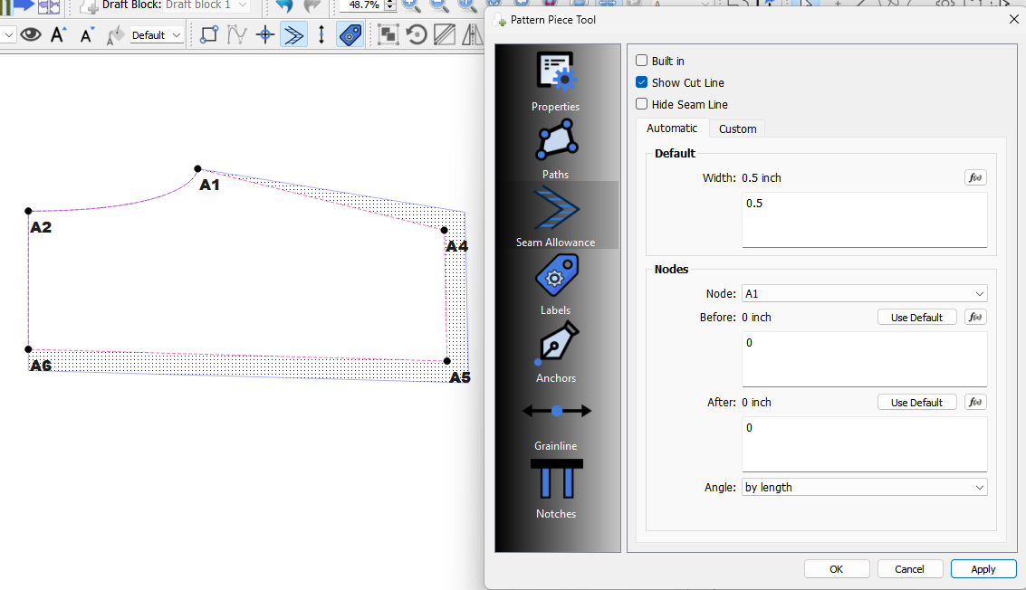

Without having the pattern… or seeing the SA’s at point A15… I can only guess that in the 1st case the Before SA at point A15 is not 0. Like:
In the 2nd case the After SA at point A15 is 0. Like
In either csse you want:
