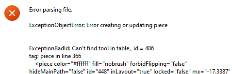

I am not sure what I did, but there is an “error parsing file”. Appreciate your assistance so I am use the file again. Thank you so much!

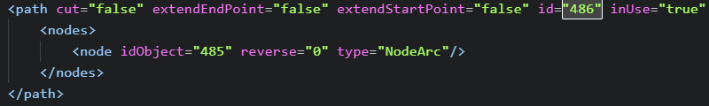

You included a path from the collar block in a pattern piece (line 366)made from the front bodice block.
Tool id=486 is the path in the collar block:
Not sure how that’s possible as the only piece available when in the collar block is the “collar” piece. ???
I removed the ipath from the piece and all is well.
