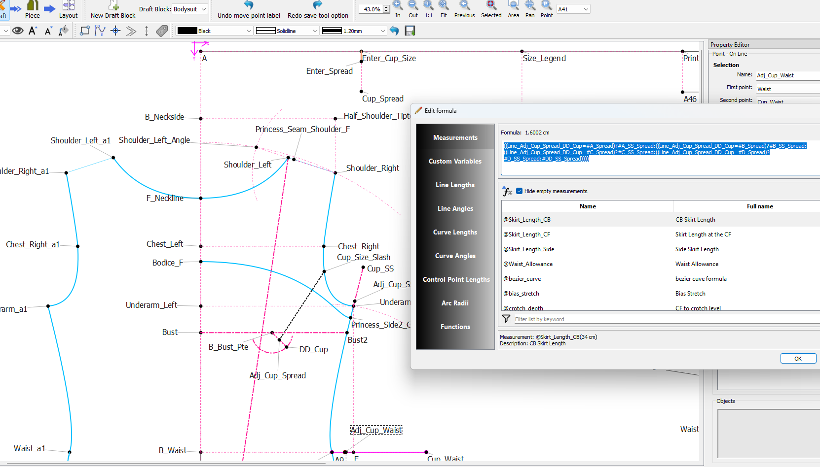

Hi there, I have managed to create a nested formula without an error, but for an unknown reason, it always returns the value of the first If. Can anyone please help me? Perhaps the format is incorrect?
((Line_Adj_Cup_Spread_DD_Cup=#A_Spread)?#A_SS_Spread:((Line_Adj_Cup_Spread_DD_Cup=#B_Spread)?#B_SS_Spread:((Line_Adj_Cup_Spread_DD_Cup=#C_Spread)?#C_SS_Spread:((Line_Adj_Cup_Spread_DD_Cup=#D_Spread)?#D_SS_Spread:#DD_SS_Spread))))

Aaaahhh… I think I’ve got it…
It doesn’t like the = sign.

It’s a C++ thing… = is “assignment”, == is “equal”. You use = to assign a value: variableA = 10… you use if(variableA == 10) then… blah blah.
So ((Line_Adj_Cup_Spread_DD_Cup=#A_Spread)?#A_SS_Spread:((Line_Adj_Cup_Spread_DD_Cup=#B_Spread)?#B_SS_Spread:((Line_Adj_Cup_Spread_DD_Cup=#C_Spread)?#C_SS_Spread:((Line_Adj_Cup_Spread_DD_Cup=#D_Spread)?#D_SS_Spread:#DD_SS_Spread))))
Is doing nothing but assigning… it’s not testing for equal. Try using:
((Line_Adj_Cup_Spread_DD_Cup==#A_Spread)?#A_SS_Spread:((Line_Adj_Cup_Spread_DD_Cup==#B_Spread)?#B_SS_Spread:((Line_Adj_Cup_Spread_DD_Cup==#C_Spread)?#C_SS_Spread:((Line_Adj_Cup_Spread_DD_Cup==#D_Spread)?#D_SS_Spread:#DD_SS_Spread))))

Yes… because the egual opertator is == not the assignment operator =. By using the = you are assigning Line_Adj_Cup_Spread_DD_Cup to the value of #A_Spread which is going to result in a True, and thus it choses the 1st value. Use the == and it will probably work.
