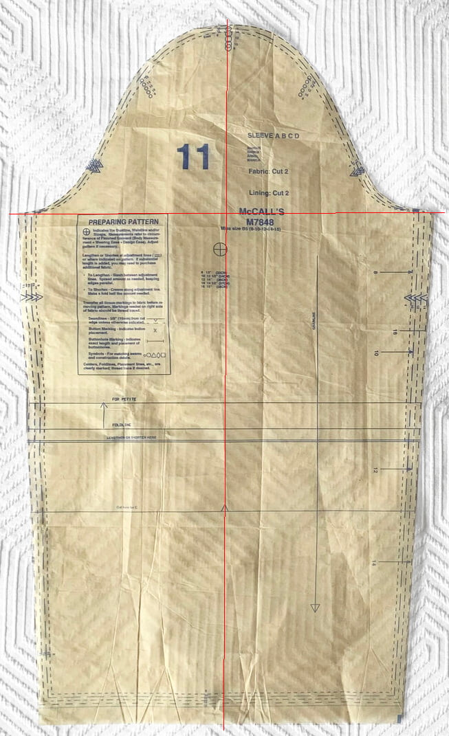

That would be my suggestion for now. The probem though is that in many cases simply aligning by top, biotton, left, right, or center is not where you would want to align a group of nested pieces, @Grace and I have discussed this, and what we need is a way to designate an origin point for a piece, so that the pieces can be aligned according to the origin point. For ex: Take the following sleeve…it’s aligned by the red cross lines - which is neither by the top, bottom, left, right, not center.

I see what you mean :thinking:
Defining your own point would indeed be very useful.
But as your exemple goes,can’t you keep the construction lines when exporting to .svg ?
In Inkscape, and I guess the same applies for Illustrator, you can move the object’s center point wherever you want. You might have to do this for every objects before nesting them, but still.
Here, you could still nest properly the pieces aligning them on one of the sleeve points on the horizontal red line, then distribute the pieces on a vertical axis.
But, yes, I get that being able to define an origin point directly when drafting would be of great help.
