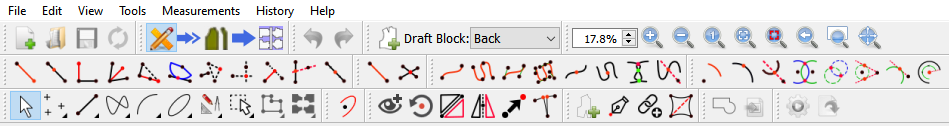

Here’s a look at the menus & toolbars:

One of the new toolbars is the Toolbox toolbar… which mirrors the Toolbox dock and Tools menu. You can have access to all the tools in a much smaller space than the Toolbox dock. You can place it in any of the 4 dock locations. The rest of the Toolbars should be self explanatory… each one represent one of the tool groups and you can configure the UI for which ever ones you want visible.
toolbox_toolbar
Last visible update is the improvement of the Status toolbar and tooltips. The cursor position is now explicitly shown as XPos, YPos with a 2 decimal places of accuracy. The tooltip will now display the Tool: < tool group > - < tool > followed by instructions.
