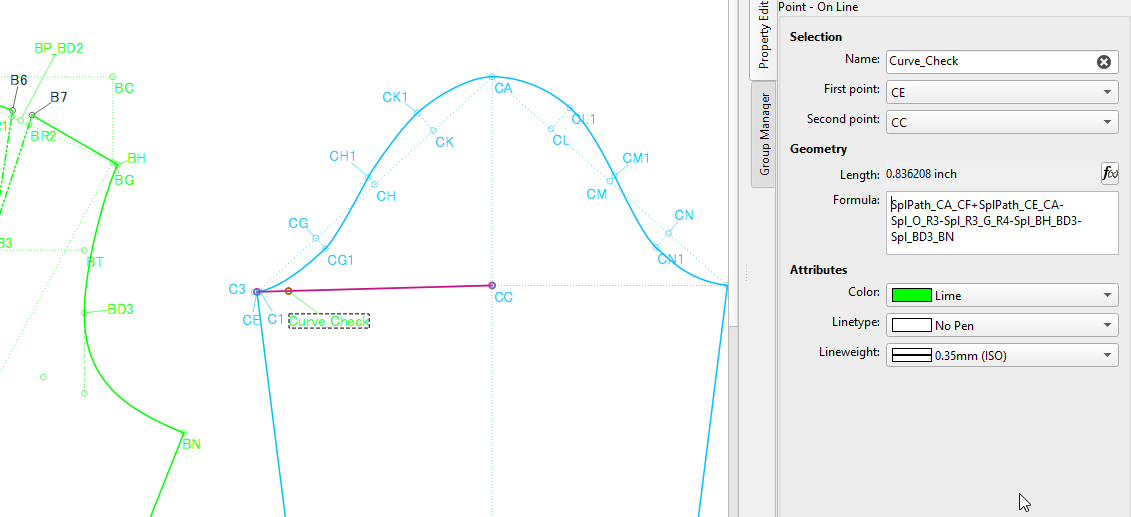

I’m a long-time user of Seamly and I understand your logic, however, I don’t have any control over new features and programming of the software. With that said, I have a bit of a work-around that shows me exactly where things don’t balance which works very well for myself and a number of uses who have learnt to do the same…
For instance, in the image below, I have a Curve Check where I deduct all of the added up all the curves of the armholes from the sleeve cap curve to make sure that the difference is acceptable for easing the sleeve into the armhole.
I place similar checks all over, like with the bodice side seams, the waist of a skirt to the waist of the bodice, trouser side and inseams.
If named appropriately and the formulas are correct, you can see at a glance if the area that you are working on matches the area that it will be attached to during the sewing process, and if you use the measurements in SeamlyME to create the formulas at the correct places, there shouldn’t be a fitting problem.
I hope that this will help you while someone hits on a bright idea on how this can be incorporated into the software.

Like I said we all have used some variation of this to create 2 lines made of of the sum of the lengths you want to compare.
This is what is commonly referred to as “Walking the pattern”.
I’ve proposed ideas in the past… which given my increased knowledge of Qt and the codebase may have changed my thoughts since , but I see replacing having to draw 2 lines with a formula to sum up the length with a Dock where you can add to a list of comparisons. The comparisons would be simple… there would be 2 vectors (paths) of points & curves (like in the Pattern Piece → main path) where the app calculates the length of each path segment, compares the 2, and displays the difference. So just like tracing a path for a pattern piece, you would trace 2 paths… or “Walk the pattern”. An option could be to add a limit to the difference so the display changes to indicate if the difference is withing tolerance. Maybe the difference value is displayed in Red?
Of course that’s just the basic concept… all the UI and details would have to be worked out.
