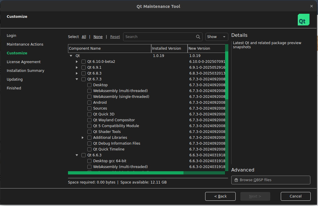

What are the essential components other than the Desktop one? Qt5 Compatibiliy mode?
Thanks in advance!
Fidel H Viegas

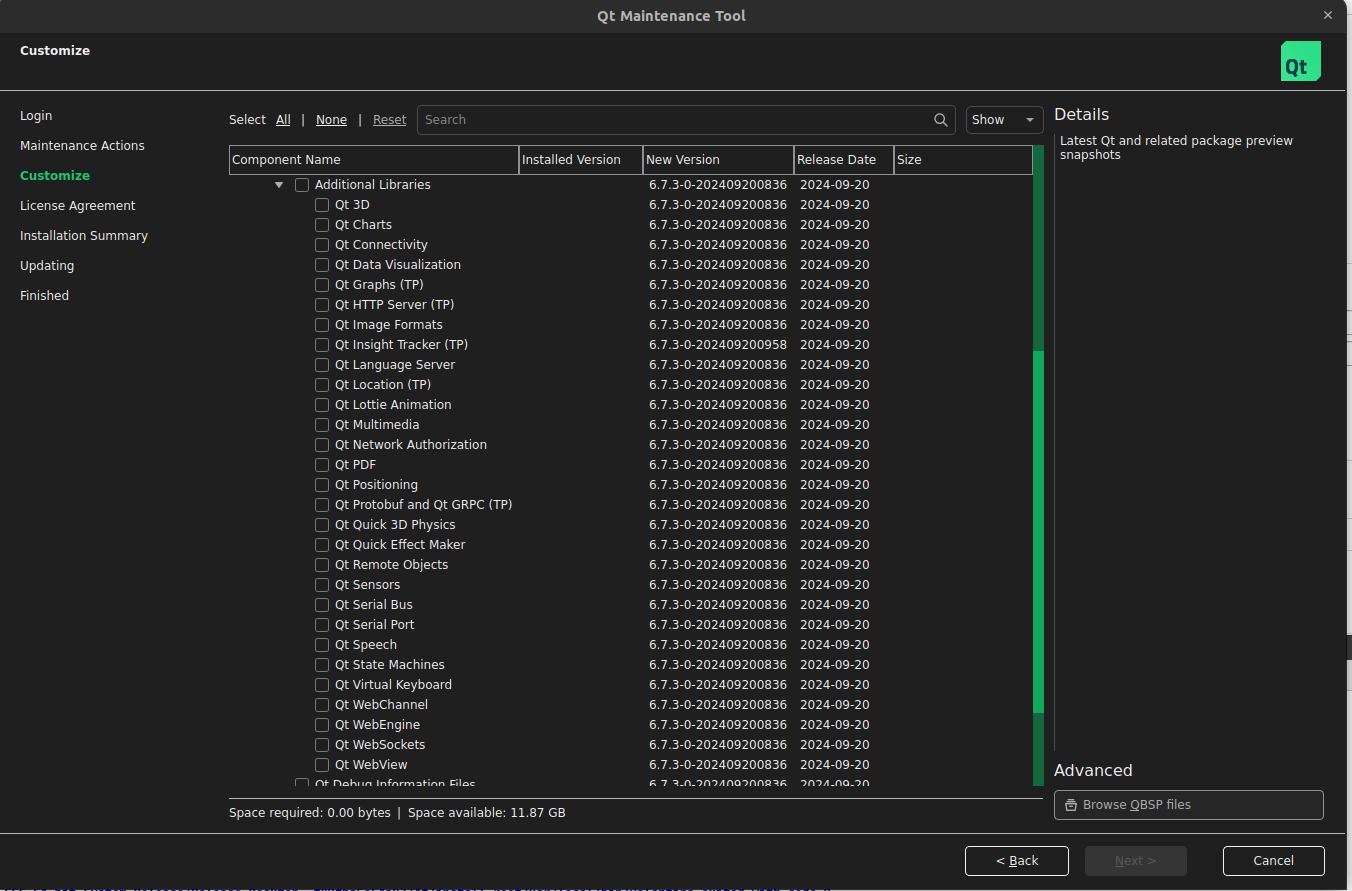

Don’t know for sure… can’t see the list of the Additional Libraries. But yes… other than the Desktop, Qt5 compat module, and the whatever in the Additional Libraries you don’t need any of the other stuff… especially the Souces code as that’s huge. Possibly might need the Debug information to run a debugger in Cretator.
Sorry! I missed that Additional Libriares part. Here it is:
Thanks once again!
