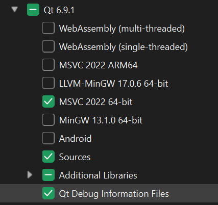

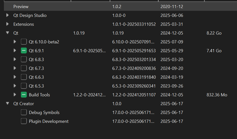

I’ll try to answer for Windows, MSVC 2022 and Qt 6.9.1, but it should help you find the minimal configuration for Linux as well :blush:.
I think you should need nothing from “Qt Design Studio”, nothing from “Extensions” and nothing from “Qt Creator”. (If I’m not wrong the “Debug Symbols” in the “Qt Creator” section are to debug Qt Creator itself, not the softwares that you develop with it).
From the “Qt X.X.X” section you would need components for your compiler, as well as the “Sources” (it will help you get more information about the Qt functions, variables etc.) and the “Qt Debug Information Files”:
From “Additional Libraries”, I think we use only 3 of them:
  • Qt 5 Compatibility module
  • Qt Multimedia
  • Qt Shader Tools
And from the “Build Tools” you may want those 3:
If you chose MSVC, you would have to DDL MSVC separately from their official website, if you selected MinGW, you could check one of the “MinGW” to install it directly from the Qt Maintenance Tool.
Please tell me if I’ve forgotten sthg, that way I can update my post for future developers :wink:

That would seem to make sense. I would note that if @fidelhviegas starts with the minimum, he could always add any other components at a later time. The debug symbols are probably the last thing one needs to get the project to compile. :slight_smile:
Don’t really need the sources unless you plan on compiling Qt. If you need to look at a specific Qt class source just Google it. I’ve got 3 MINIMAL Qt’s installed with NO source files… there’s nearly 3/4 million files that take up 1/2 my laptop’s SSD. On the other hand you may want the Qt Docs… athough to be honest - even though I have the docs - it’s quicker to just Google a class than than dish through the HTML docs to look up a class.
Shader tools are not needed… unless you plan on game programming or using Qt Quick. Seamly is not a game and does not use Qt Quick. :slight_smile:

That’s what I thought. I will not fill my HD with unnecessary stuff. I rather look for the documentation online. As for the source code, I also don’t think I need it.
