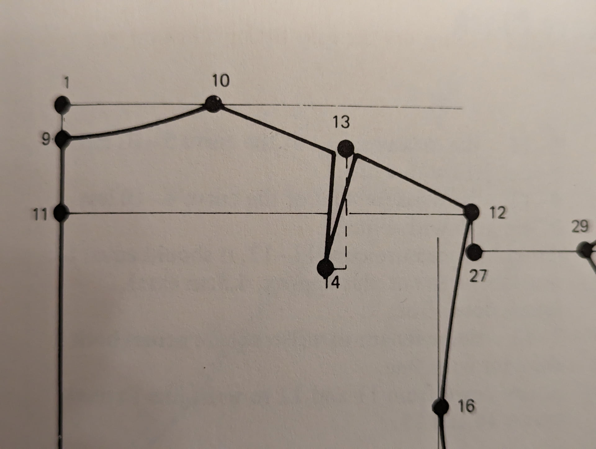

I’ve run into an obstacle with following the shoulder dart instructions, namely, where is the 1cm wide?
13 is the midpoint between 10 and 12
Is 14 5cm down from 13 and 1 cm towards centre back?, is that what instruction 13-14 is stating?
When it then states draw dart 1cm wide, is that 0.5cm either side of 13 (which then shifts the left side of the dart)
I.e. start drawing at a point 0.5cm from 13 towards 12 diagonally down to 14.
Then the other leg of the dart, which is to be the same length as the drawn leg, be drawn along a guideline from 14 through a point 0.5cm towards centre back from 13 (i.e. the other side of the first 0.5cm to make the 1cm wide)
But as that leg will be same length it will then form the top of the dart to be connected to 10?
Have I overcomplicated my reading of this? It seems the more I look at it the more I’m not sure how the placement of the right and left leg angles and lengths have been arrived at.

I think the thing to do is realize the intent - which is to provide a dart for shaping over the shoulder blade
Place it approximately mid shoulder and on a slight angle as shown. make it 1 cm wide in total and 5 cm long and yes you must make the dart legs the same length.
Use the dart leg length on the left as your measurement to match for the other leg of the dart.
4 Me gusta
Yes. Then the dart fold line is 14 to 13. The dart is 1cm wide at 13. Since the dart will not be perpendicular to the shoulder seam you would need to true up the dart so each dart leg is the same length as @Ttailor aluded to.
