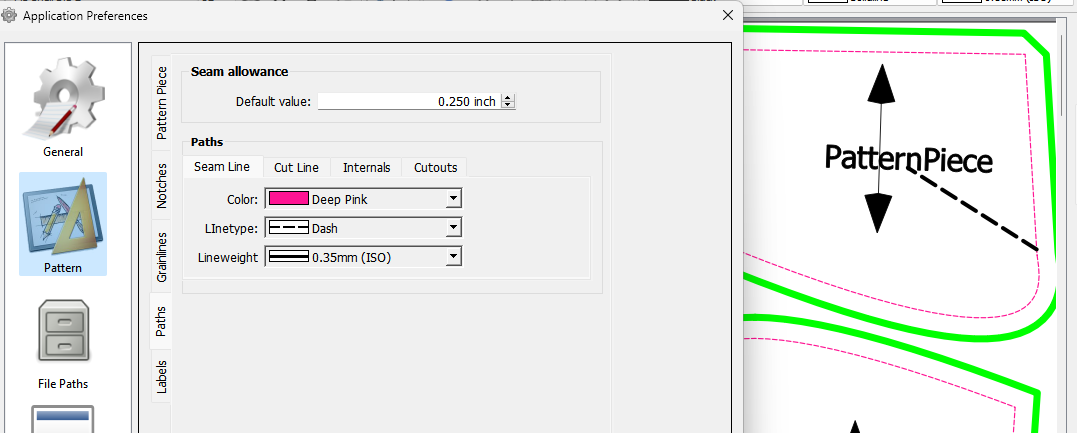

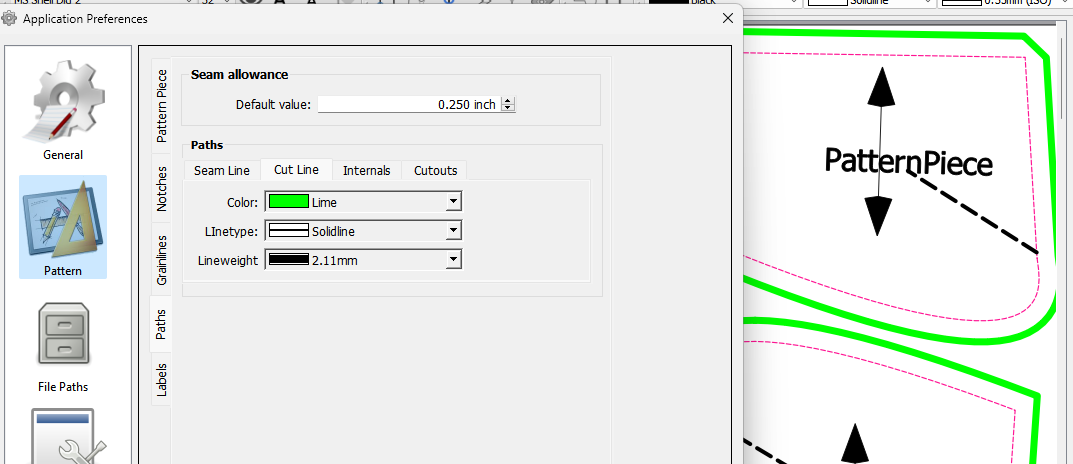

The Lines in Piece and Layout mode are determined by the Pens set in the Preferences->Pattern-Paths
