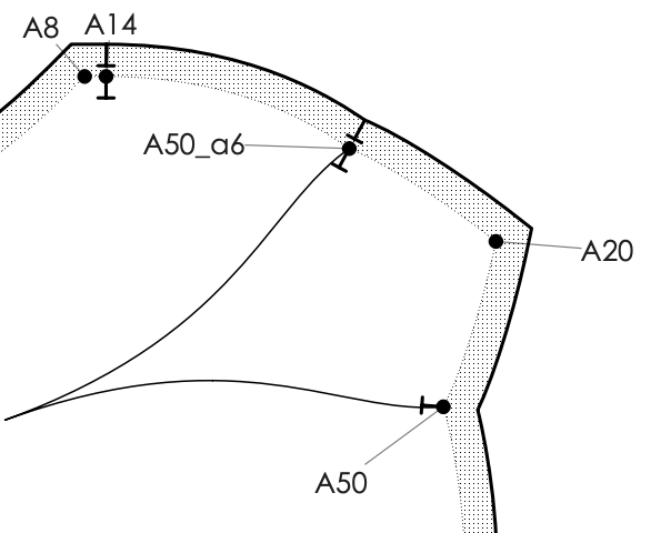

Notch angle at dart
is there a way to change the notch angle so it works with a dart?
for example at 50_a6?

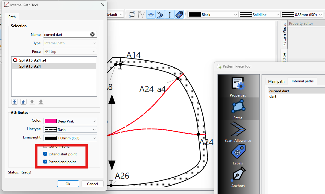

There’s a better solution… don’t use the notches here, extend the internal path to the cut line instead.
thank you that’s a great feature!
