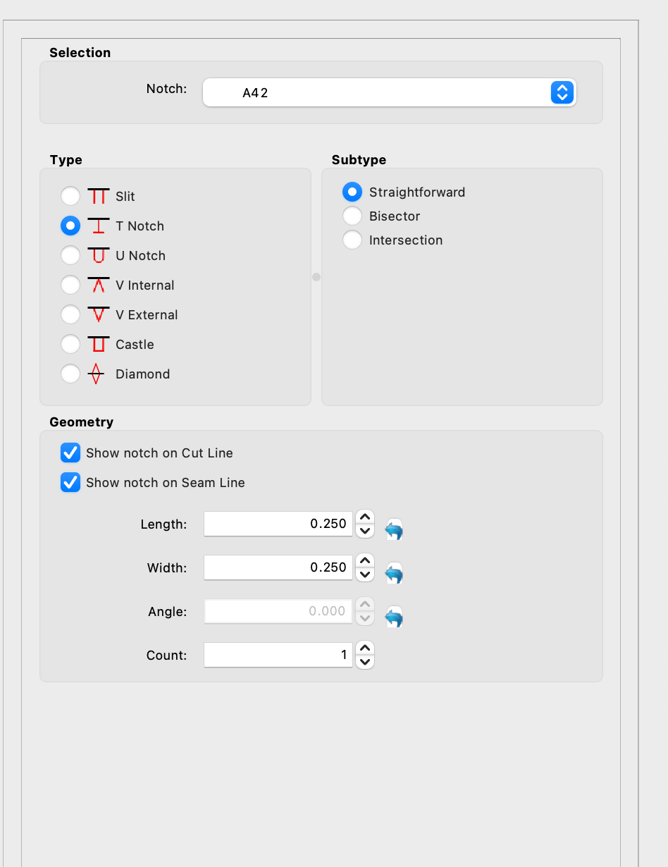

I can’t seem to change the notch angle. It’s grayed out when T Notch is selected. Only works on slit notch. Also apply button doesn’t work, you have to select ok to see the change. Is there a fix for this?
You have to set the node point in the Main Path as a Notch. You can define the Type and Subtype in the Main Path list, or define them later.
Open the Paths to the Main Path. Using the right mouser context menu you can set the Type and Subtype.

Once a node point is set as a notch. it will show in the combobox drop down and be editable.
i think it’s already set to a notch.

You can only set the angle on a Slit notch. The other notch types created too many anomolies in painting them on screen so I limited it to just the Slit.

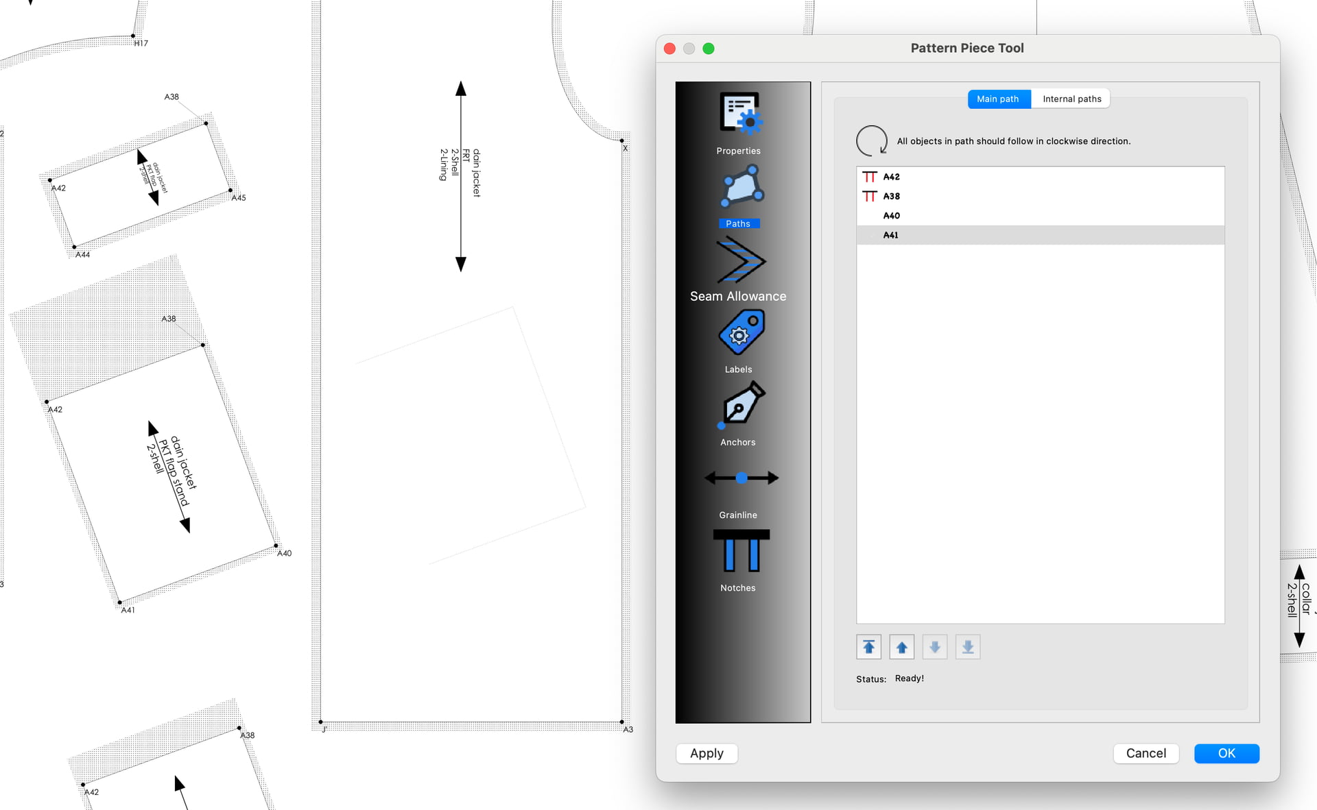

i’m trying to notch a pkt flap. when i use a t notch it shows it 45 degree to the corner.
at point A38 and A42.

That’s the behavior at a corner… where the Straightforward subtype will act as like the Bisector.
Screenshot 2024-02-28 220404
This is because determining which leg the notch projects perpendicular? In a square corner the notch won’t show at all as it lines on the cut / seam lines unless it’s a Bisector. Probably the dialog code should be updated so that in the case of a corner the straight forward option should be disabled and switched to Bisector.
Except corners are not generally notched like that… they usally marked showing the intersection - which has to have the Show notch on Cut line selected. Actually in this instance it’s more of a seam allowance width indicator, rather than match this notch to this notch along a seam.
