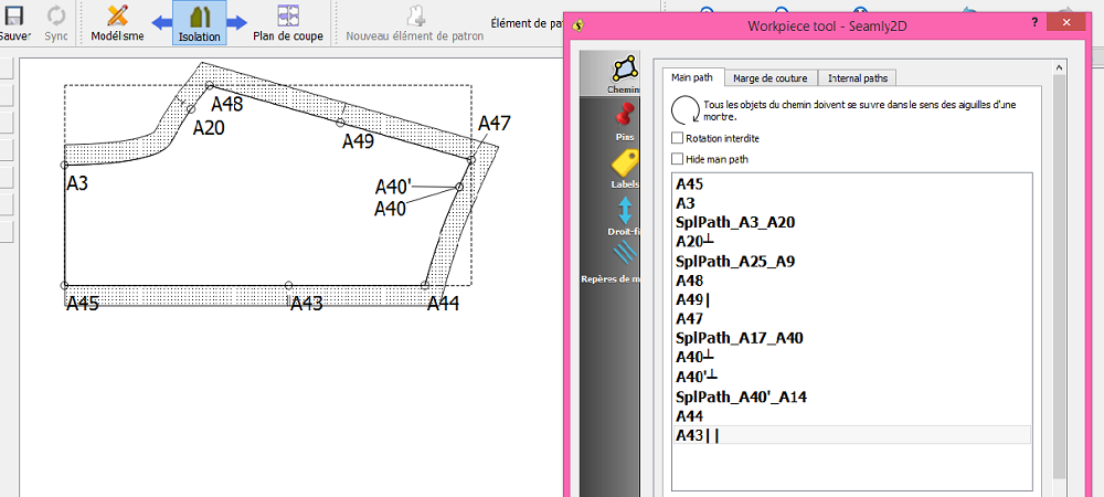

Sorry to ask again for something that is maybe simple but I try to put a notch on 2 connected pieces. But the dot number is not the same and I don’t manage to see the notch.
I would like to put the notch on point A40 / A40’ …
Could you please help me … (sorry in advance for my english … i’m french …)

I think you should only place the notch at A40 or A40’, not both.
I quickly joined 2 random pieces of pattern in mine, placed a notch at E31 and got a very weird result because the pieces don’t match in size:
So I guess it would be best to post your .val and .vit files, please.

I think I had the same problem and the solution is to delete/exclude one of the points from the joined piece
