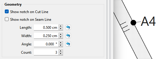

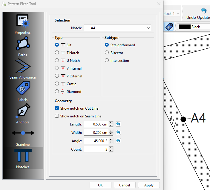

As far as setting the angle… that option is only available with a slit notch:
That being said the default should be 0 degs, which is perpendicular to the cut & seam lines.
