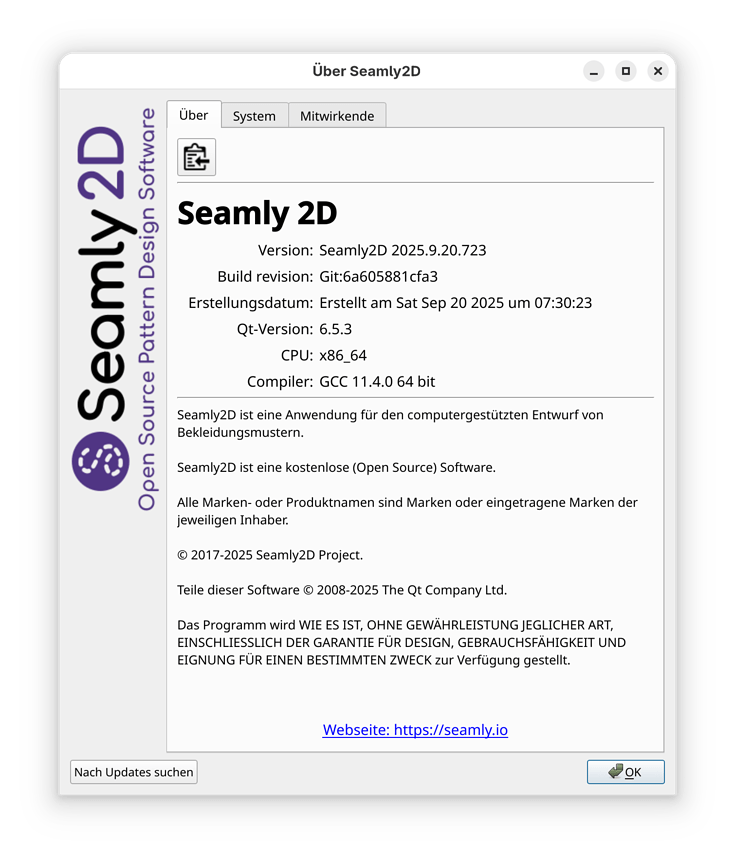

I’m using the latest Seamly2D Build on Fedora-Linux per AppImage. Opening old files seems to me modefified directly without asking me to save.
Before opening the last modification date of the file was in the past. After opening the file and closing Seamly2D without explit saving the file, the modification date changed to now.
Am I doing something wrong? Maybe it’s my missing Linux skills?! Or maybe Semaly seems to do something odd.
