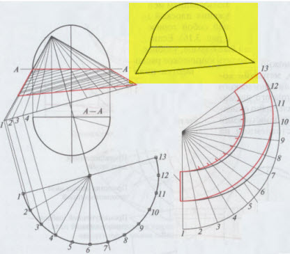

I have made hats for years and years using an old Soviet/Russian mathematical method (I have no idea what it is called), essentially by drawing side, front and top views of the hat in scale and then cutting them into little squares on a grid and flattening them, much like you do in sheetmetal drafting.

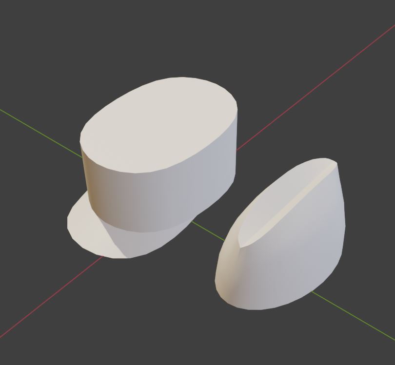

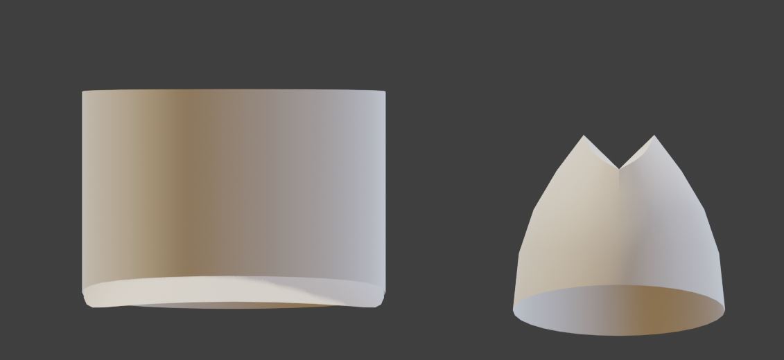

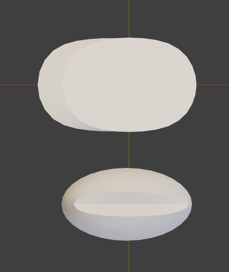

Here’s a few screenshots I took out of Blender of the hats that I roughly modeled just for illustration purposes.
Since the head oval isn’t a perfect oval and the cylinder itself in the military hat is “leaning forward”, you can’t just make the side panels just with two curves, the radius is slightly smaller in the “corners” of the ovals.

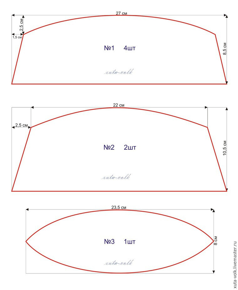

as @Grace said, draw a pattern not just a model.

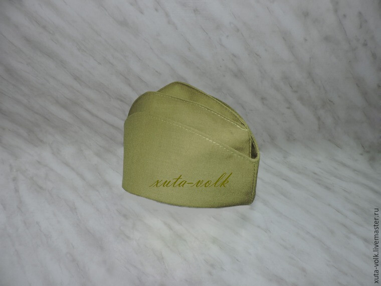

You can take one of the many that exist:
https://www.livemaster.ru/topic/1787153-masterclass-shem-pilotku-k-9-maya?&inside=0&wf=
What you need is only the circumference of the head at the point where the cap sits on the head. Such caps were basically a flat type of garment, that means when they are off the head we can fold them into a flat piece. What gives them the round shape is the shape of the the head.
Height is connected to the circumference. Second piece is i.e. x1,25 high. I guess you need to play a little with the third piece to define a curve that scale nicely.
There are many variations on this type of cap.. like the Scottish Glengarry or the military “side cap” known in the US as a “garrison” hat, 'wedge" cap in Canada, or “field service” cap in the UK.

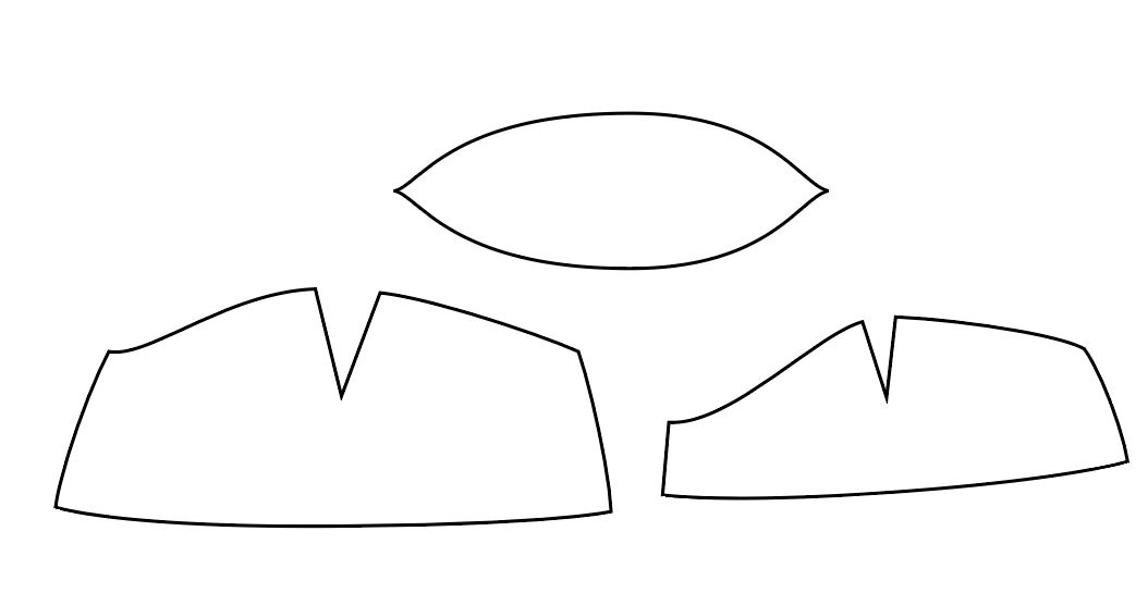

For example, here’s (another) quick and dirty - not to scale - version of a postmans sidecap from early 1920’s I made for a film production. The notches add to the excitement of getting the pattern correct…. :slight_smile:

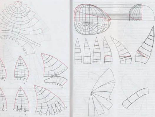

While I was doing some rough tests, I think I’ll be having problems with having to do all this “backwards” as compared to my usual method. With parametric measurements, I have to start from the end result as a flat pattern and then try to figure out the mathematics of it in 3D space. Usually I just draw the hat in 3D (well, 2D but as complete hats to measure) and go from there.
This blog is probably the ongly English website that I’ve ever sene touch on the method I use for hat drafting, so that may explain where I am coming from when it comes to drafting hats by hand.
This image shows the 2D drawing of the hat on the right page, with the “grid lines” from which the side panels etc. are then derived from for the flat pattern. Requires a bit of trigonometry and it’s pretty time consuming as you kinda end up having to manually draft each size, unless you create a ruleset for grading.
But then none of the different versions (post offices, prison, customs etc. etc.) have exactly the same shape and there’s differences in details, so if making a number of different hats in different sizes, you end up having to do A LOT OF trigonometry and manual work.
