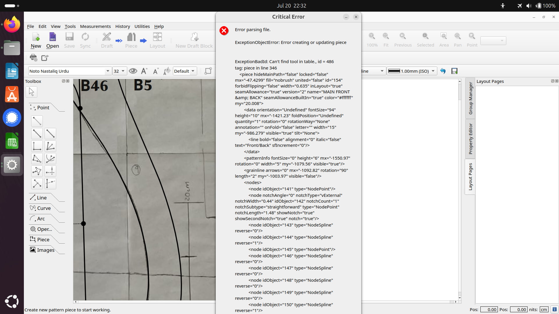

Hello! While I was working on my guitar case pattern, a parsing error randomly stopped me from accessing my last save. I tried hard to fix it on text editor but sadly I can’t figure out where is the error exactly. If I could have some pointers on how to fix it would be greatly, greatly appreciated! Or if I can send my last save from Seamly2d for someone to amend for me, that would be amazing. I don’t mind losing some parts if need be. Oh and this is what the error said (It doesn’t let me attach a screenshot)
Error parsing file.
ExceptionObjectError: Error creating or updating piece
ExceptionBadId: Can’t find tool in table., id = 486 tag: piece in line 346 <node idObject="15

Thank you, that is kind of you to have a look Douglas. Sorry I can’t remember what I last pressed! Also it requires no measurement file. Here is my latest save: Guitar case.sm2d (95.4 KB) and the error which came with it:
Thank you, so kind of you to have a look. No measurement files were required so here is my latest save: Guitar case.sm2d (95.4 KB) and my error pop-up:
