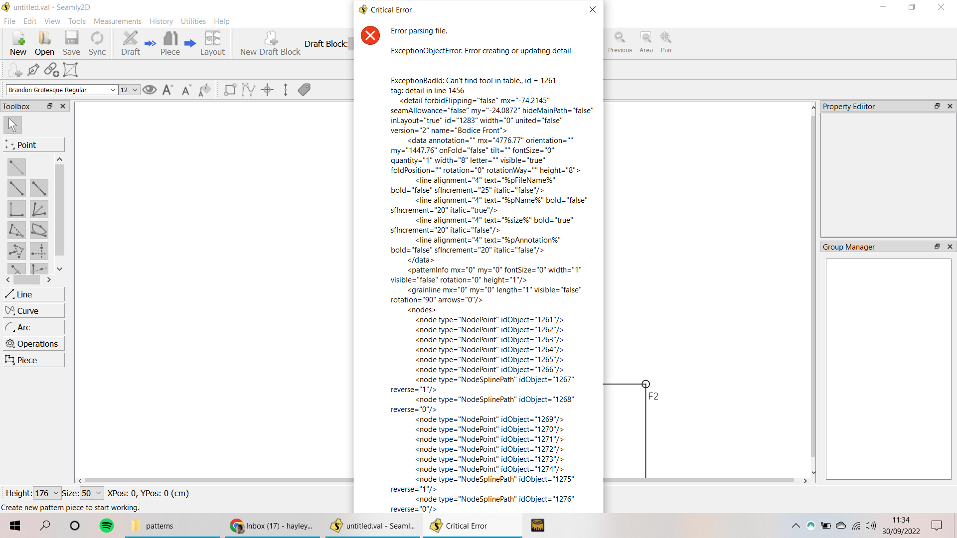

Okay, so I’ve just tried to open the files again and it’s now not letting me open either of the ones I just posted above! I could cry, I spent so much time on this pattern but it just seems to be corrupting each version one by one! This is the message I’m getting:
Does this mean there’s no way back and I have to start all over again?

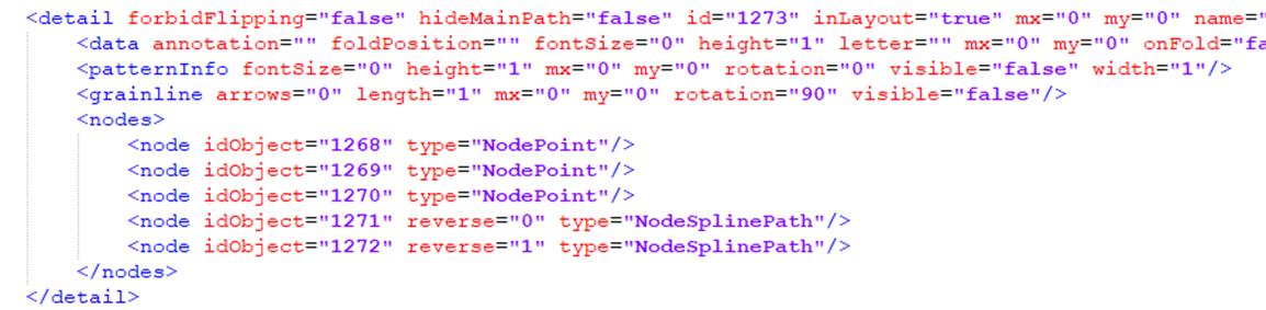

Once again, I get errors in opening this pattern, so I decided to check why your pattern pieces are causing a problem each time the pattern is closed and reopened. While I was checking, I created a portion of a pattern and yes, it doesn’t resize in Piece Mode, but I think it’s related to what I found with the Critical Error of the pattern piece which I’ll report here because I suspect it’s a bug in the program.

Every time a pattern piece is created and the program is closed, it gives critical errors on opening.

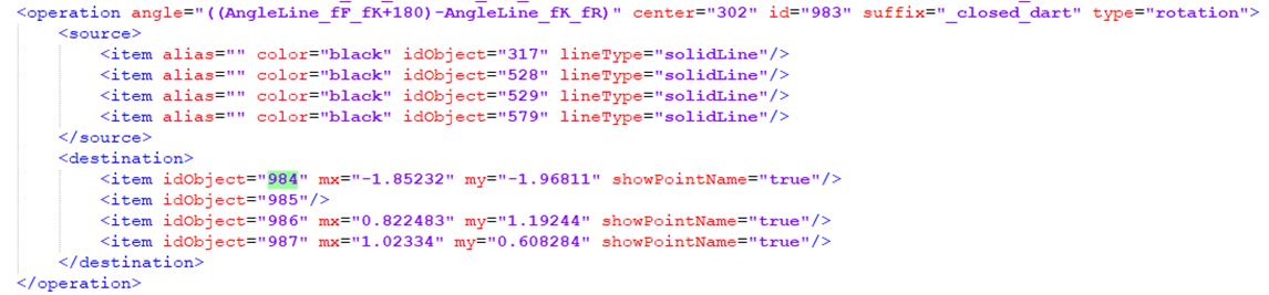

I put a portion of the front skirt into a group so that I could identify the object ID’s, and then I created a pattern piece using only those objects. And have found that the ID’s in the group and the ID’s in the details don’t correspond.
This is where object 984 was created:

So why do the object ID’s remain correct in the group, but it keeps changing them in Piece Mode? I’ve tried manually changing them, but this gives an error, too. And the incorrect ID numbers that are created are always numbers in sequence that haven’t been previously used.

There are 2 id’s… a tool id, and an object id. Sometimes they are the same, but not always. If memory serves correct the Group tool only uses the tool id. Also the Groups were shoehorned into the code, so they are parsed differently than the normal tools. Without getting into the weeds, the groups always parse from the Dom Document, where other tools are parsed, and added to the data container (by object Id)… so tools with an obj Id don’t always need to be reparsed all the time from the document, where groups do. Off the top of my head there could be discrepancy where the obj ids are not being updated like the group tool id’s are? Just a guess.
Also as a “Group” aside… do to the fact that the groups are constanly reparsing - which I noticed previously while running in debug mode where you can track debug msgs in the console output - things can start to slow down when lots of tools are grouped and there are lots of groups. I need to figure out how to reduce the group parsing - or refactor the Groups in more efficient fashion.
Thank you, @Douglas
I spent the whole 2 hours of loadshedding checking it out. I deleted the large groups and the offending pattern pieces.
What I have now found is… it’s not creating the “Modeling” for the new pattern piece where it converts the ID’s to Objects… Only the “Detail” - and this is why it’s creating the critical error and can’t find the Object ID’s.
