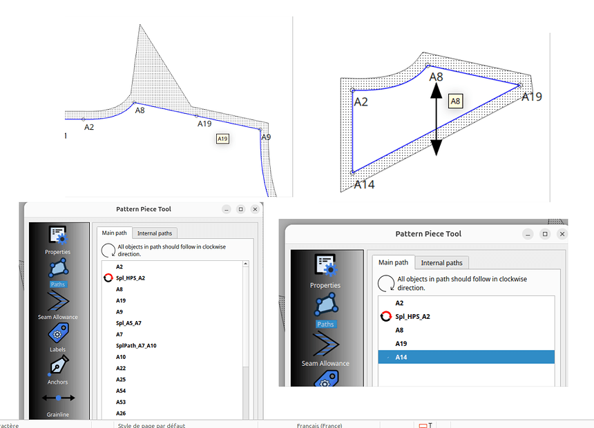

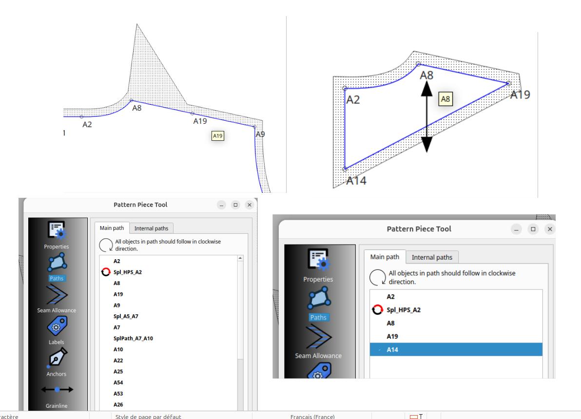

Hi All! I must have done something wrong but what? Can someone explain?
Saharienne mi-saison propre.sm2d (23,3 Ko)Hi All! I must have done something wrong but what? Can someone explain?

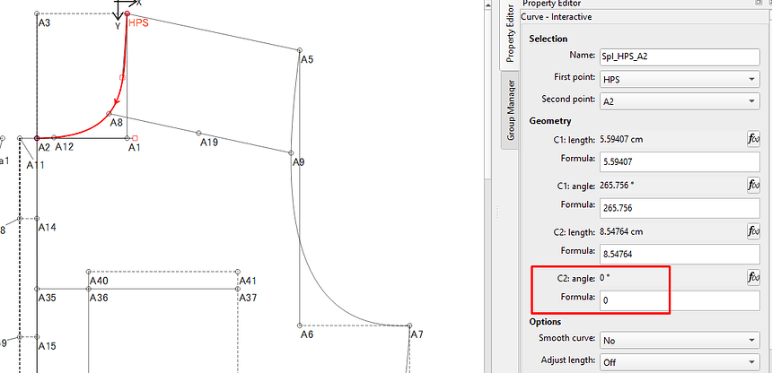

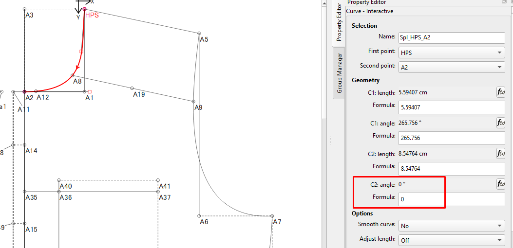

Hello, @bibgab
I changed the angle on the curve to be 0° at point A2:

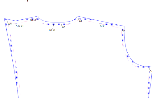

And look:
It seems that my OCD fixed it ![]()
