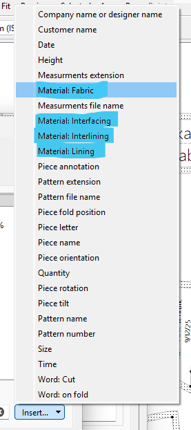

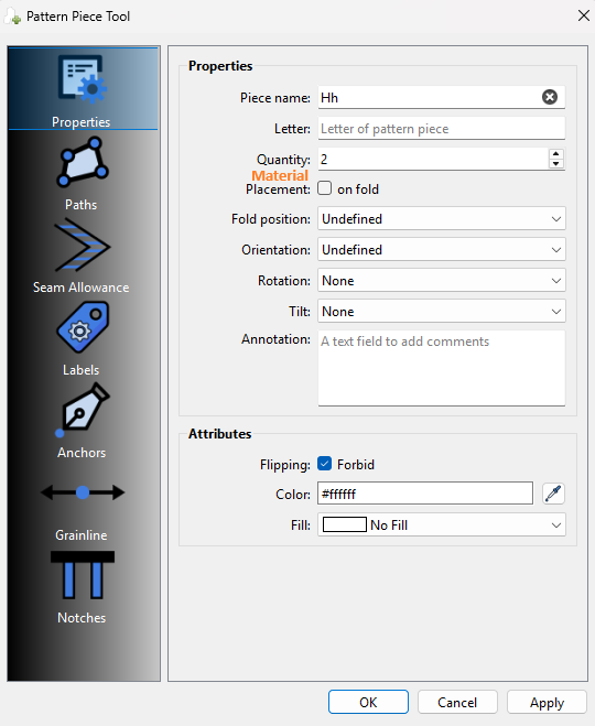

Hallo, Right now, the material has to be defined under ‘Edit Label Template’. Perhaps it would be possible to add a field called ‘material’ to the properties, with options such as ‘fold position’, etc. Then all the marked lines in the drop-down menu of the Edit Label Template could be one field. This would save a lot of time spent adjusting the default label for interfacing, interlining and pocketing.

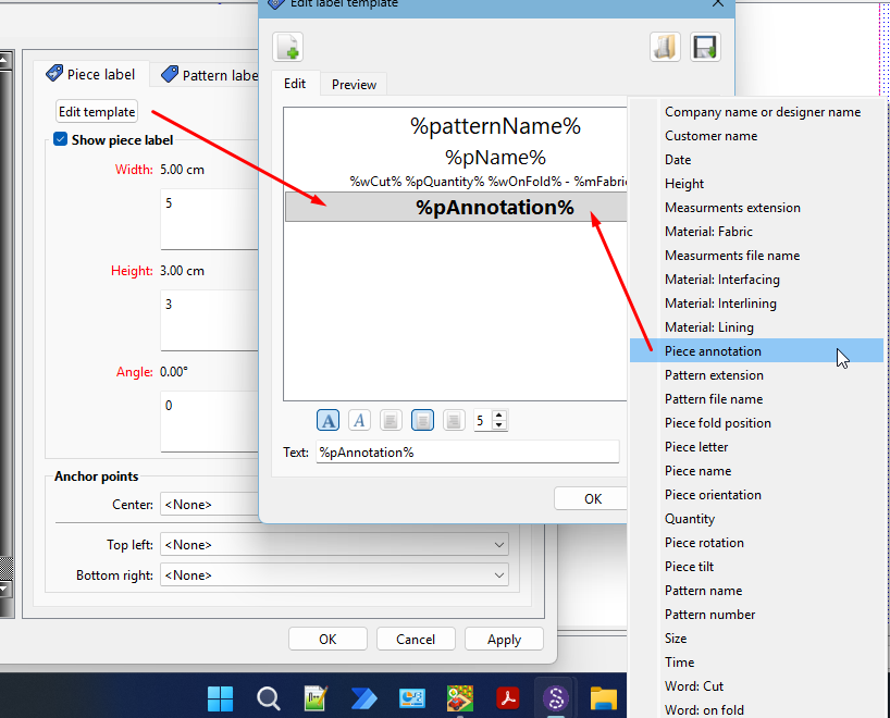

You can add piece annotations to the label, which you can define for each piece:

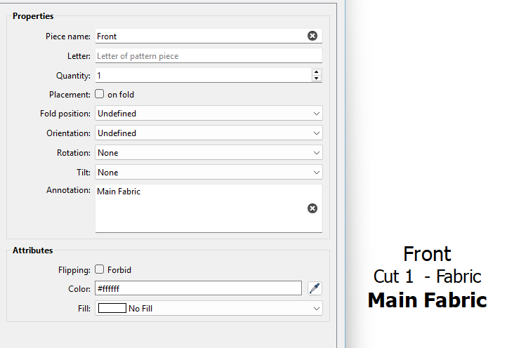

As you can see, I’ve added the Annotation to the Annotation box and referred to it in the label:
You can add anything to the Annotation box and it will print it on that pattern piece on the label.

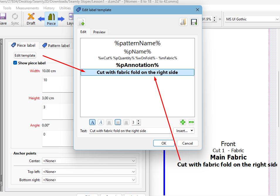

Or you may type in specific instructions directly into the label:
