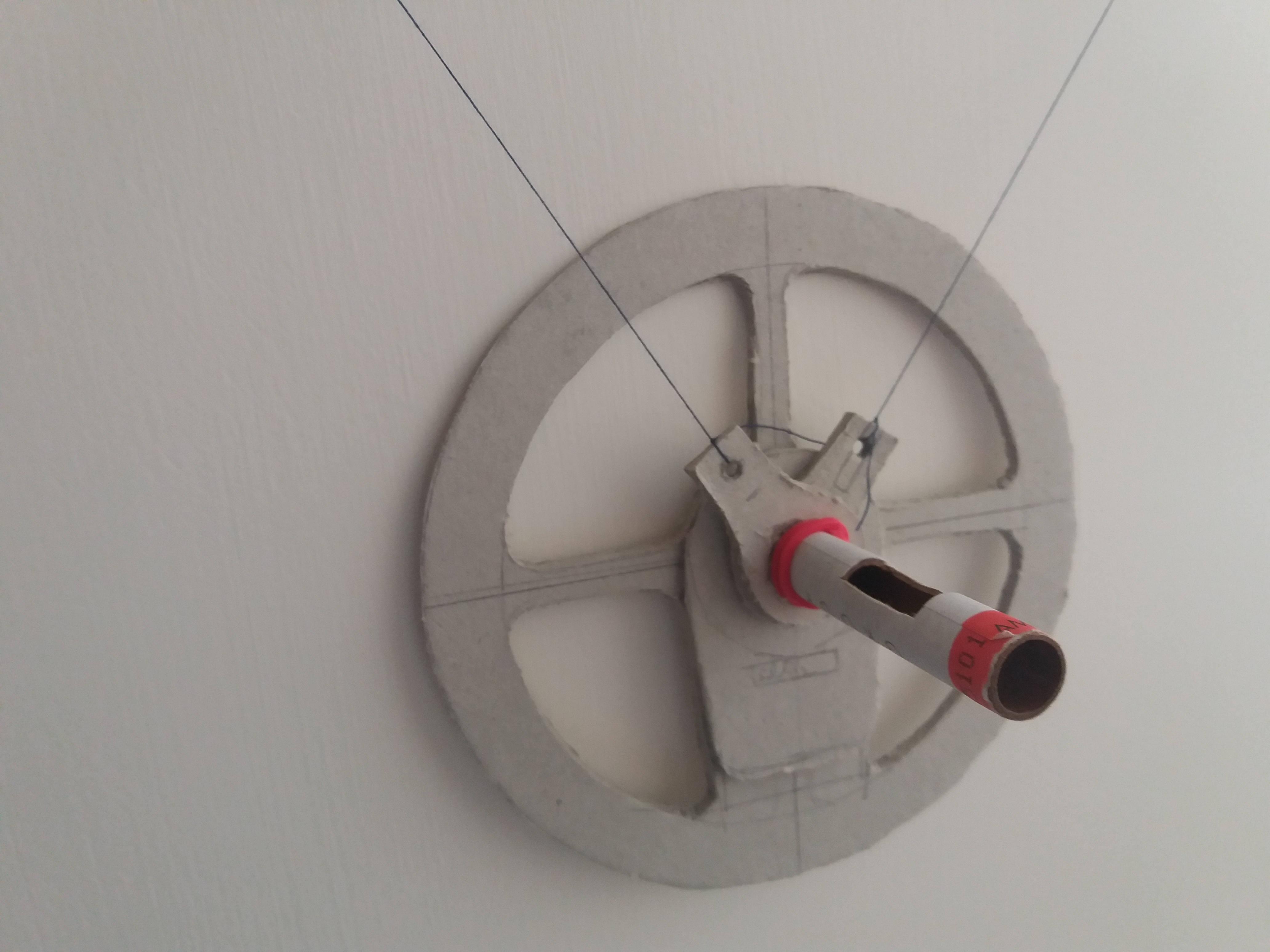

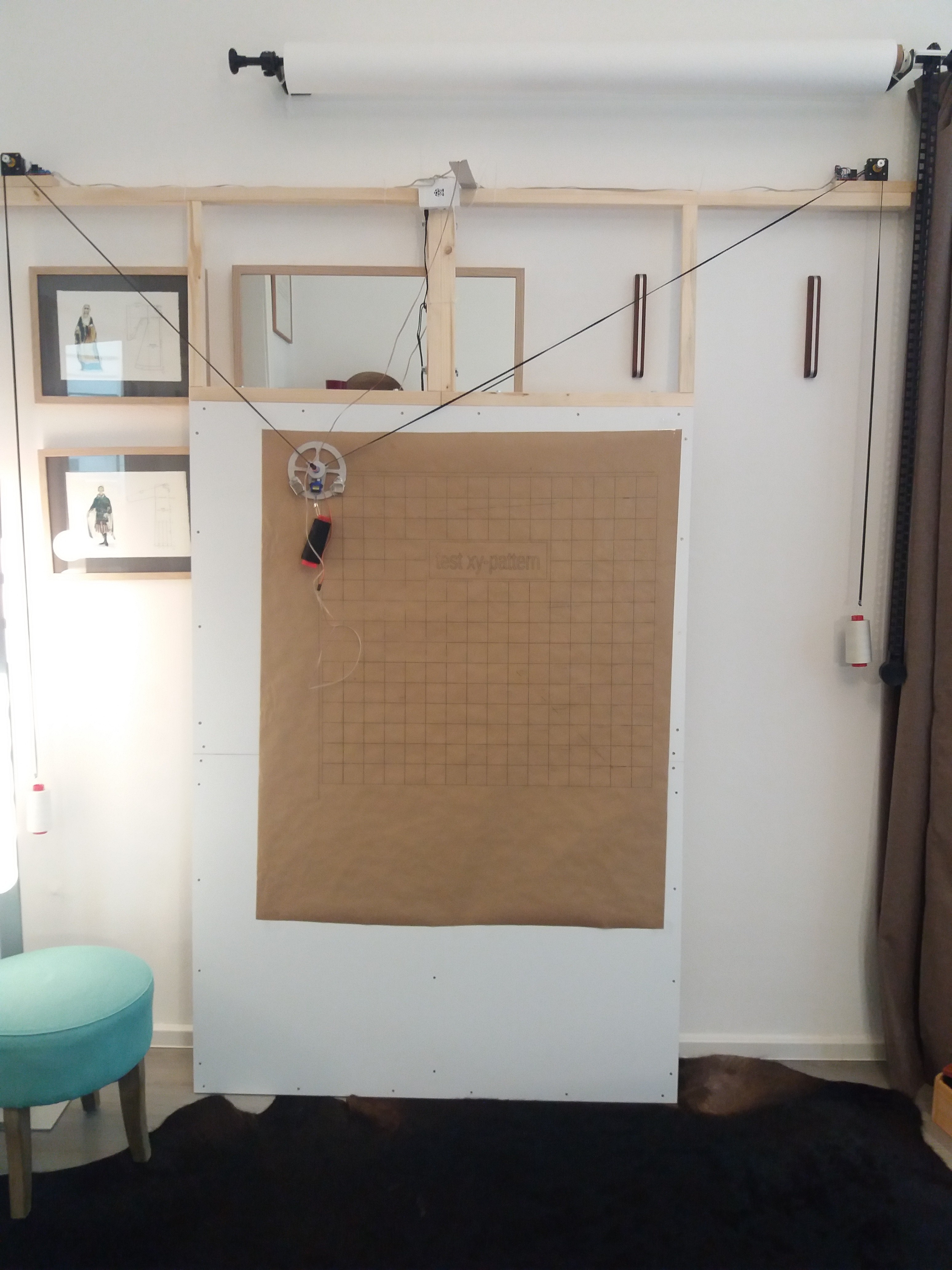

Hi there, I am working on a hanging wall pattern plotter, build with a raspberry pi 3. I just wanted to show you the progress…
My video on Youtube: Pattern Polargraph, Youtube

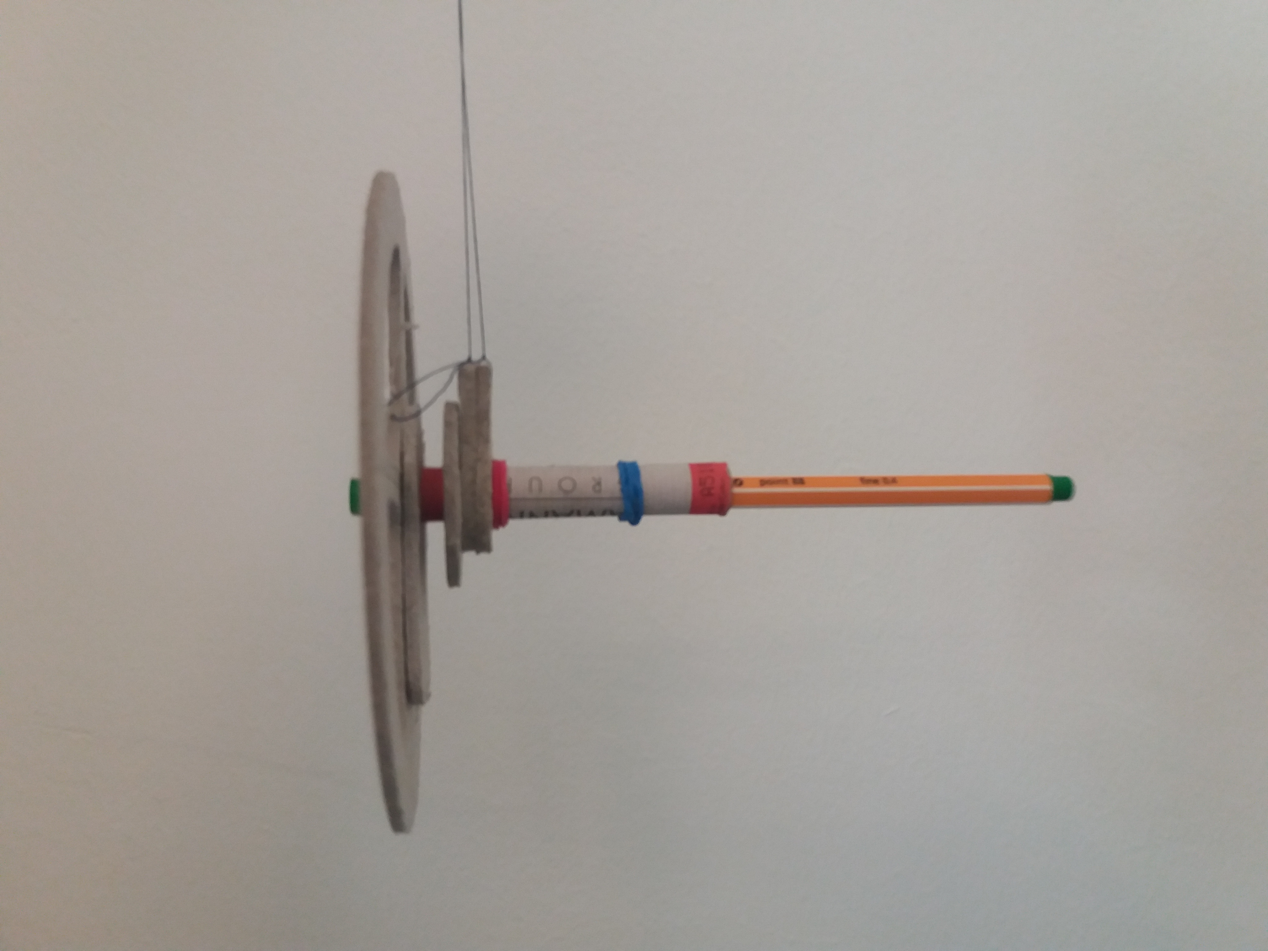

If there is anybody who can help me 3d building the gondel (that thing where the pen is placed) I would be very happy.

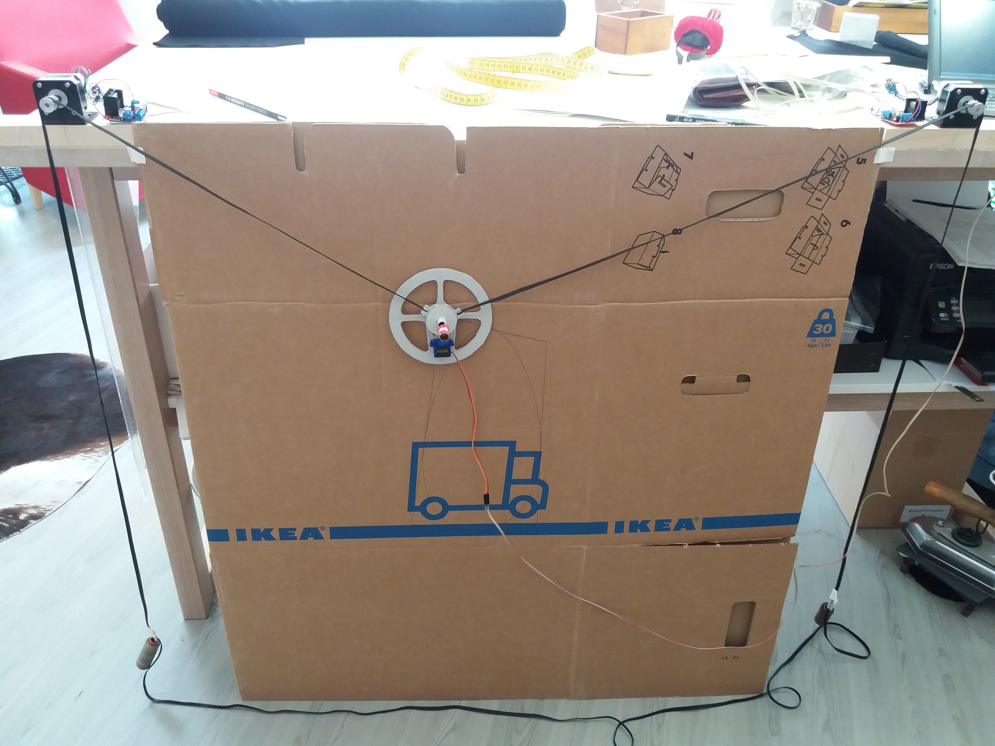

Do you know the mdrawbot from makeblock? http://www.makeblock.com/mdrawbot-kit/ This is a similar approach. Tried it out two years ago, but it did not work well, mainly due to the bad Software. Makeblock is not well into Open Source, especially not well into Linux.
Therefore this Kit ended in the cupboard after trying :confused:
If you manage to separate X/Y precisely and adapt it well so the printout will have precise dimensions, you are the hero!
I did build a smaller version of a look-a-like printer. The problem that maybe arrise with a printer of this size will be the precision of the lines.

Hi kirakira, no, I need it modeled, but I still have to do some more tests about the weight the gondel needs. But I Know where to 3d print it…

yes, I know the mdrawbot, but it works with cord, wich is imprecise when it winds up. Therfore I’ve chosen GT2 Belt. It’s not flexible and if the pen-holder is heavy enough it should work… I think 70 % depend on the hardware. (for accurade measurements)

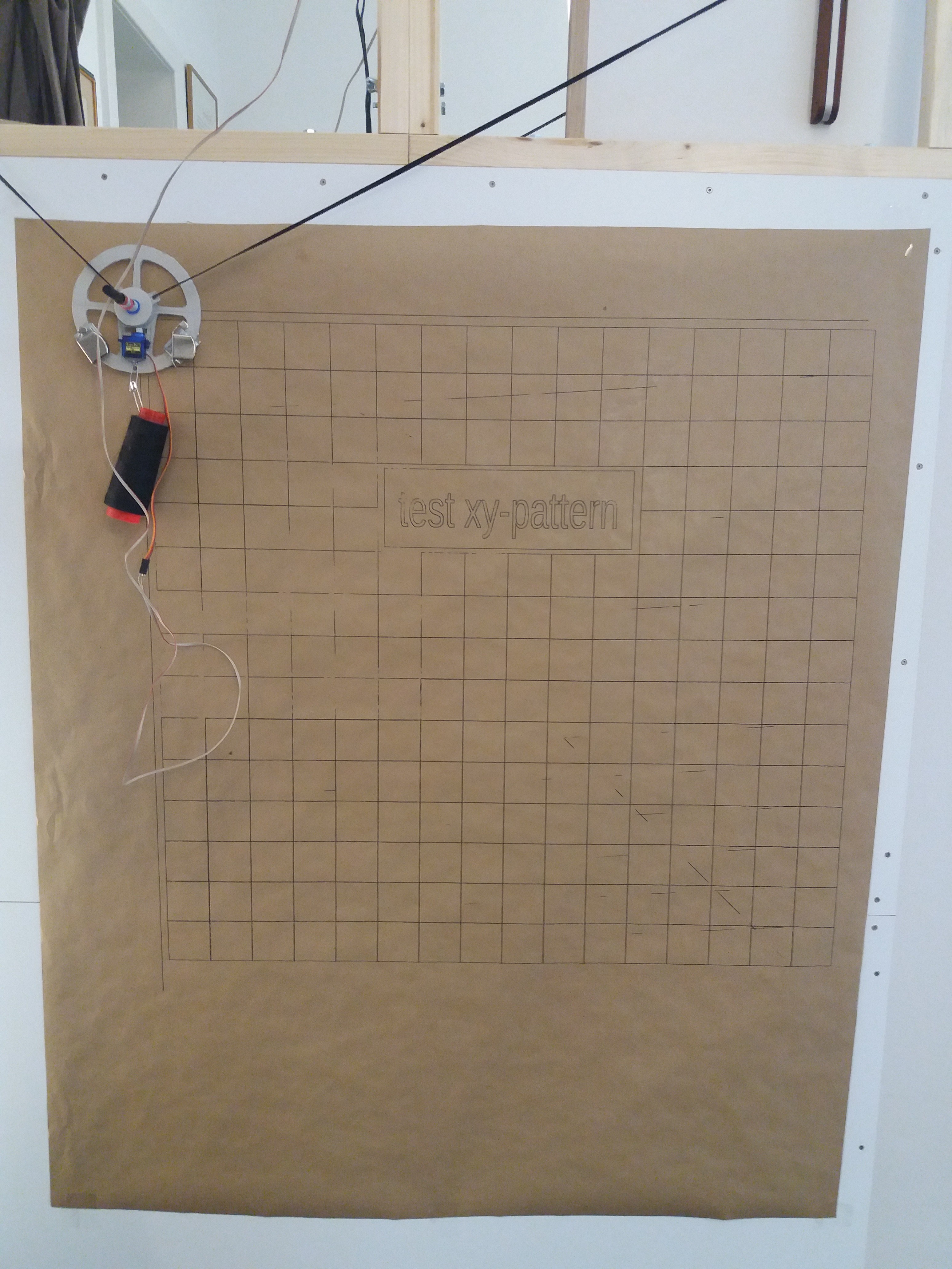

Now I have tested a bigger version of the polargraph, It’s almost perfect… The x axis now has just a inaccuracy of 0,75%, that’s 5mm on a meter. I have some ideas wich I have to test to solve this problem… But all lines are parallel and the angle is always 90°. So I think I’m on a good way

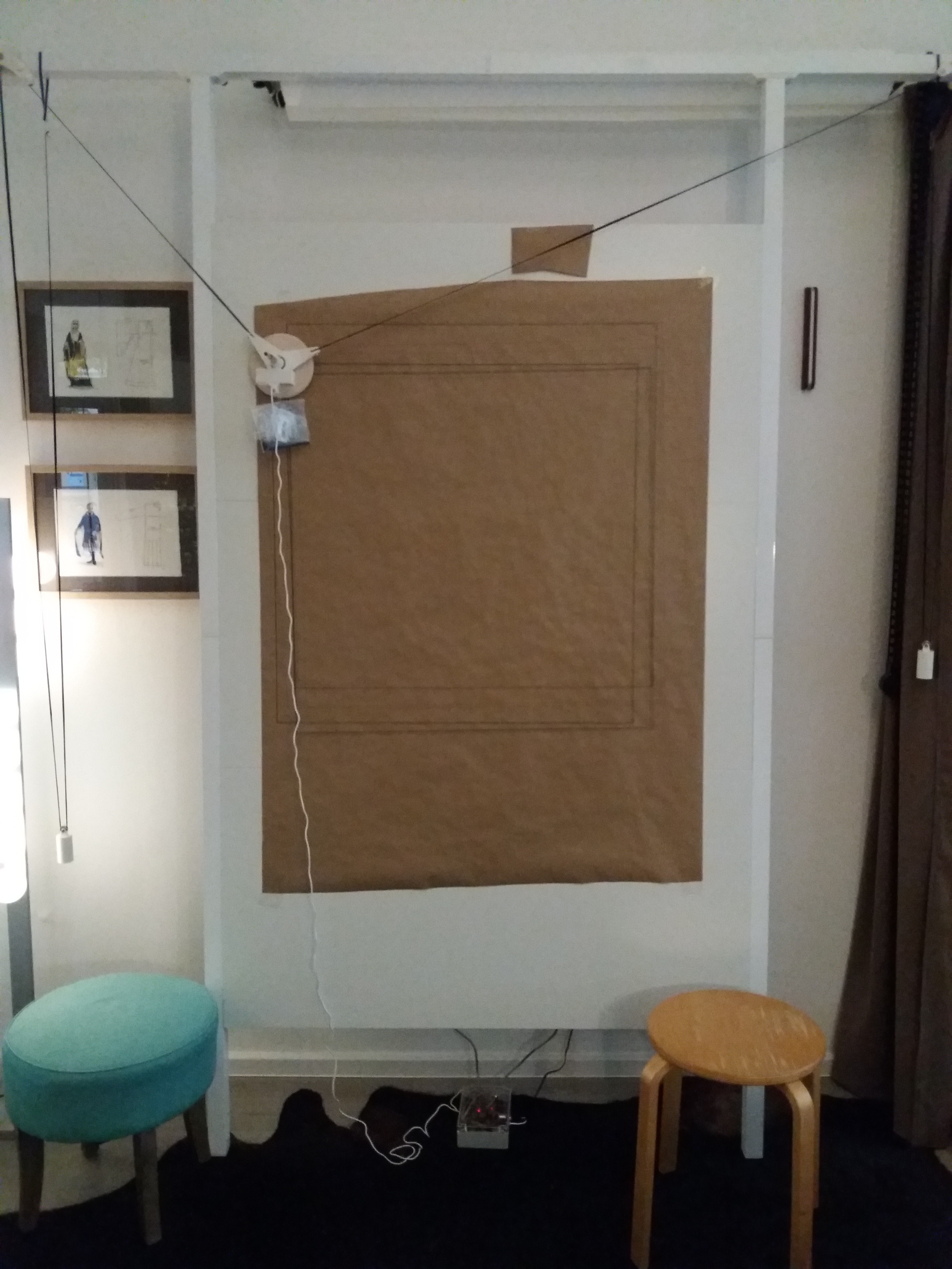

It took a while… here are some new pictures :slight_smile:
