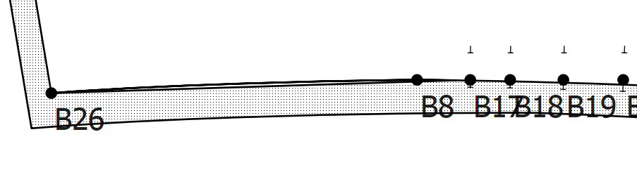

Ok, I’ve managed to delete just the sleeve and now it’s running normally again. I had a look at the order of the nodes & didn’t see anything out of order. I’m just going to undelete the piece :sob: and check if you didn’t select B26 as the start and the end node.
Yes I can see in the sleeve hem, a node is out of order… the path is back tracking. I’ll have to put this on the To Do list… see if there’s a way to avoid this, or at least figure out why the app is getting stuck in some loop while parsing a piece with nides oyt of order.
I’ve deleted the piece and all is running fine. I wonder if I accidentally moved the nodes around while working on seam allowances or notches. Either way, thank you both so much for your help. Crisis averted!
I can see a straight line between B26 and B17 that looks to be back tracking. Problem is it’s taking forever for the Piece Tool dialig to open.
Ok, @skinnerjeans. You’re very welcome and I’m glad we could help you & save most of your pattern pieces. I suggest that you drag the node labels out a bit longer so that one can clearly see the connecting line to the node. I’m wondering if B17 & 18 haven’t been switched around. (no this isn’t the case but strangely, when I switched them, the program sped up but the notches are still out of sinq). Because B26 is only at the end of the list of objects making up the path.
I dragged them out more. The only thing I see that’s odd is that B15 isn’t acutally along the curve, it’s on the line between B8 and B10. I had that as a notch along the wrist curve so maybe that threw things off?
Aaaahhh… yes, that will be it. I suggest that you create a node on the curve (call it B15a), insert it and position it at the correct place, delete the B15 & see if it speads up your pattern.
Perhaps the other 3 nodes are also on the line? If so, you’ll need to do all of them.
Ahh. That would do it.
BTW… not that it’s anything to do with this issue, as the app probably reversed the curve automatically. When it’s clear which direction a curve should be drafted, you should do so. So the curve should go clockwise B27 to B26. There’s a bit more overhead having to deal with curves that are reversed.
It looks like it’s just B15 that wasn’t on the curve. The draft instructions had me mark the sleeve placket slit before adding in the curve for a better sleeve transition, and I just missed the part where I’d need to mark the placket slit on the new curve. To be fair, this is from an old tailoring manual so they were expecting me to be using paper and not an awesome pattern drafting software!
I know better than that but I often forget in the heat of the moment when it’s 2am and I’m just trying to get this pattern submitted to the print shop before I go to bed :laughing:
Long Sleeve Shirt New.val (86.3 KB)
All of them are not on the curve. Here I’ve done the necessary and the pattern is working perfectly and the notches are on the stitch & cut lines.
