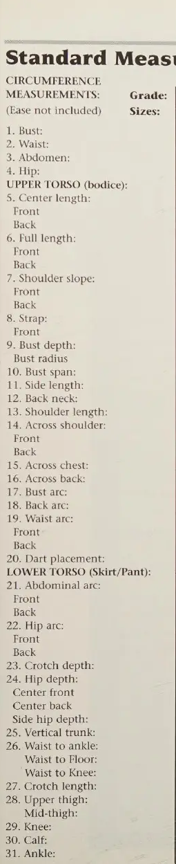

Hello, I am struggling matching HJAs measurement names and numbers in her book to the names and numbering in seamy M. Is there a template already available to use in seemly me? Or a reference chart to use please.
Welcome @JanetB,
Confirm that these are the required mesasurements for Arrmstrong and I’ll create a template for HJA.
