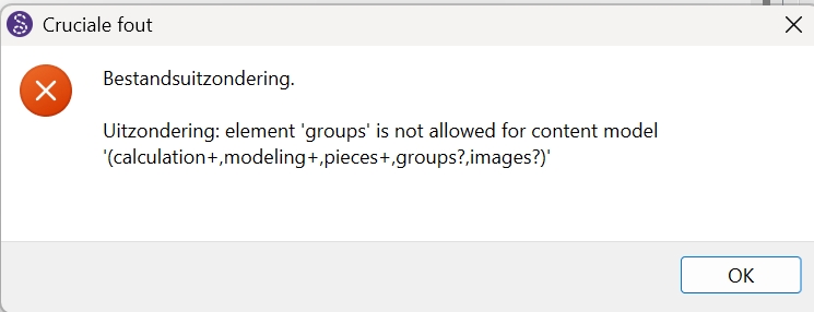

I have a sm2d file that suddenly throws an error

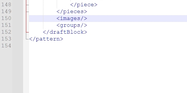

on opening the sm2d file I found a tag that doesn’t belong
I deleted line 151 ‘groups/’. And the file opened in seamly2d, i edited a bit, saved the file. The ‘groups/’ is there again, and the file fails to open.

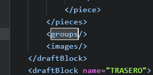

Change the order of the blocks < images > and < groups >… groups must come first.
Also male sure to be using a current version.
thanks, no new version found and wondering how that happened
