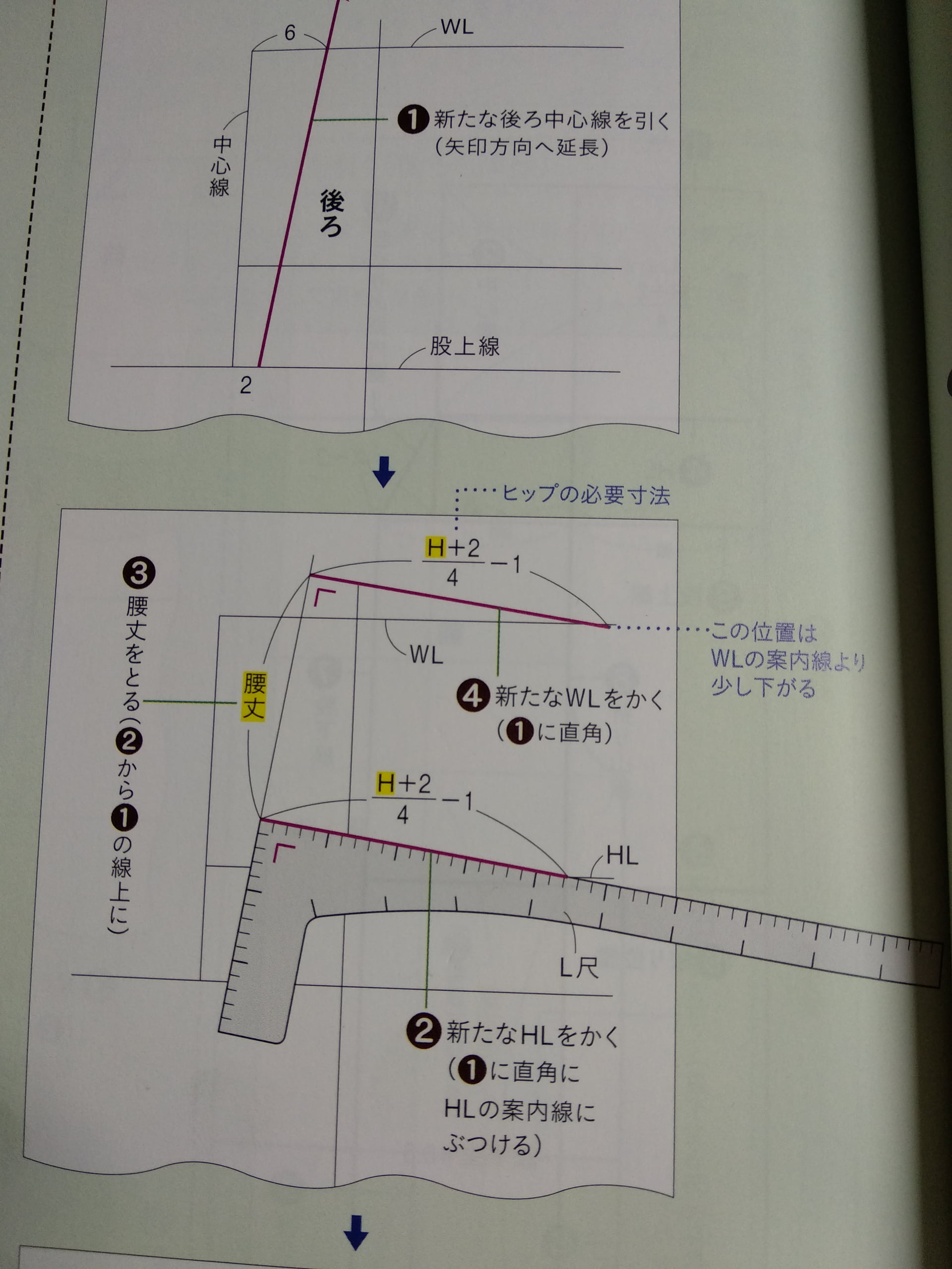

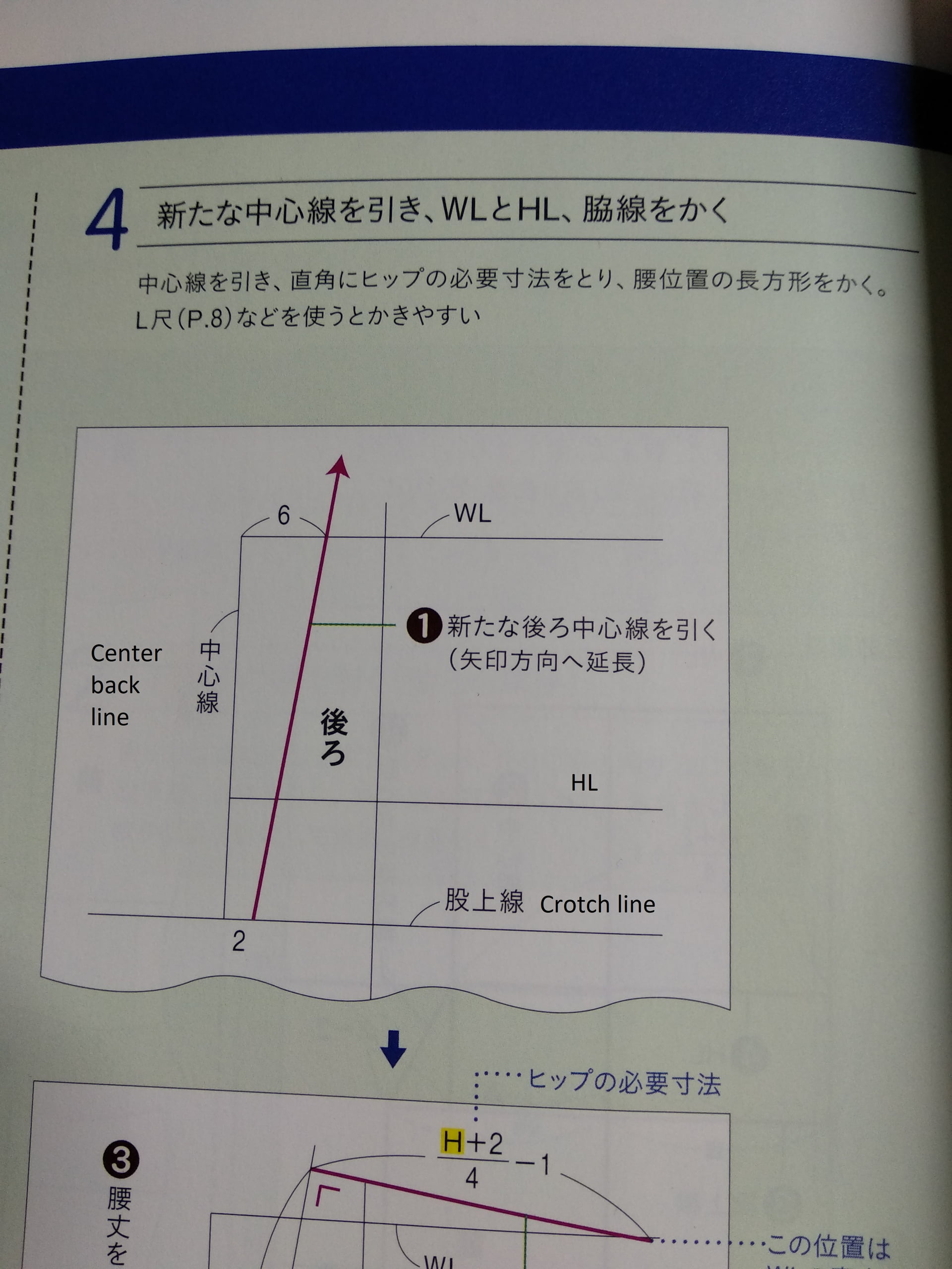

Hello, I am following the Bunka basic pants drafting method and I do not know how to do this step on Seamly.
Here’s the steps:
A new Center back line (purple arrow) is drawn by shifting 6cm to the right at the Waist Line (WL) and 2cm right at the Crotch line, connecting these two points.
This next step to draw a new Hip Line (HL) is where I’m not sure how to do on Seamly.
Say my hip line length [(H+2/4)-1] is to be 26.2. On paper, I’m to use an L ruler to draw a perpendicular line from somewhere along the Center back, intersecting somewhere along HL with a length of 26.2.
How do I do this on Seamly when I have 2 unknown positions?

It seems to me that there is a fixed distance of 6 here, but I don’t know if it’s 6cm or what:
And then, there’s a 2 that could also be 2cm down here:
Once you have this line established, you can add a node on the top line, using the Intersect Arc and Line tool to place a node on the waist line at the correct distance.
A tip is to place an arc from a known point and intersect the arc to position the node.
If you send me your files, I can probably help you a little better, but I’ve mocked up an example of how I read the picture :upside_down_face:

The original Center back line (中心線) [Line B to B2 in my draft] is a vertical perpendicular line from the crotch line (股上線) [Line B2 to B4]. We’re supposed to draw a New Center back line which will be slanted. We do this by first marking 2cm to the right on the crotch line [B10], and 6cm right on the WL [B9] from the original center back line. Then we connect these two points B10 to B9, extending to above the WL [Line B to B12] to create the new center back line.
Next, is to draw the new Hip line (HL). The original HL [Line B3 to B11] is perpendicular to the center back line. Since our new center back line is at a slant, we need to draw a new HL perpendicular to this slanted line.
The length of this line is the formula ((Hip+2) /4) -1, which in my case is 26.2cm.
On paper, we’re supposed to use the L ruler, place the base along the new center back line [Line B10 to B9] slightly above the original HL [Line B3 to B11], slide it along the center back line, until we find a perpendicular intersection point along the original HL at 26.2cm.
