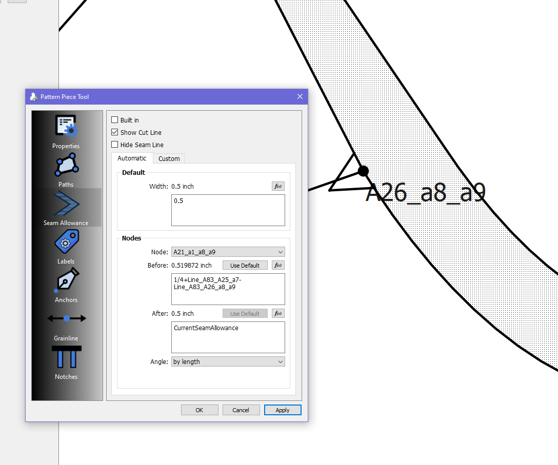

Today, I found out that the seam allowance used in the piece mode can be set using the function box (aka using lines, curves, measurements, etc)!

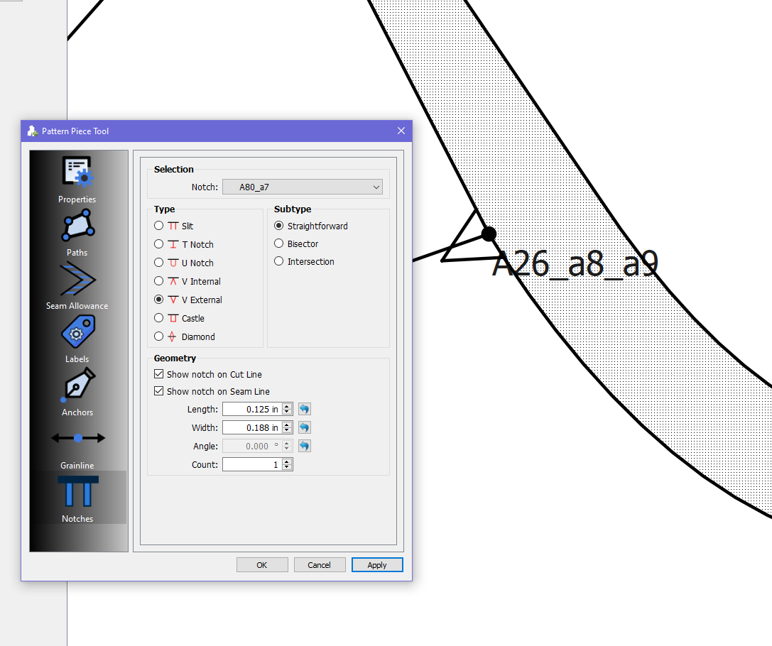

An issue I noticed is that any point that uses this feature in seam allowance loses the notches I set in the cut line. The seam line notches still show, but not the cut line notches. When I check properties, the notch still exists, but it does not show on the piece.

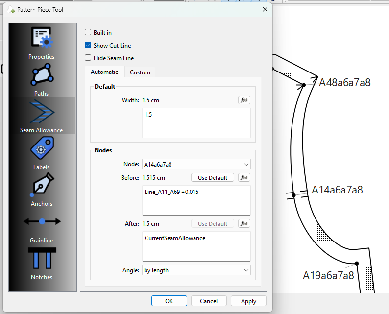

I too would have to see the pattern. That being said I did a similar thing using a formula for the SA at the notch node, and also tapering the SA smaller before the notch node… no problems.

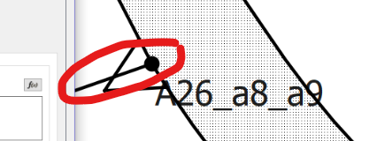

I’m more curious what the line is coming from the notch node? It’s not the point name leader.

Oh, that was just a dartline starting from that point.
