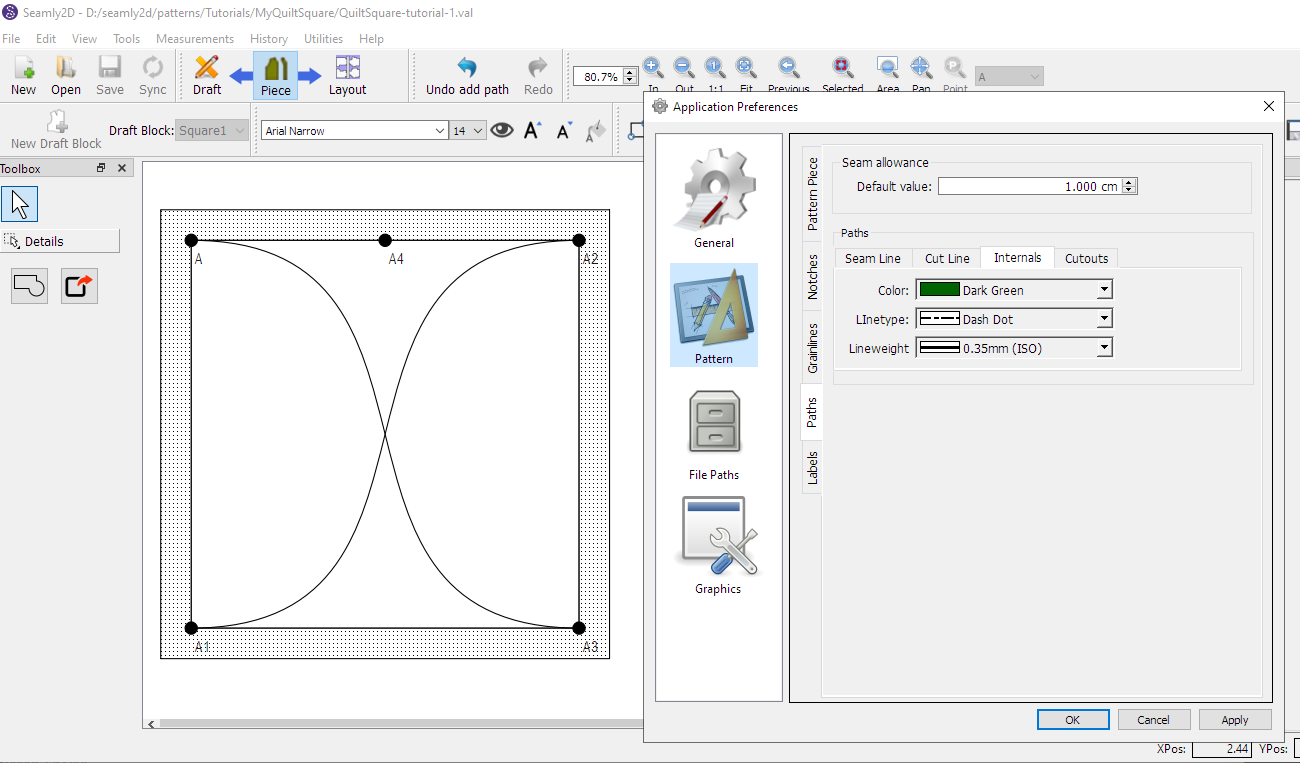

Here’s the screenshot for Internal Path preferences.
The Color and Linetype settings aren’t working.
Not sure about if the Lineweight setting is working.
1 curtida

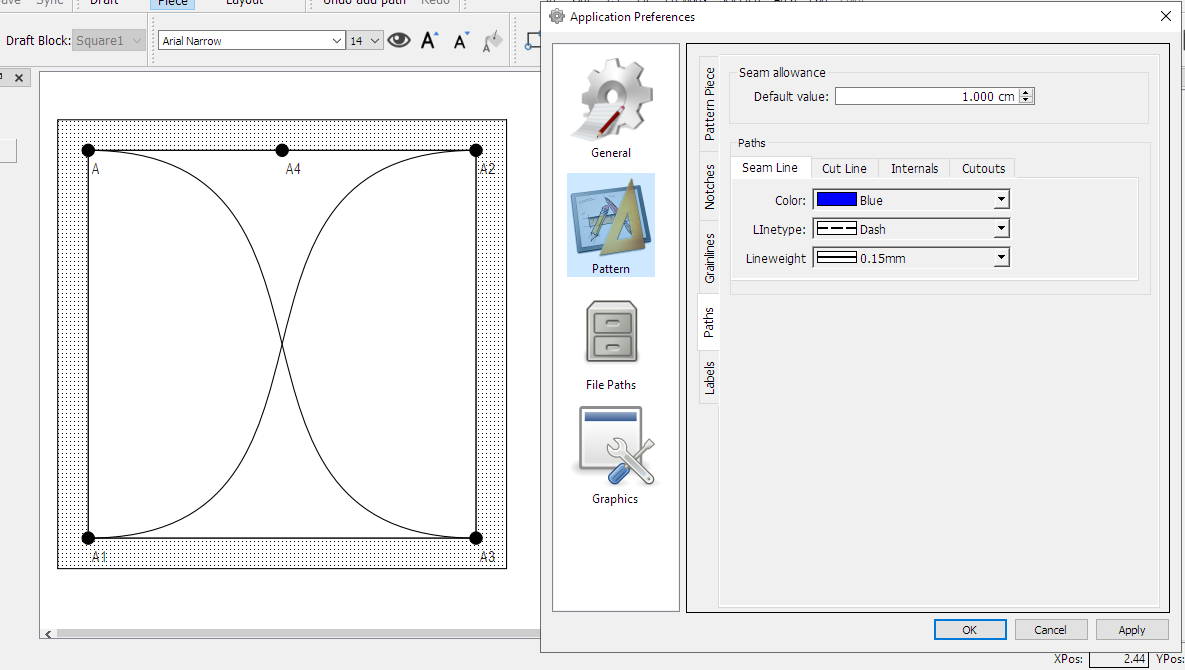

Here’s the screenshot for Seam Line preferences. The Seam Allowance default value is working. But the Color and Linetype settings aren’t working.
1 curtida

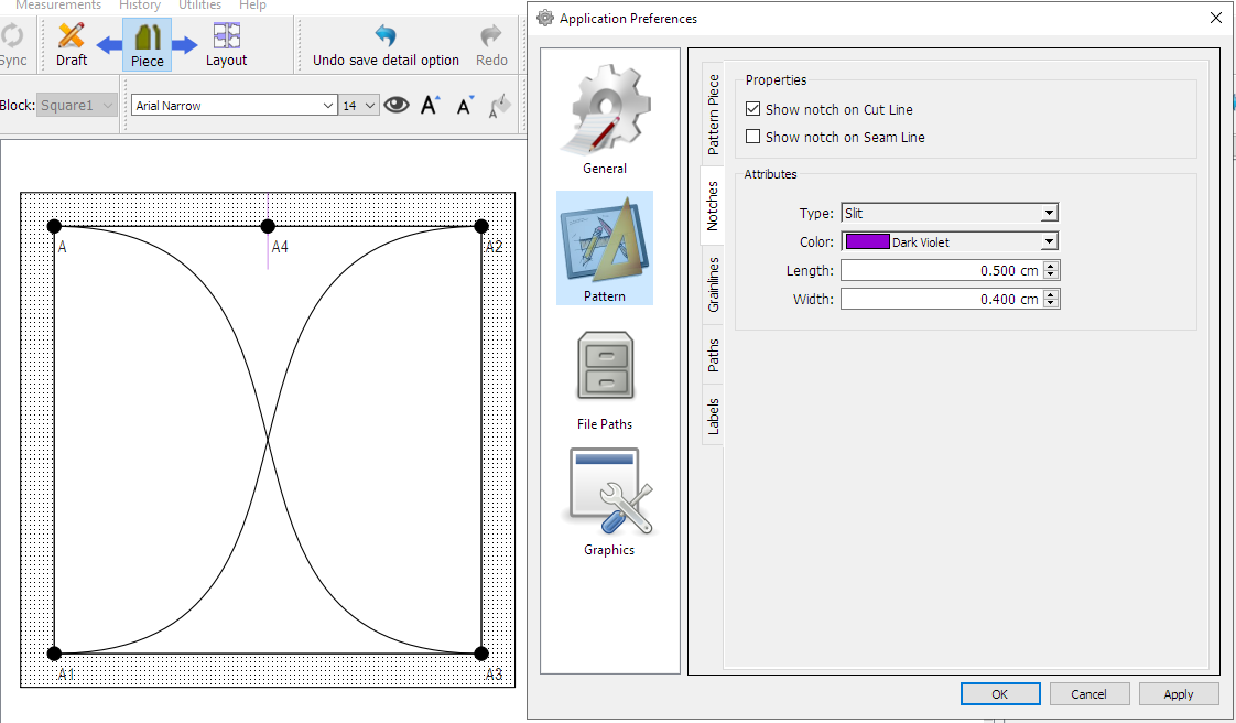

Here’s the screenshot for the Notches preferences. The Attributes section with Type, Color, Length, and Width is working. But the ‘Show notch on Seam Line’ setting isn’t working.
1 curtida
Confirmed… sort of. I will resolve #1 & 2, but we have to decide what to do with the iPaths.
First let me give some background… the way RT implemented the pieces in Piece and Layout mode is 1/2 arsed. Instead of 1 class to render a piece, there are 2 seperate ways the pieces are rendered in each mode… twice the work. :frowning:
So while the IPaths color is not updating correctly in Piece mode, it works fine in Layout mode.
ip_piece
layout
In the above example you can see 3 IP’s… 2 of which are orange and 1 bkack in Piece mode, while all 3 are orange in Layout mode. Actually I created 1 IP, saved, closed, opened, and repeated… when you open a pattern tge IP,'s will be drawn in the preferece color… adding a new one will render in black - the default default color. This is because the constructor for an IPath is harddcoded to black… when a pattern is opened all the IP’s are set to the pref color.
path_prefs
So it’s easy to fix that, but that’s not the issue. The issue is that RT made IP’s the only tool that has it line attributes used in Layout mode. As well as the odd check box to make the IP a cutout rather than another type in the drop down.
IP_dialog
But that’s beside the point… we can’t have the option to change the line style (color, type, weight) in Piece mode, while using a global pref in Layout mode.
IMO… we should remove the linetype option in the IP dialog, and simply use the global prefs to render the IP’s and Cutouts in both modes. Also I would also remove the Cut on fabric checkbox and add a Cutout item to the path Type dropdown.
Also I might make the type editable in the IP dialog in Piece mode after a path us created. Currently you can’t change the type. IP_can'tedittype
1 curtida
It does if you save, close, and reopen. It’s because the pen attributes are hardcoded in the constructor, which are over written when the piece class is created… and of course new IP’s are constructed after the piece class, so they are not over written until the pattern is reopened. easy fix, but that’s not the issue.
1 curtida
Haven’t looked at it closely, but again, it’s might be related to not setting the notch checkboxes to the pref default in the node constructor.
1 curtida
This one’s got me a little baffled at the momment… it’s all wrapped up in that is there seam allowance and is it built in - as all the paths, pens, and brushes get swtiched around depending on the state, but I’ll figure it out. :slight_smile:
1 curtida
