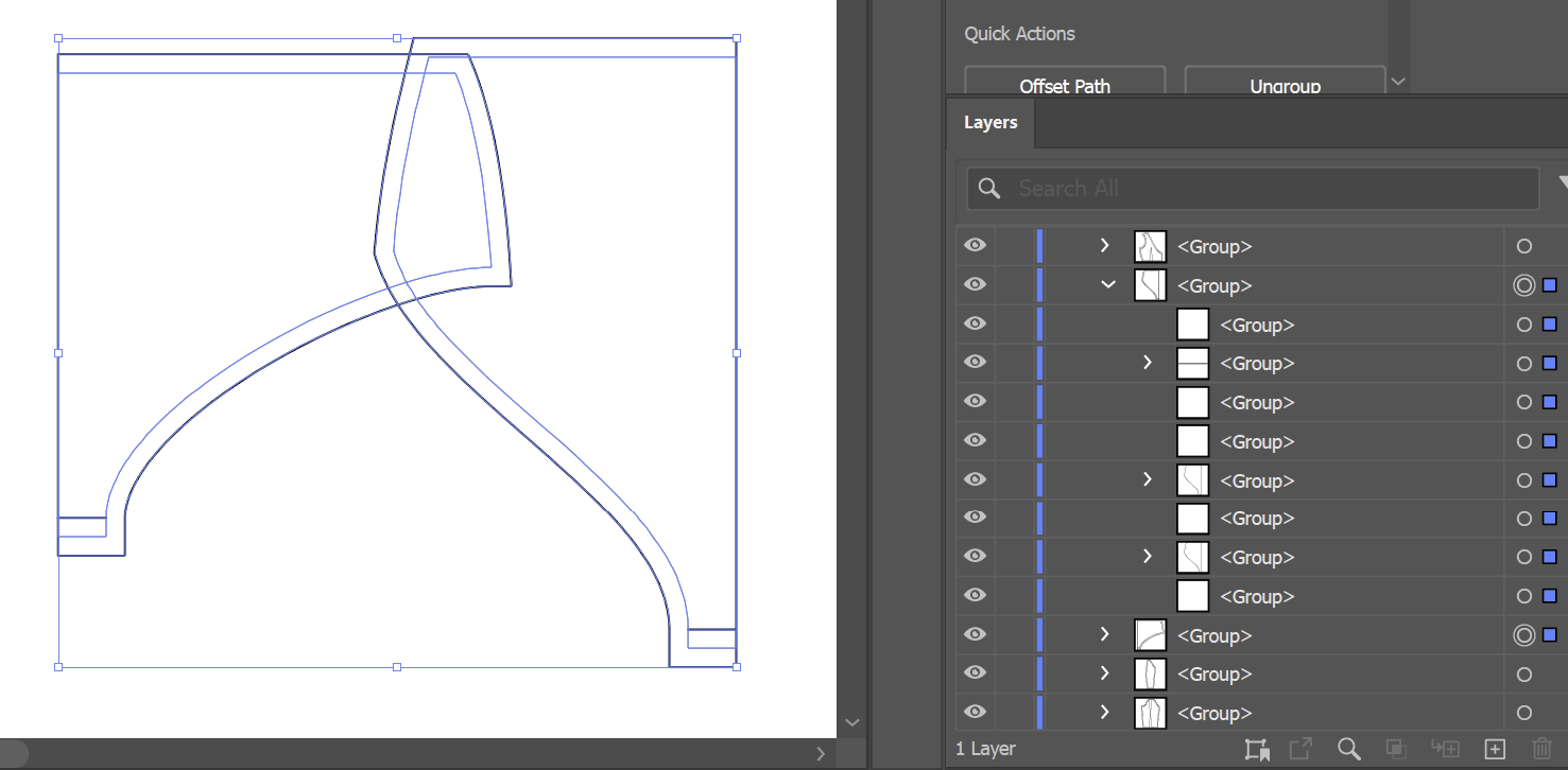

I’ve run into an issue. Ever since the update where pattern pieces now export as their own group (which is great), the align function in Illustrator no longer works as it should. I have patterns that were exported in an older version that have the pieces align correctly, so it’s not an Illustrator issue.
To now get the pieces to align correctly, I have to flatten the transparency of each layer separately (when dealing with different sizes in different layers, otherwise they get grouped into one layer), ungroup the layer, and group each piece manually again for each layer, effectively undoing the grouped export and adding extra steps to be able to align the pieces.
Has anyone else had this issue?
The pictures are just to show what is happening when I align my pieces both vertically and horizontally. I am of course not trying to align my pieces like this for this pattern.
This is the alignment after exporting the grouped pieces:
This is the alignment after flattening the transparency, ungrouping the layer and grouping each piece, and what the result should be: image
It seems like the grouped pieces have an invisible box around them, but no matter what I try, I can’t seem to get rid of that box.
Thanks in advance for any insight and help!

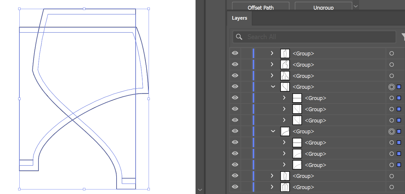

I’m adding some more pictures (with less pieces this time, so it’s easier to see) to show the correct bounding boxes, but wrong alignment: image image image
The alignment should result in this: image
To get the second result, I didn’t delete any points, but did the steps I described in my initial post. If there were any stray points, I should have gotten the same faulty alignment.

Very interesting! I opened up my file again to see and multiple clicks does give a different result. However, in my case, no matter how many times I click, it’s never fully right. I opened up the pattern piece and have a few empty groups for each piece. After deleting those, the pieces align correctly.
Aligning before deleting the groups:
Aligning after deleting the empty groups:

Yes, that was the alignment after deleting the empty groups, which was correct!
I found a fix! As you already mentioned, there are usually some stray points. I get rid of those with Select > Object > Stray Points. The fix for this issue seems to be deleting all the empty groups with Object > Path > Clean Up. It removes all the empty groups and fixes the alignment issue :blush: (And it also seems to get rid of the stray points, which I didn’t know yet and saves some clicks!)
