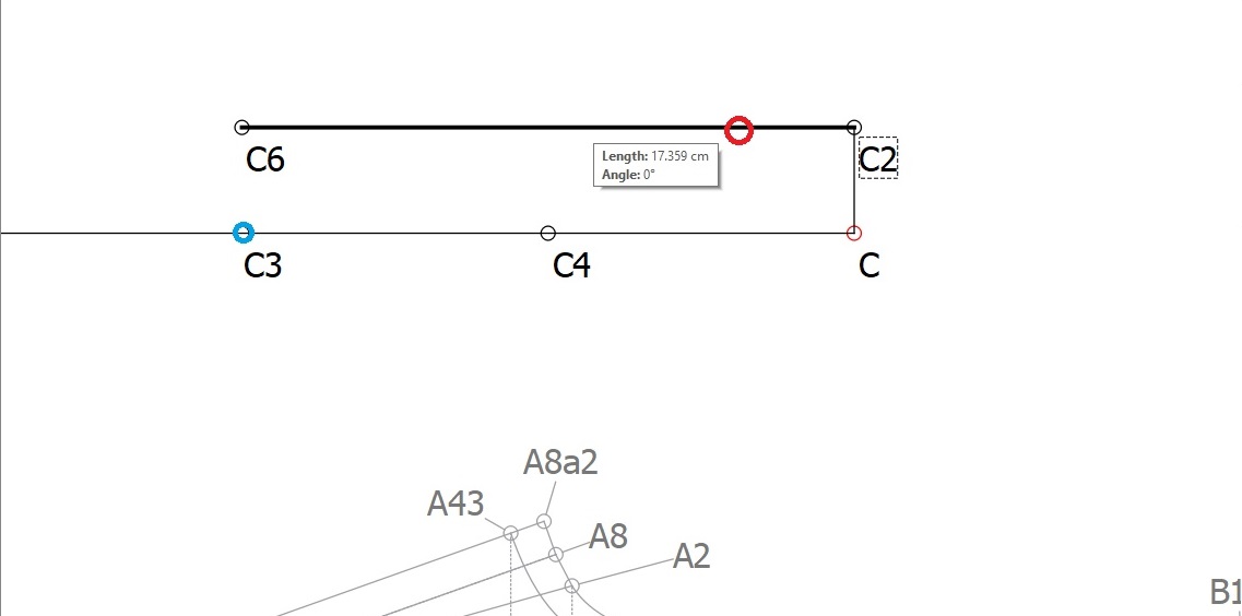

Hello,
I’m working on a collar pattern and I need help. I need to translate the length of the line C3 - C to a line starting at C3 (circled in blue) and intersecting with line C6 - C2 (circled in red). I’m unsure how to do this, as the tools typically use are based on angles, not length. My initial thought was to use the point intersect line and axis tool and calculate the angle with a formula, however I don’t have the ability to properly calculate the angle without knowing the length of either the other sides or other angles.
Any help with this is greatly appreciated!
If I understand correctly what you want to do…
Select the "Point at intersection of arc and line: tool1
Follow the status bar tips: Select line from point C2 to C6
tool2
Set the radius to the length of the line_C_C3
It will produce the point intersection of the line and arc where the distance from C3 to C1 (or whatever yur point name is) is the same as C3 to C. tool3
