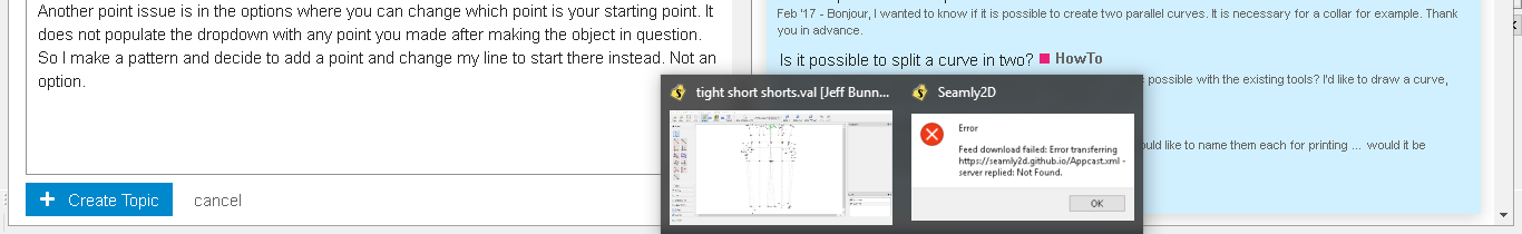

oops failed on the first screen shot, that is the error i get when I check for updates
