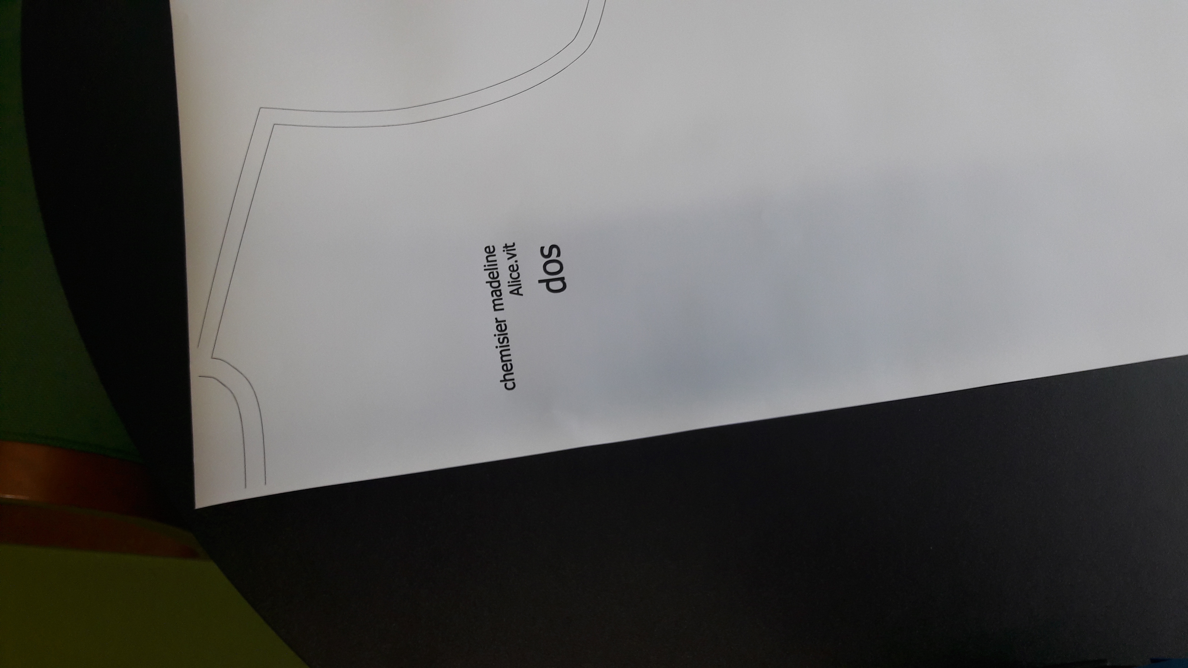

HEllo, I have a problem since the 6.0 version with margin :
I d’ont know how to fix it or wich parameter I can change for seeing everything.
Thank you for you help

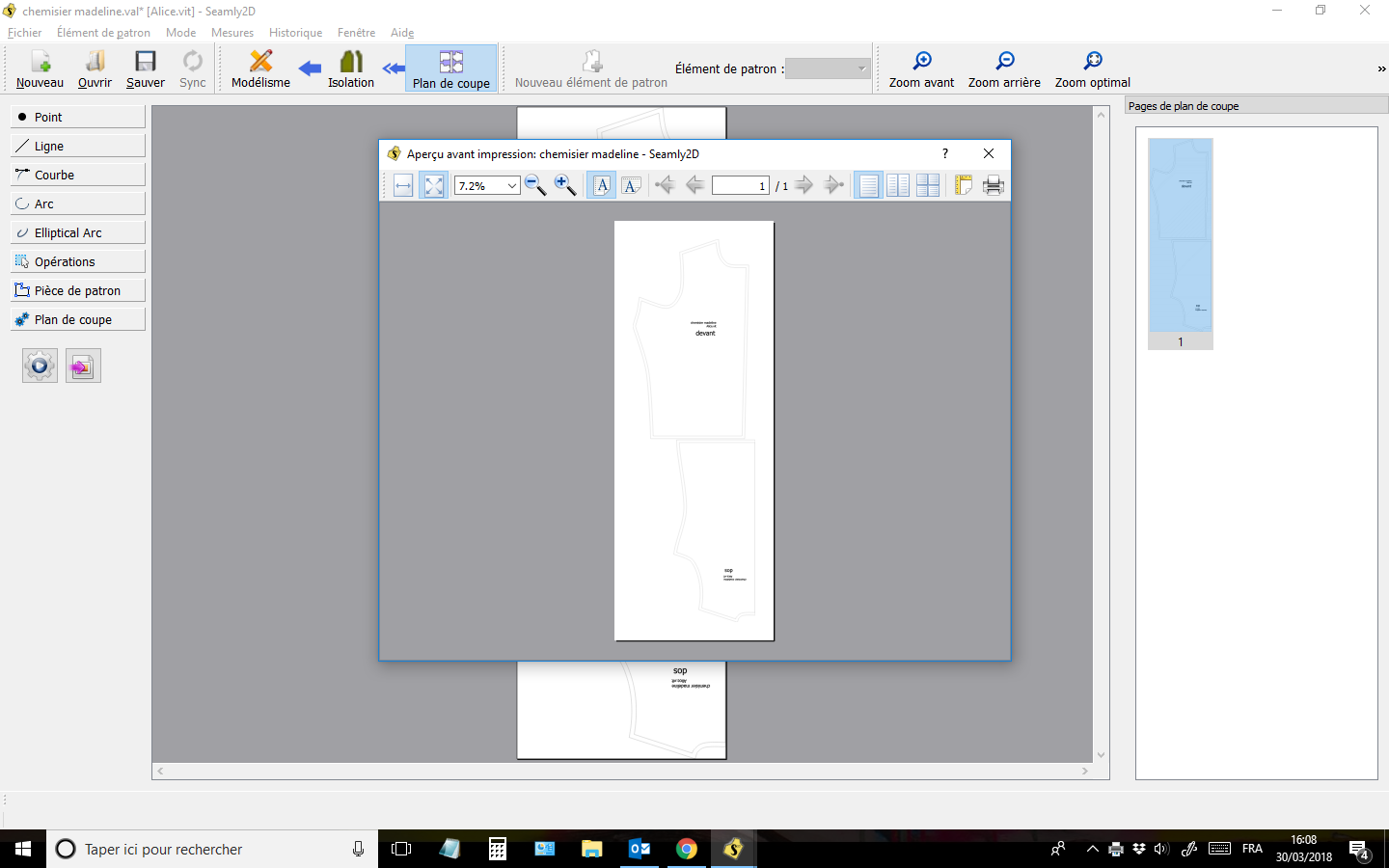

It seems to me that there should be another page that needs to be attached next to those ones, the paper is too narrow for the pattern. Perhaps look through the pages in preview and check if that’s not the case.
You need to increase the margin size. I suggest that you increase it on all sides (left, right, top, bottom) Try using 1.0 as the value for each. This is larger than you really need, but you can experiment with it.
Here is the place where you change the parameters margins
To see that page, you must exit seamly, restart seamly, open the pattern, and select the Layout mode at the top.

Hello, no it is not possible it’s roll or paper is it ok and i did not have this problem before. Do you have another idée?

Hello I triés to change marges but or look like nothing change…i don t know why I will look at the link. Thank you

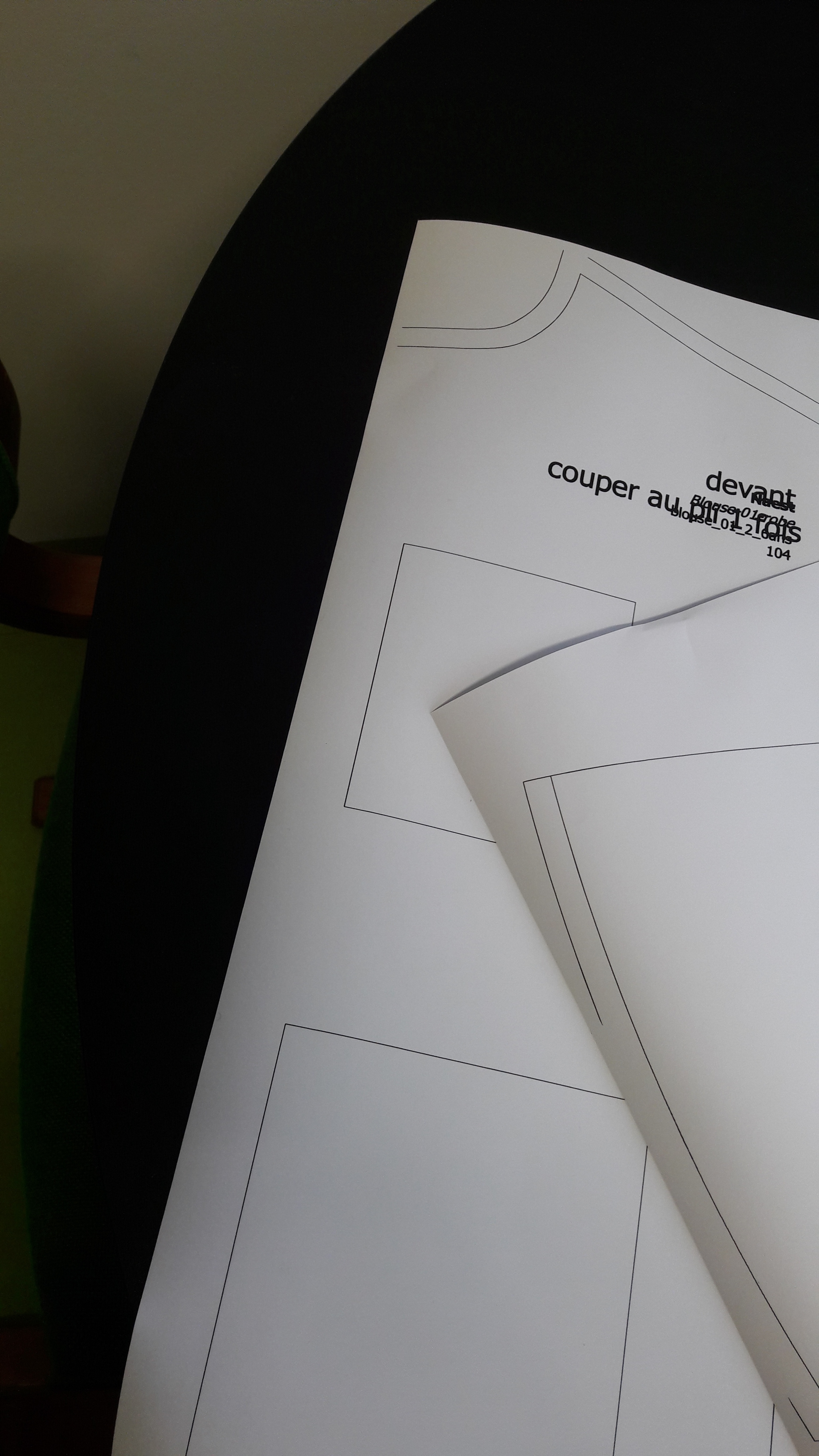

I do not understand the problem. Even by changing the margins, printing does not work. I have no explanation or solution. I tried to change different settings, but nothing works. And I do not want to print on A4 bat roll A1 Do you get to know where the problem comes from? AND why did it work with the previous version?

Rolls of paper need quite big margins to keep the paper lined up straight on the sides and also at the top so that the printer can grab the paper and feed it through to be printed on. The bottom as well so that an area is available to cut off the printed portion.
I see your printer margins are set to 0.
Increase these sizes until your pattern all prints on the roll paper: image
yes I know, I have tried with 3 cm of marges, it is the same.
Put it up to about 7cm or 10cm and work down from there, if it works.

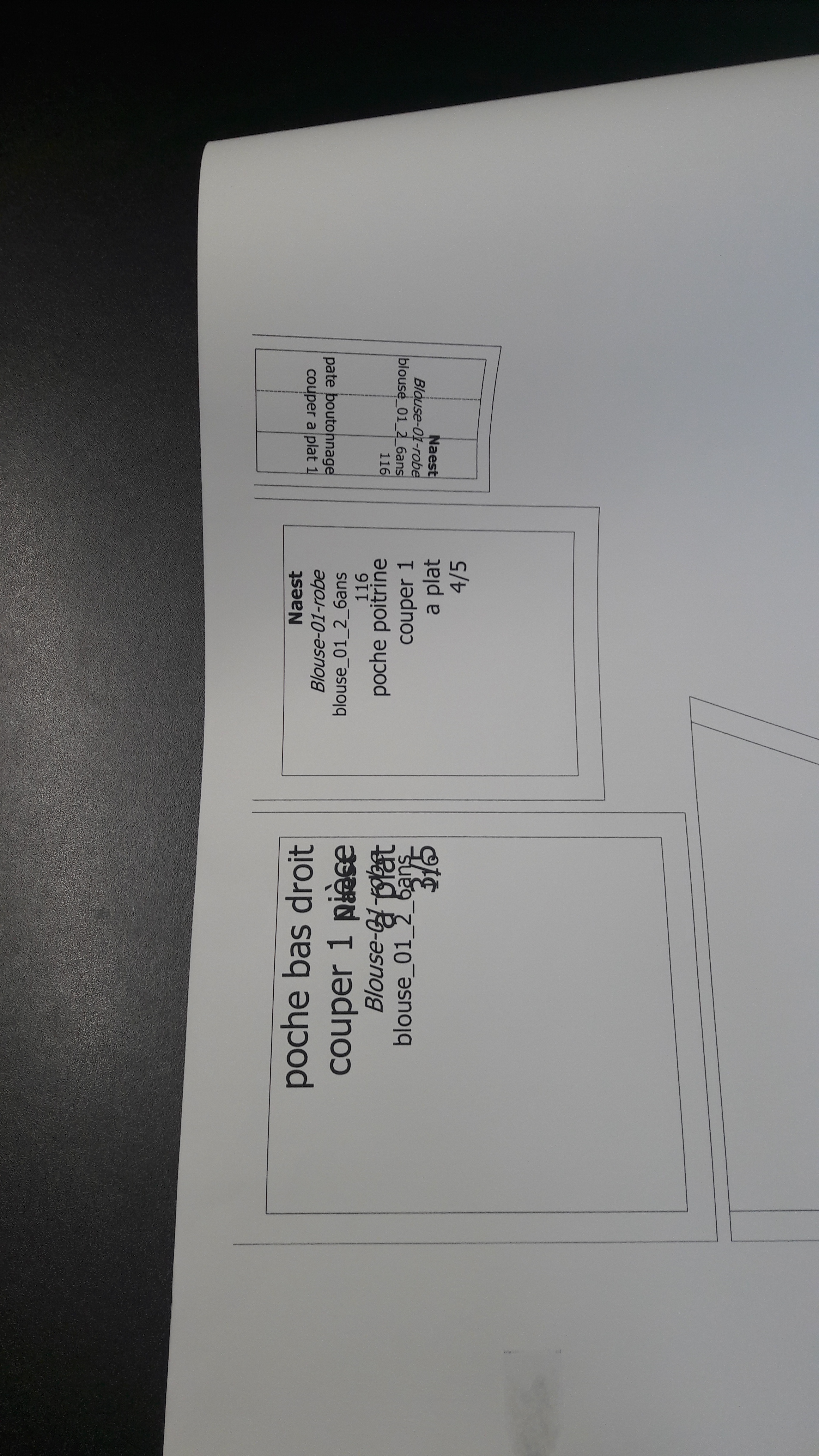

oK SO :
and after :
:triumph::crazy_face::sob:
Maybe try printing to pdf first?
I tried but I can not adjust the print on the pdf reader. In addition, as I print a lot, it requires a lot of manipulation to print in pdf before. What I do not understand is why with the previous version I had no problem. I am also looking at the settings of my printer without success.
It is as if at the time of printing, the adjustments made and seen on the screen were not taken into account …
It’s really very strange. The only thing I can suggest is that you go back to the previous build that did work properly for you.
I’m hoping that one of the programmers will see this post and find a solution or the cause of this problem.
@lilou if you can click the “Help” menu at the top of the Seamly2D screen and select the “About Seamly2D” from that menu you will get a window that looks something like this: version. If you can post a screen shot that will help a programmer understand which version is not working for you.
Also, the program is confusing. You have to choose a paper size big enough to hold the whole pattern when you create the layout. This is NOT necessarily the paper size in your printer. You can use tiled printing to print the pattern onto A4 or letter AFTER you have created the layout.
