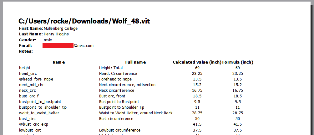

I believe the answer is - it already does. I just loaded the Gost vst and randomly selected a size and height,
multi
Although something I did notice when print previewing the Gost file… I need to get the preview to update if you set the print settings to landscape. Would have thought that would have been an internal function of the preview dialog - guess not.

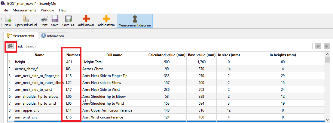

I think she’s meaning more like G04 on the Bust circumference line to give some indication of where the measurement is found in SeamlyMe.
No, just the items code in SeamlyME, along with it’s code name & actual name. E.g.: H01, height, Total Height.

So the question is… we want to include a new column that displays the code number? - which will automatically be included when you print a measurement file.
Easy enough to do since the associated diagram already pops up when you select a row - we know the code. Of course a custom
Oh, that will be so very amazing and helpful :star_struck: Something I’ve always wanted :grin:
So do you think putting the code # would be best in the 1 column or the 2nd between the Name and Full Name columns? Or another option - if the code # is not needed as a separate field - is to just prepend it to the Fullname text?
IMO, it should prepend the fullname, like in the diagrams. As a separate column, especially if optional.

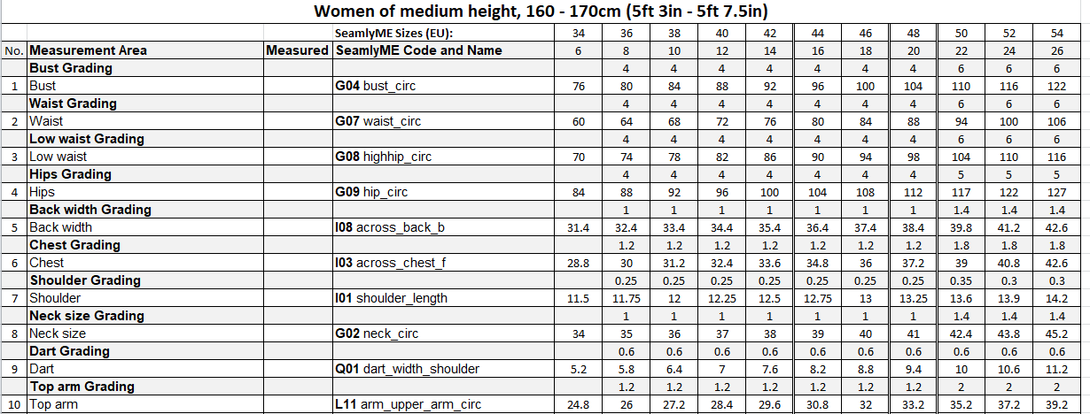

I don’t mind which column it’s in, but I’d like it separate so that I can sort the lines either by code or name (or any other column). I usually have my measurements in a certain order, so I give them numbers in my spreadsheet so that I can return them to the order in SeamlyME.
Here’s an example of how I do multiszie:
Make sense. It’s a little more work, but easy enough to do. So I gather your currently manually prepending the code to the name? Which is really not necessary as the info is available, it’s just a matter of putting it in the table. Should save you time. :slight_smile:
Done. While I was at it I added a Copy to Clipboard tool button so you can just cut and paste the selected parts of the table in a spreadsheet and avoid the export/ import csv.

Well the internet cam back, so I pushed the changes to add the clipboard & measurement number.
