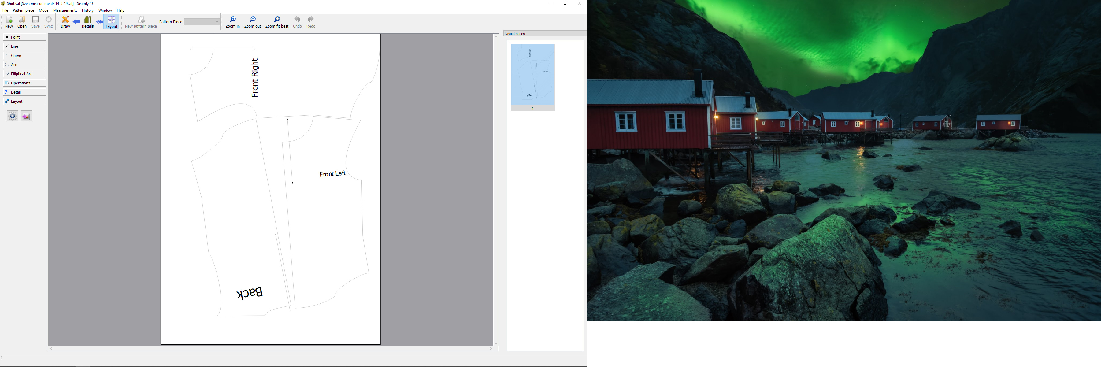

screenshot
I think it might be a Seamly -> Windows problem.

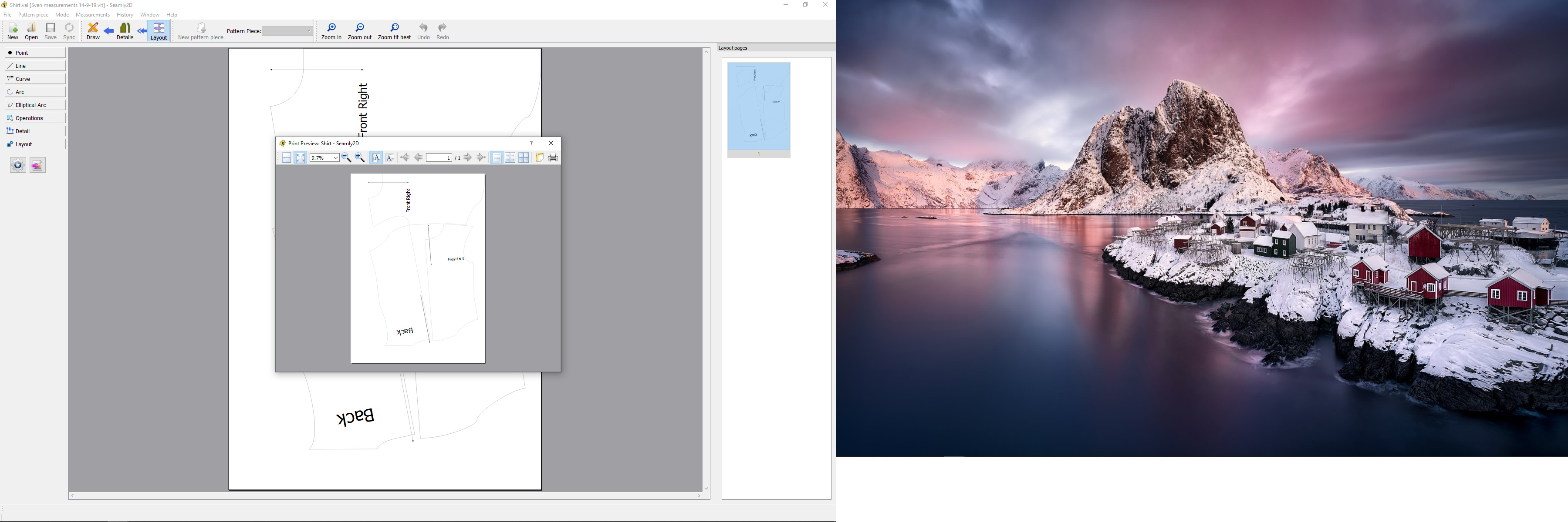

The print preview shows correctly image But still prints to PDF blank.
