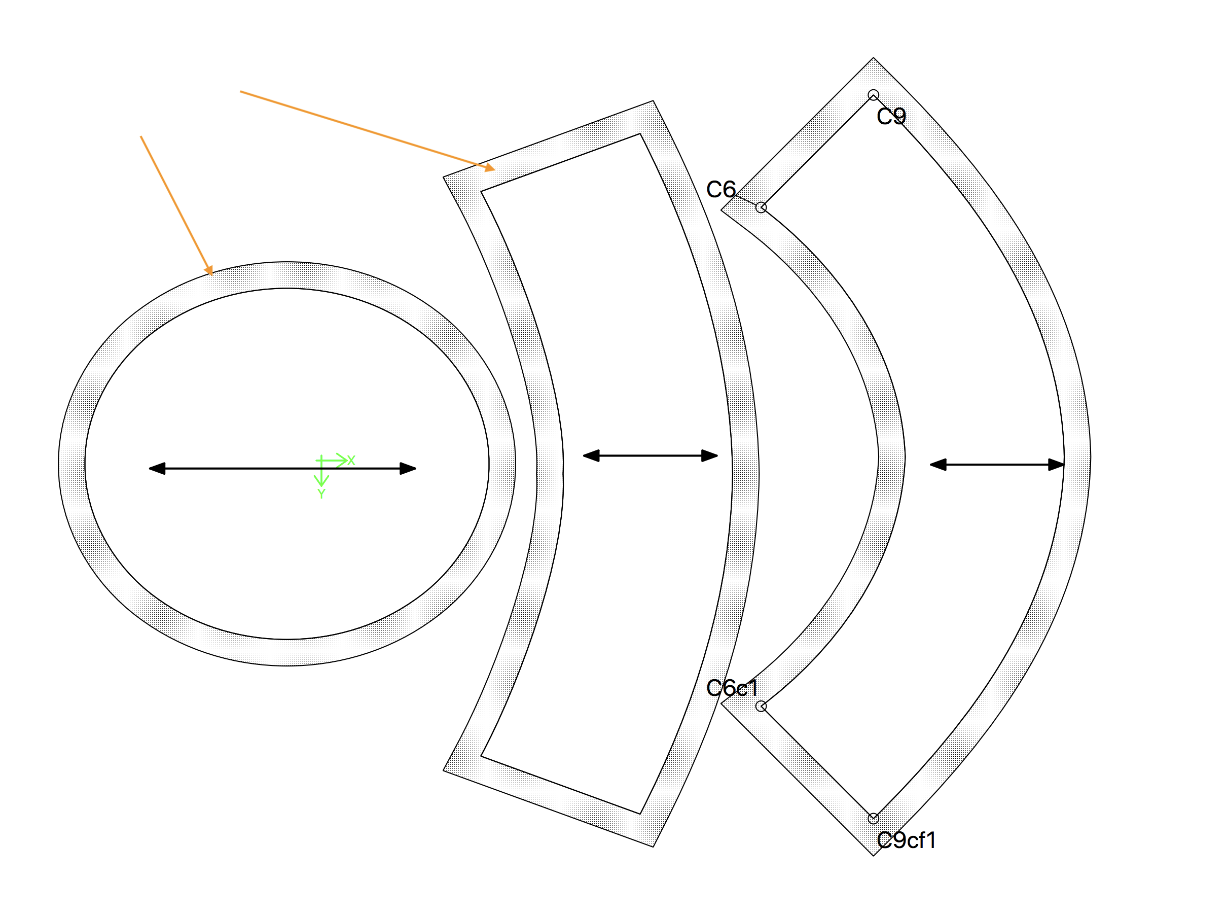

J’ai une autre question, est-ce qu’il est possible de rendre invisibles les valeurs de couture pour ne pas voir le trait gris?

I have another question, is it possible to make the sewing values invisible so as not to see the gray line?

Sorry, I don’t understand? I think, if you post a screenshot or send me the file, please, I’ll have an idea :disappointed_relieved:
Hi, Grace,
I would like the seam allowance, but not see them.
When you print the pattern, the seam allowance will only be a line around the article - it won’t be shaded like in the layout board.
If you don’t want seam allowances, you can turn them off, but then you won’t see the passmarks. If you want to see the passmarks, and don’t want the seam allowances, you can place a checkmark in the box “Built In”.
If you are not using passmarks, then you can leave the checkmark next to “Seam Allowance” out.
But I can’t think of any way that you can like the seam allowance but not see it :grin:
I see your hat pattern is really looking good now :grinning:
Thank you!
I was hoping to keep seams allowances, but shadows and lines do not appear. My goal is to make a multi-size pattern to offer it to the customers of my shop.
