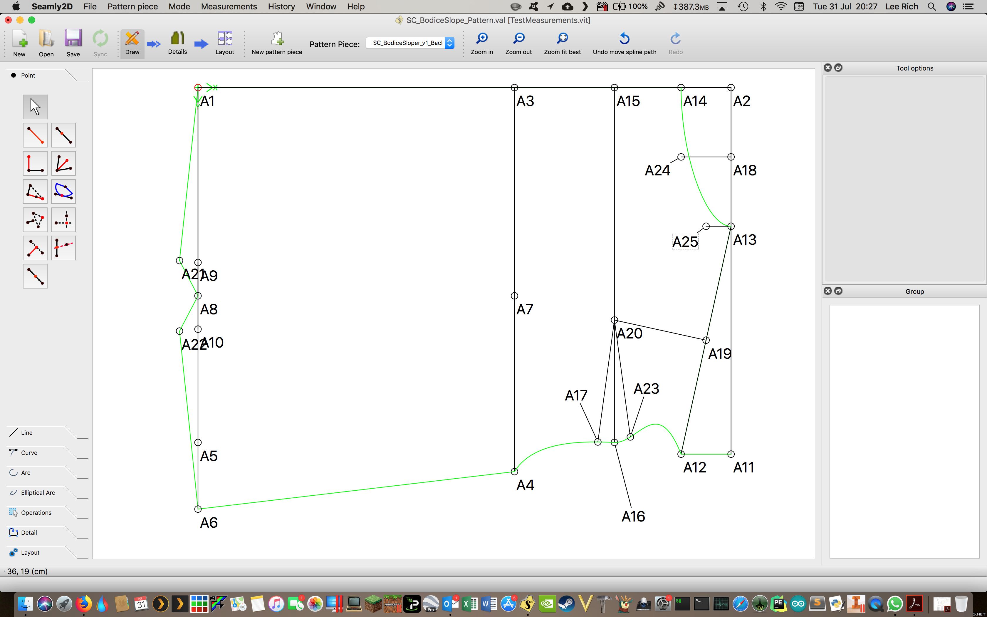

20:10pm Here is a screenshot just after I selected the curve A4-A16-A12-A11.

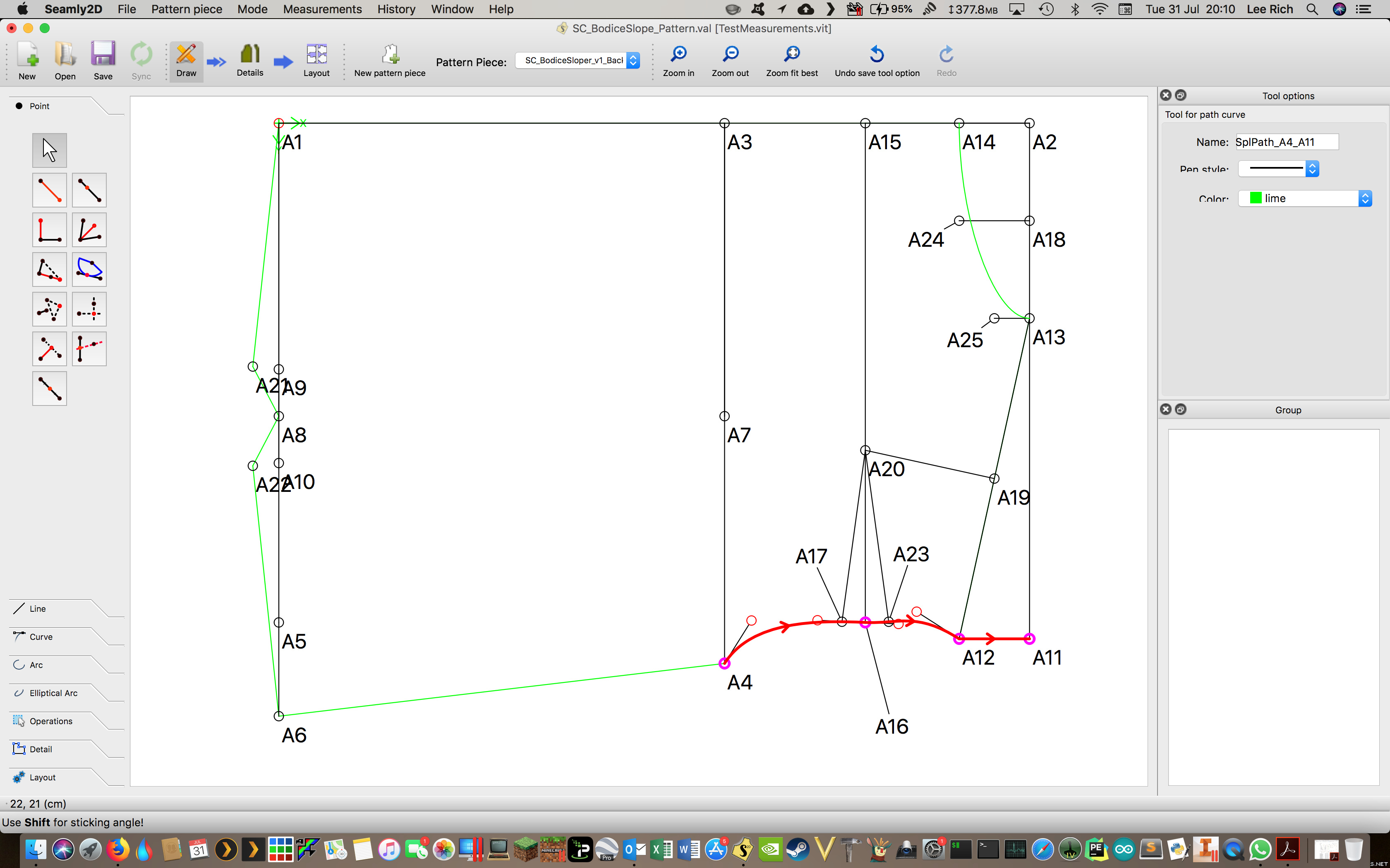

20:10pm The curve went red, showing it had been selected.
<a class=“attachment” href=">
20:11 From then, there was no response from Seamly2D for around 20 seconds. At this point the cursor changed to the ‘StarTrek’ arrow symbol, with a small red line at an angle below it - I believe this is the point control tool. I tried to select a handle, but there was no response from the program, so I released the mouse click.
20:18 From this point there were 7 minutes where nothing happened, until the next screen shot when the curve jumped and changed in shape. From the moment I selected the curve, the cooling fans came on, and remained on for the durations above until the curve moved. The fans then slowed back to normal again.
