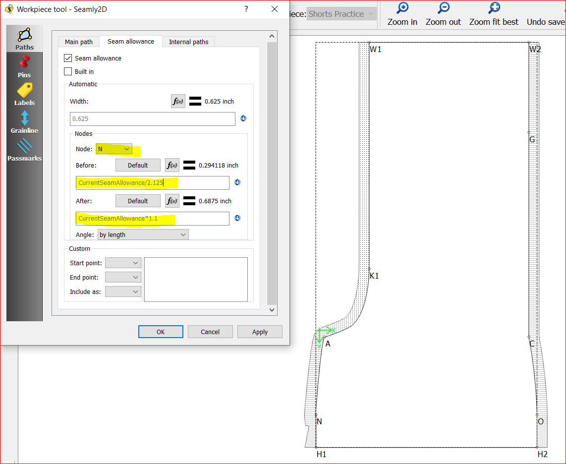

I’m trying to draw a paper bag waist shorts pattern and I’m having trouble with the seam allowances. I’ve included the waist and hem in the drawing so no need for seam allowances there but on the left side there is a jagged edge that I just can’t figure out how to get rid of. I’ve downloaded the new release and have checked the forum but I’m still lost. Can anyone tell me what I’m doing wrong?

Did you mean for point N’s seam allowances for Before and After to be different?
No that’s just me playing with it and making it worse :frowning:

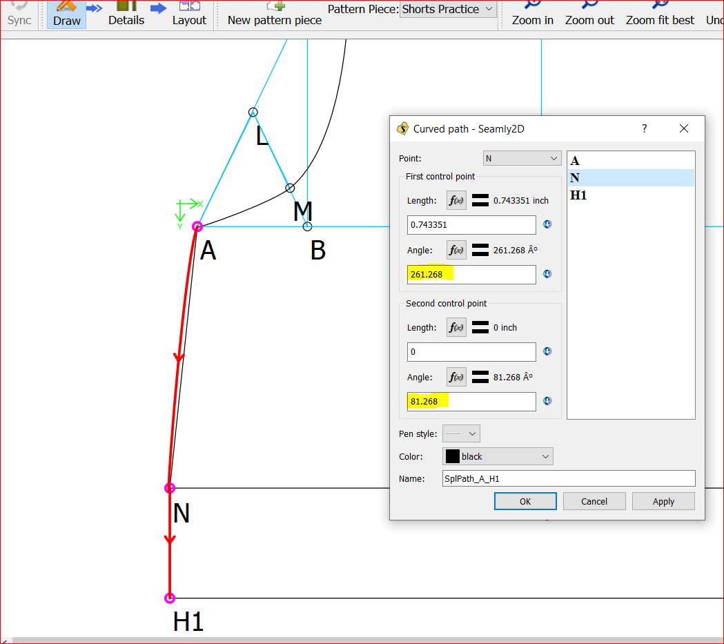

LOL! It’s your control handles around point N. They’re both pointing the opposite directions of where they should go. And one control handle is zero length, not really a problem but just sayin’.
Here’s a closeup: image

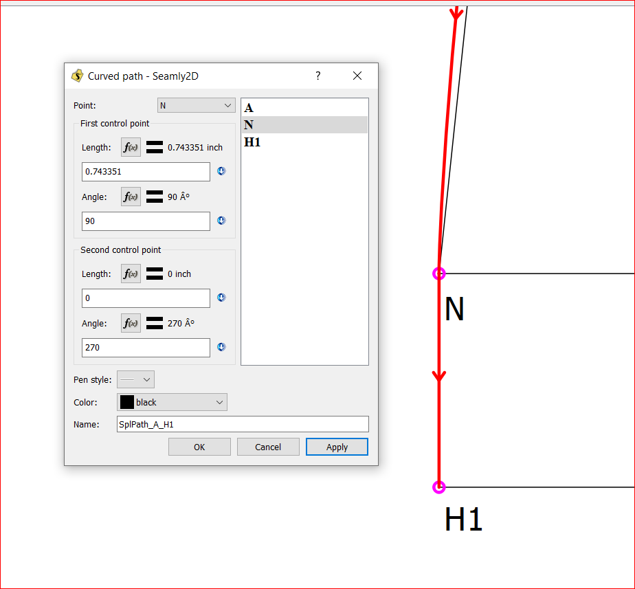

To correct, set 1st angle of N to be 90 degrees (straight up). The 2nd angle will automatically change to 90+180=270 (straight down) The control handles are now aligned with the line formed by N to H1, forming a smooth curve from A to N to H1. As it’s defined in the curve formula, its a curve from A to H1. But the last curve segment from N to H1 forms a straight line.

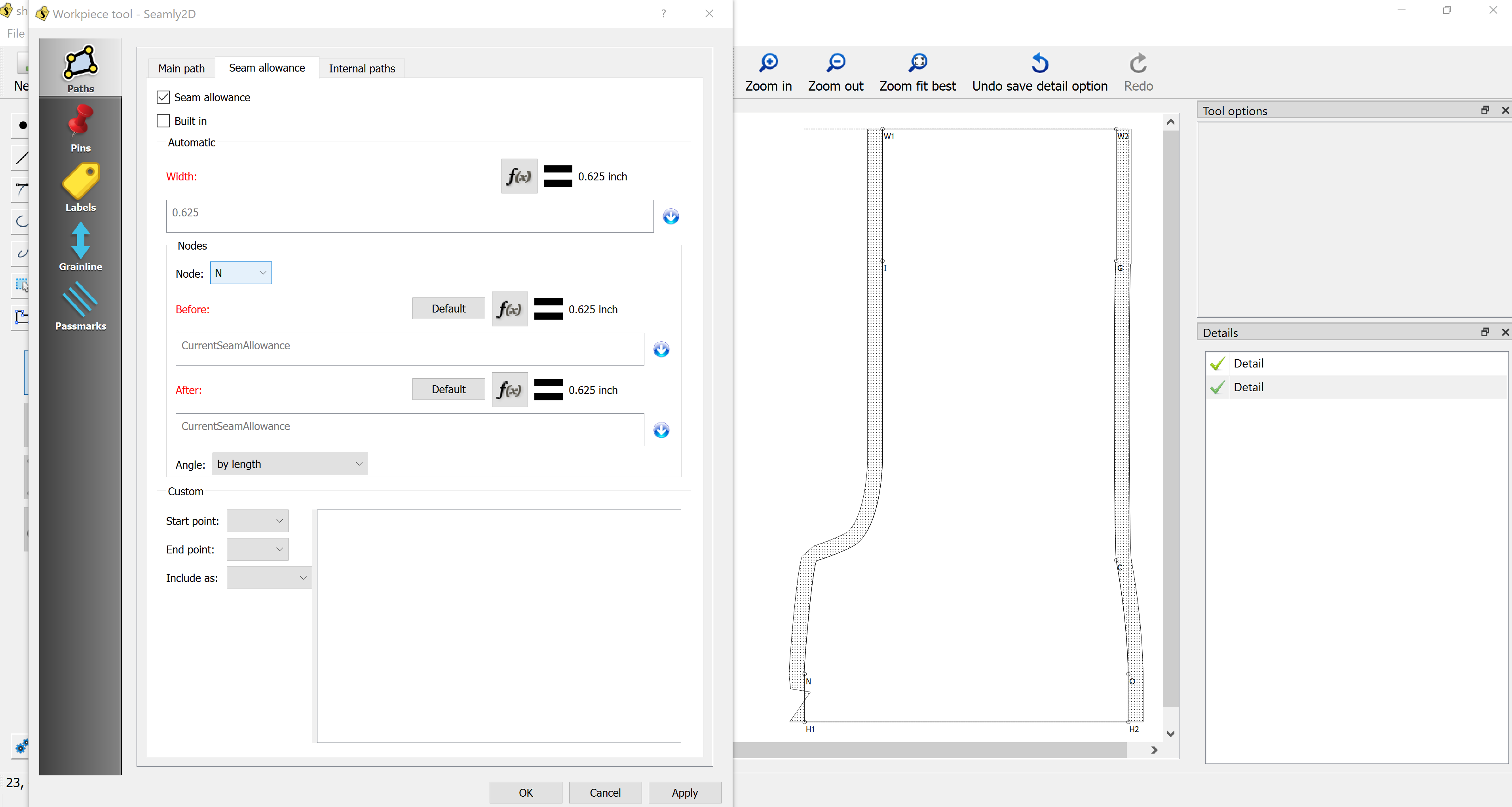

Thank you so much @Sue!
4 Mi Piace
You’re amazing! Thank so much, you’ve kept me from pulling ALL my hair out :slight_smile:
