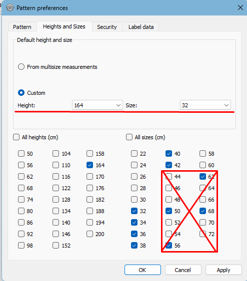

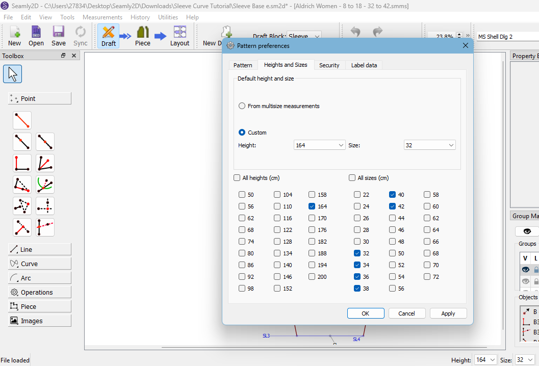

I normally set my Pattern Preferences according to the measurement file being used:

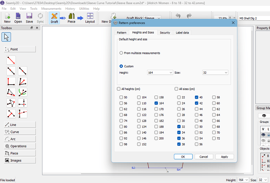

In this case, the increments cover sizes 32 to 42. I like to set the pattern to open on size 32. I don’t use the height increments, so I normally set it to 164cm.
Here, you can see that it does open on size 32 and that I only have those 5 sizes on the list when I want to change the size:
When I do open the Pattern Preferences after setting them, for some strange reason, it does show that other sizes are also marked, but we haven’t found out why they keep showing as check-marked but I just ignore that.
To get to the Pattern Preferences, open the pattern in Seamly2D, go to File > Pattern Preferences and select the Heights and Sizes tab at the top.

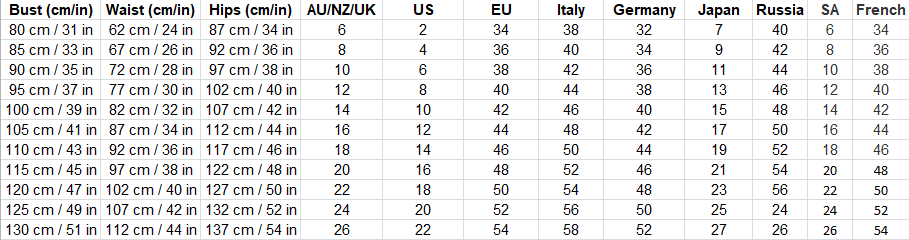

This is something that I tend to work with so that I can determine the EU size according the the country’s pattern making system I’m working with:

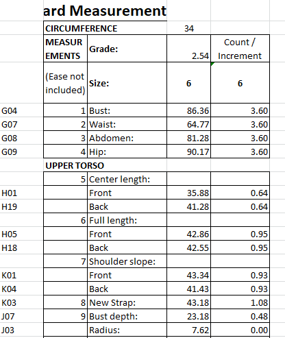

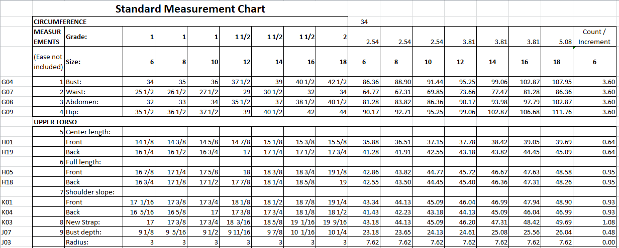

Before I even start a new multisize measurement file, I normally do it on a spreadsheet, convert the inches to cm, and find the average increment over a number of sizes. (I normally just use the 1st column of the table as the base size using the size conversion according to the table that I previously posted - if I feel like it, but consistency helps you to remember the sizes with time.)
This is a screenshot of a table that I did for HJA, all nicely coded with SeamlyMe image reference codes, converted to metric and increments calculated:
Then I hide the columns that I don’t need and only keep a few in view:
These are the 1st 3, the base size and the increment for sizes.
After have this in hand, I put it on the left side of my screen & open SeamlyME on the right side of my screen, start a new file, enter the height & base size, open up all the Known codes in the order that I have them in my spreadsheet and then open up any Unknowns.
With them all listed in order, it’s a small matter of going down the list entering the base size and increment to each measurement area in spreadsheet and SeamlyME.

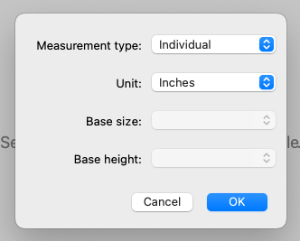

HI Grace. thanks for the information which I will follow setting up the multisite file. 1 question that is confusing me. When a new multisite file is started the prompt is for base size / height - is the base size for example 34 (European) or is it half the bust size as instructed in the tutorial on wiki? I also assume that the height can be defined here too example 164? Its slowly coming together and just trying not to make mistakes at the beginning. Many thanks for you hep. Mark
I always use the 1st size in the table as my base size, so from my Excel sheet above, I have it in front of me when I create the new file:
The height isn’t going to do anything, so it really doesn’t matter what you put in there, but it’s nice to be reminded what height the pattern making system measurements are for. So I put it in there, just as a reminder.

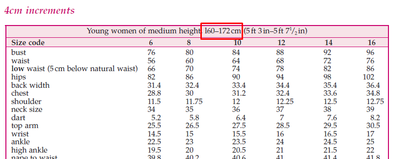

In Aldrich, they use this:
I can’t see where they say for what height in HJA.
So… If I was creating the file… I’d change it to Multisize, Units will be cm, Base Size will be 34 & Height will be 164 or 168 or whatever your in-house size chart caters for.
