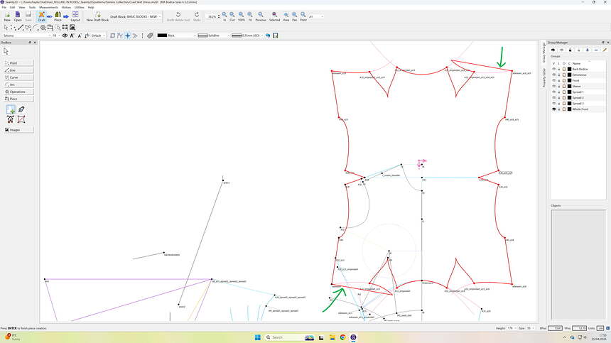

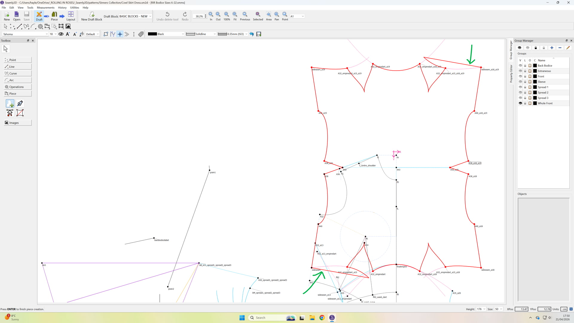

I’ve tried lots of different times to create this piece, and I’m sure I’m reversing the curves correctly, but it just won’t recognize the sequence I’m selecting everything in. Here is a screenshot of the piece I’m trying to make; I’ve indicated with green arrows the problematic parts:
(it’s basically mirrored horizontally and vertically so all four quadrants should be the same)

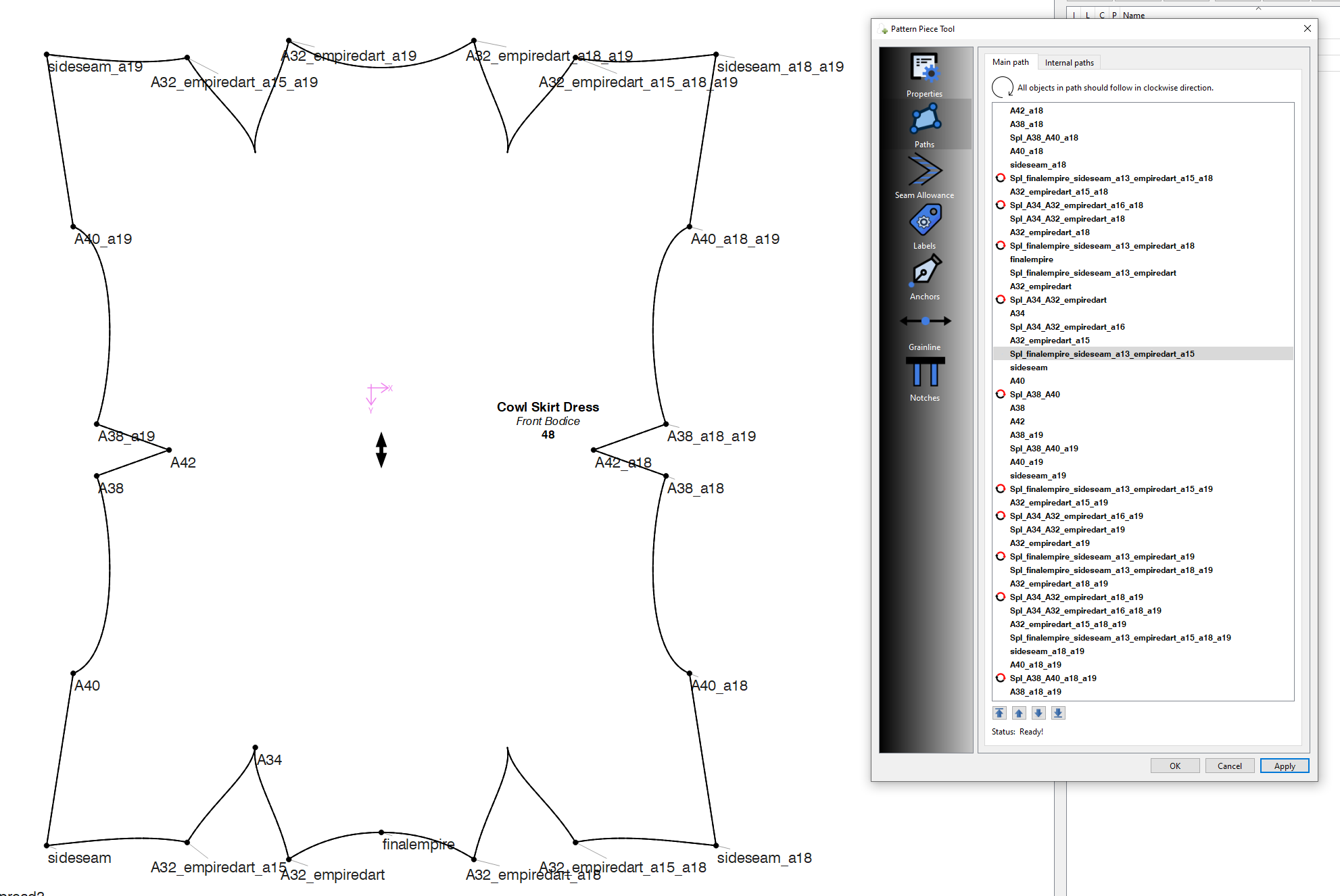

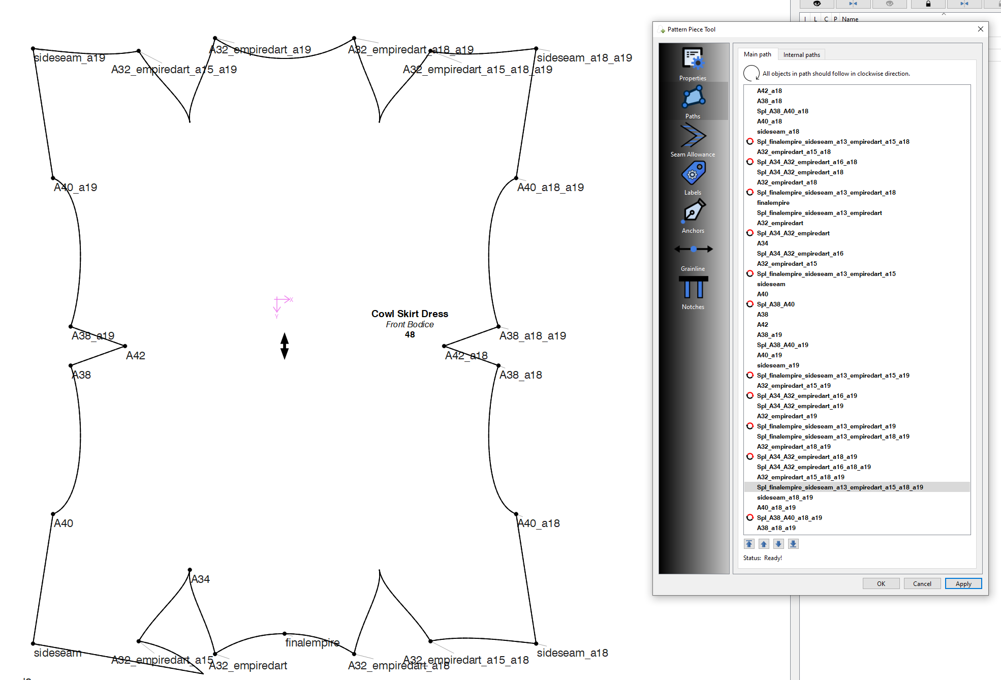

By works fine, I un-reverse that curve
just this, you know that you can change directions of curves with pattern piece properties?
and here is also the lower left corner, again without reverse
