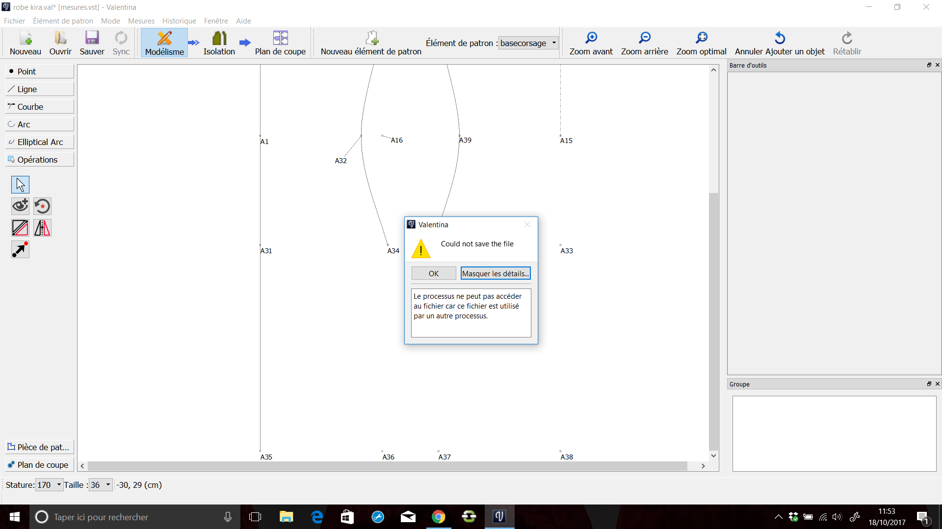

Hello, with my new computer, I can’t save my work, it’s writing could not be save “Le processus ne peut pas accéder au fichier car ce fichier est utilisé par un autre processus.”
I had to try to save several time for make it save. I afraid too loose my work.

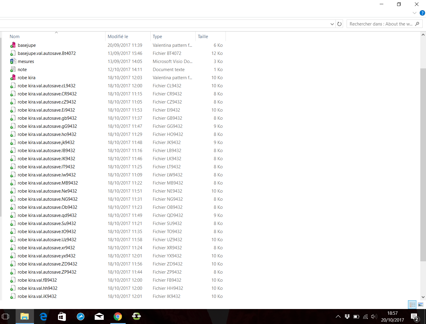

Look in this file’s directory, is there a locked version of this file? If so, delete it. (don’t delete the original .val file!)

Also, when you open your pattern directory with Windows Explorer, or linux Nautilus, do you see a file named <yourfilename>.val.lock ?
I don’t think so. But I’m registring on dropbox so perhaps…
I can save to another name but there is the same problem. Whatever tonight it seems to work, I don’t know why.

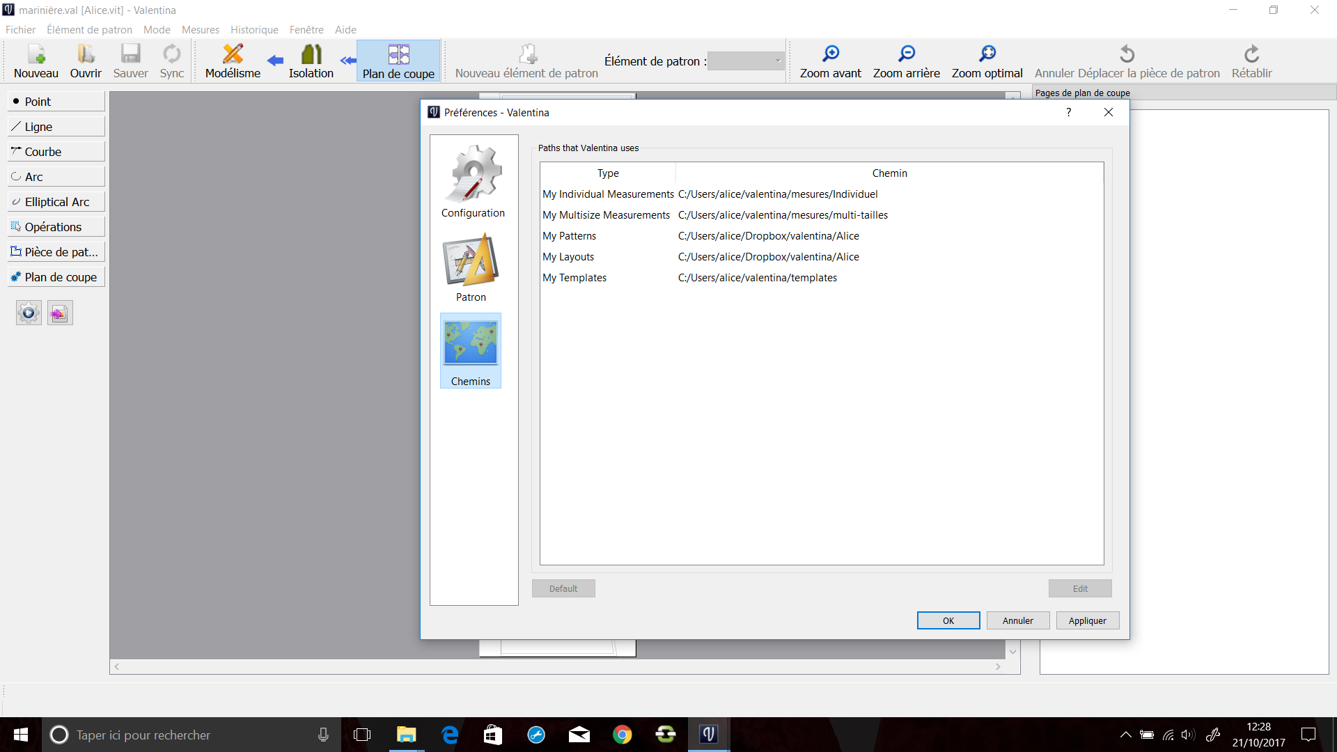

Do you think that it could come from this ?:
What happens when saving to your local harddrive?
What happens when saving to your Dropbox folder?

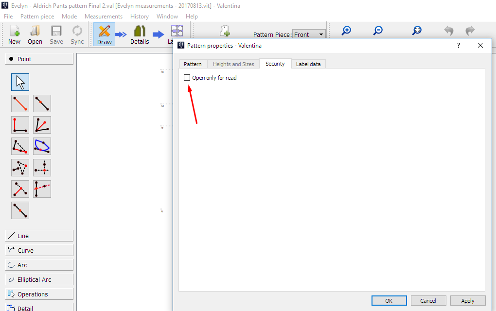

Check that this box isn’t checkmarked - File/Pattern Properties/Security:
I did, it’s OK I don’t understand, and I’m loosing works.
The error message is that it can’t save your file because it is in use by another process.
“Le processus ne peut pas accéder au fichier car ce fichier est utilisé par un autre processus”

So I want to clean up before reinstalling because when I open a knew document it’s on dropbox…
ok, i think that the problem is the dropbox synchronisation of auto save. It need to be synchronised before My own registration. So I change de duration of the auto save. Next step, change the default registration, and find the valentina files on my computer …

Do I understand correctly… you are trying to save directly to Dropbox? If so, can you save locally then copy to Dropbox?
You understand well, and that is the first time that I have this problem. It was easier to work at home. Anyway, I have to change but I have to change the default sving location, and that is my problem and I don’t find the file created by valentina.
