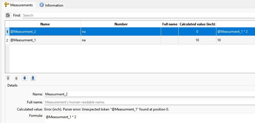

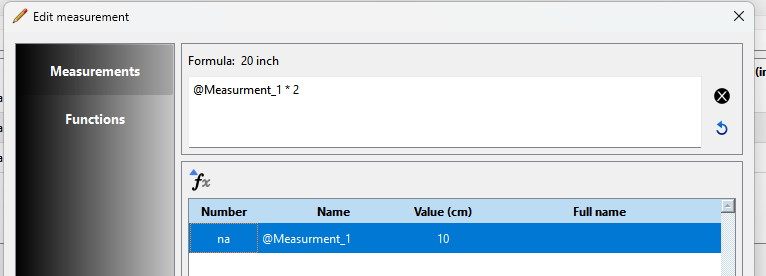

For example… I have here 2 measurements… Measurement_1 and Measurement_2. The formula for Measurement_2 is Measurement_1 * 2, or twice the value of Measurement_1.
This works fine because Measurement_1 is defined above Measurement_2. If we flip the order, it no longer works as Measurement_1 is not defined yet.

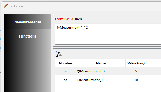

If we add Measurement_3 after Measurement_2, and then look at the fx editor

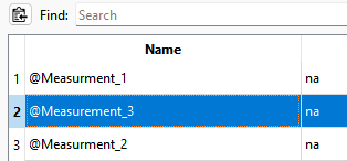

Only Measurment_1 is availbe to use in a Measurement_2 formula. If we move Measurement_3 up:
It’s now usuable for Measurement_2.

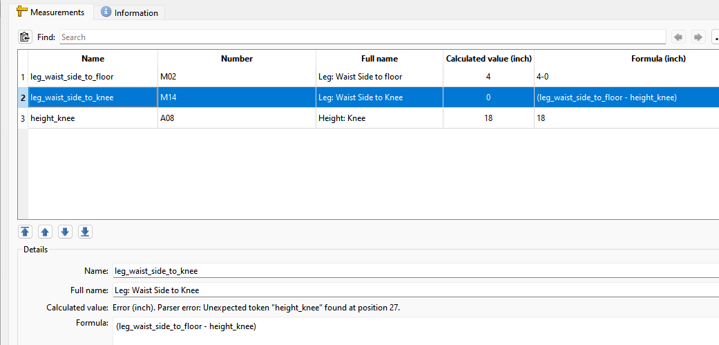

Thank you Douglas. I was talking about standard values For example M14 is calculated from M02 minus A08.
Both M02 and A08 have values, but I get an error in M14 result.

You missed my point… I only used custom measurements as it was easier to illustate.

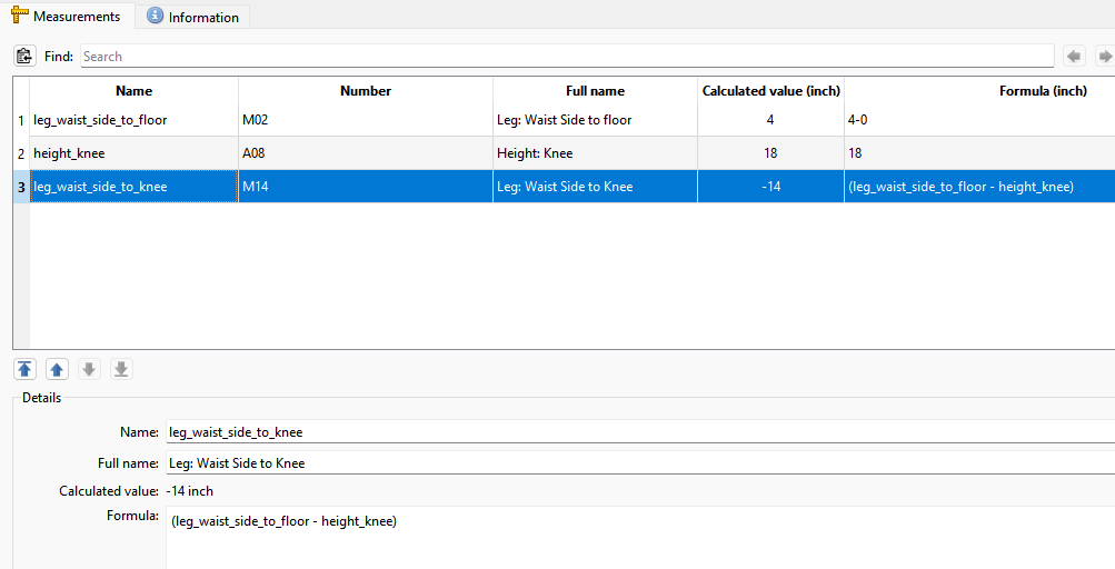

The formula for M14 is (leg_waist_side_to_floor - height_knee).. or M02 - A08… therefore M02 and A08 MUST be above M14 in the list:
This does not work and gives an error"
This works:
This is exactly why sorting of the table is disabled as the row order in which measurements exist is important.
