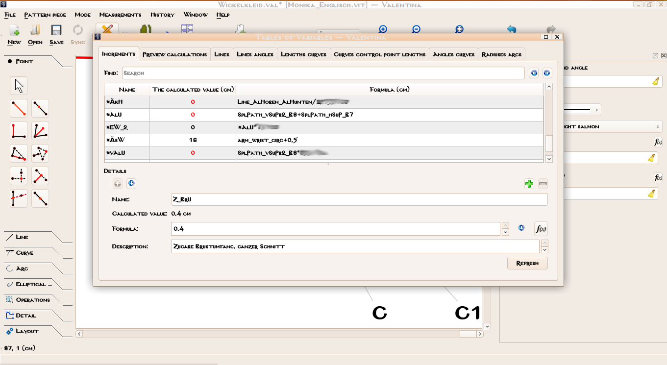

since the build of beginning of November I have troubles with variables. I want to make a variable in the variable table with a lenght of a line and some calculating on it.
Whenever I want to take the length of a (definitely existing) line, the next time I open the table the calculation says “0”. Also when I want to use the variable for defining the length o f a new line, the line becomes 0. Sometimes it shows the calculation right when I add a new increment. But that doesn’t last. The variables Table looks like this:

Can you upload the .val file and identify which build ver you are using… use Help -> About Valentina to find the build ver.

moniaqua… I took a look at your pattern file and there does seem to be a new issue with the increment formulas… it would do the same thing with a pattern file of mine that works fine in earlier versions of the program. I would bring it to Roman’s attention as it’s appears to be an issue in his recent build(s).

Hi, just bumping this up as I have the same issue. It’s really strange that I am able to pick the lines I want but when i hit refresh, the calculated value just says 0.
