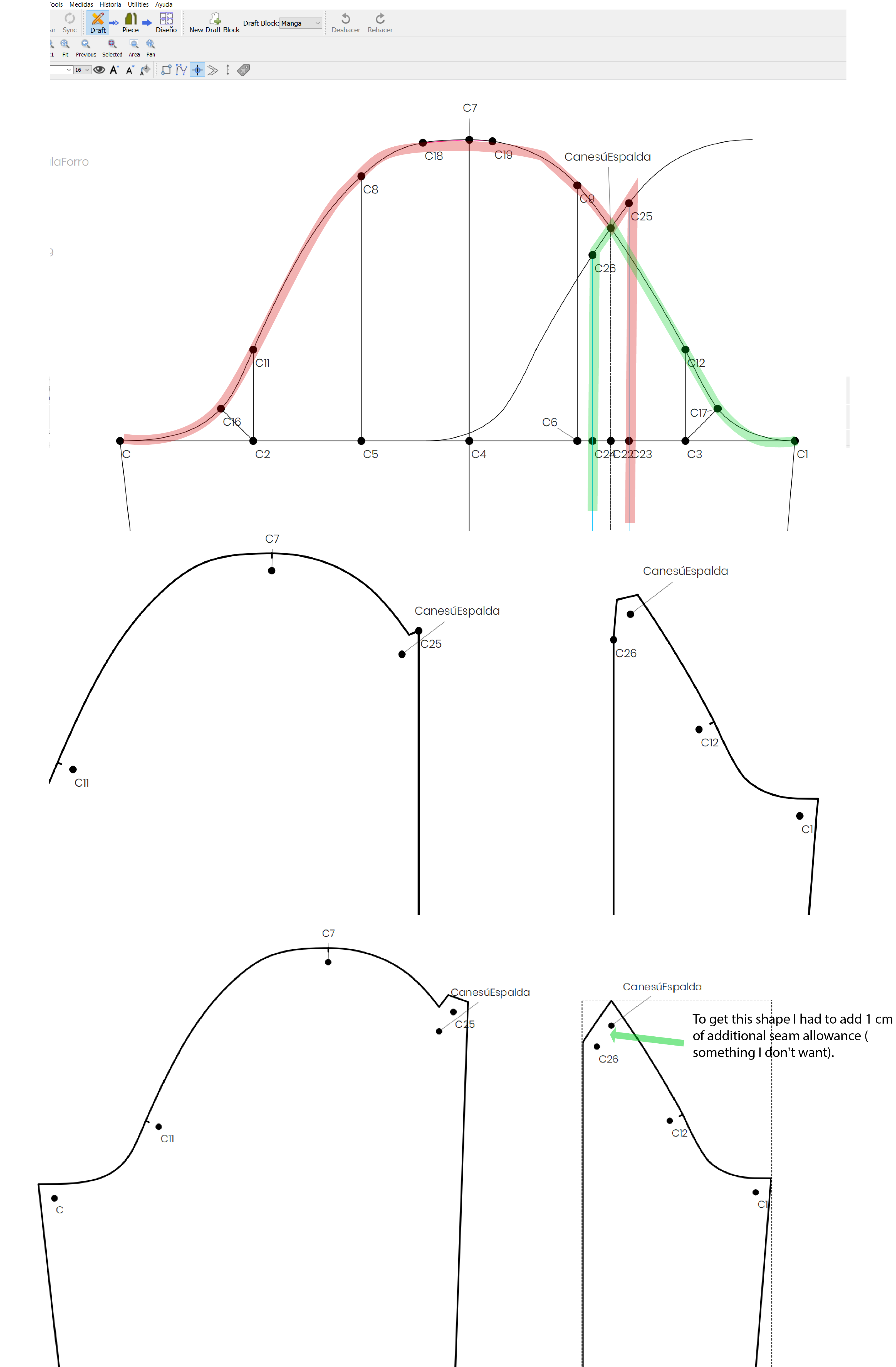

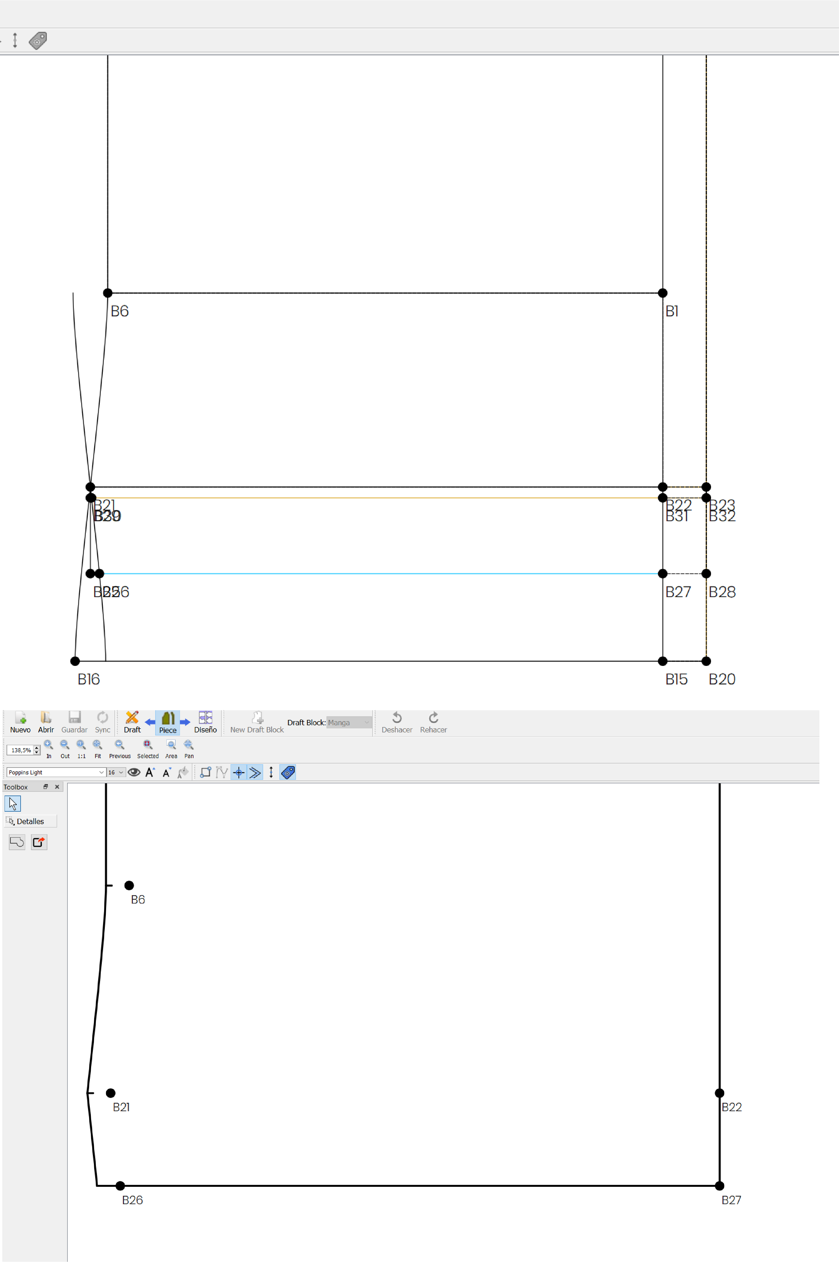

The first one, regarding seam allowances. I usually mirror draw the bottom of the garments and when I take the pattern to the “pieces” tab, I remove this seam allowance in the bottom part that is applied simultaneously to all sides of the pattern piece.
Please check this image as an example:
This works for me on the less complicated straight hems, however now I am creating a fake tailored sleeve (taken from the standard sleeve pattern, it has a cut in the back part and a small dart that goes up to the elbow level).
For these sleeve pieces I need the seam allowance to be mirrored, but I don’t get the desired result neither by doing it the usual way I work, nor with the seam allowance panel of the “pieces” tab. It’s as if the corner is too sharp and I cut it off by default.
Here are some additional examples:
How could I solve it? If the pattern looks like this there is no fabric in the margin. What would you recommend?

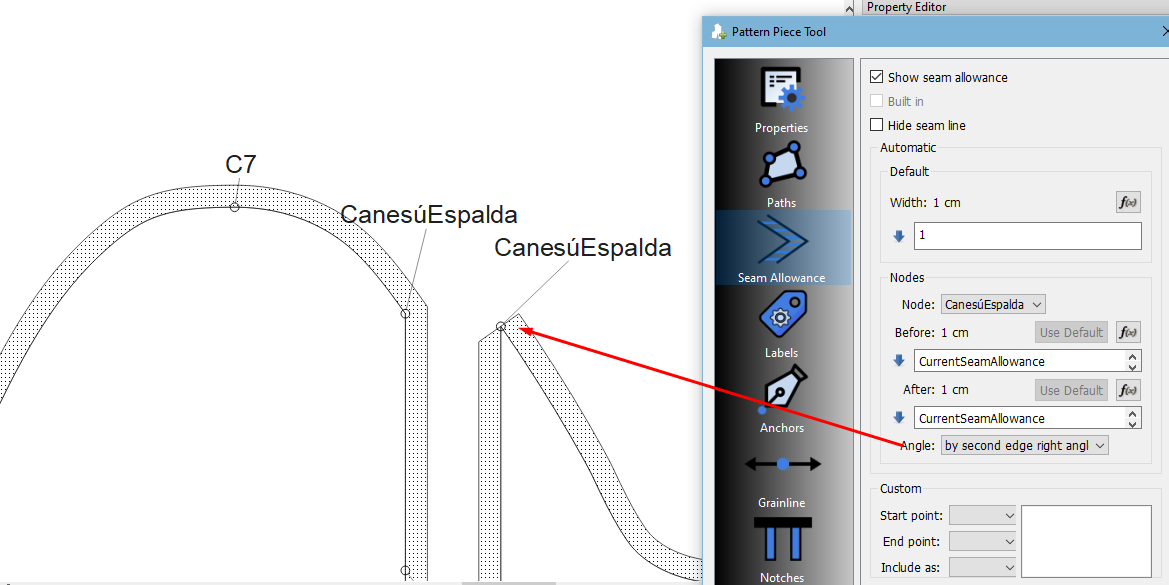

I don’t think that you will get the seam allowances exactly mirrored. I managed something on the side sleeve, but the main sleeve remained the same, no matter which setting I tried:
Here is your file back with the panels that I created with the full seam allowances:

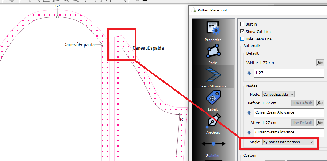

Also in fixing the recent issue with the seam allowances, I finally took a look at the “Custom Seam Allowance”… which may be an answer to getting a hem you desire?
In practice this a pain to sew… you have to make sure to line up the corner dots rather than the cut edge. Plus you run the risk of leaving a hole at the corner point as there is no excess past the point. Theoretically the intersection option would be the way to go as that keeps the seam length the same on both parts and removes the excess when pressed open. This also can be one of those issues where which point you start the piece path with can affect the SA… or again the control point angle and length going into a corner can affect the SA.

As far as the seam allowance on the sleeves I’m not really sure what the problem is.
This is exactly how I’ve been doing an outside sleeve seam for 40+ years. Just added the seam allowance, and used the Angle: by points intersection on the under part.
Which produces this when sewn and pressed open… this is the 2 pieces overlayed: The red line showing how the length from the CanesuEspalda point to the cut line is the same. Assuming the pieces are cut accurately, it’s easy to line up the the 2 seams matching the yellow point of each piece, and just sew the seam. Removing that little triangle automatically establishes the allowance width without knowing what the width is or what marks on the throat plate to follow. Any other corner type requires you to THINK and match up the CanesuEspalda points to be correct.
overlay
