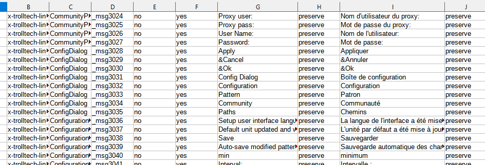

Discovered you can Export a Qt TR file as a XLIFF ( XML Localization Interchange File Format ) in Qt Linguist, then load that into LibreOffice Calc and save as one of the various spreadsheet file formats. :slight_smile:
Oh, wonderful :clap:t2: :clap:t2: :clap:t2: :star_struck:
