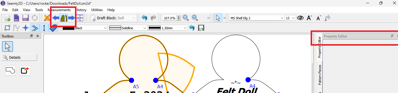

Are you in Draft mode? The Property Editor greys out in Piece and Layout modes as it’s not used in these modes.

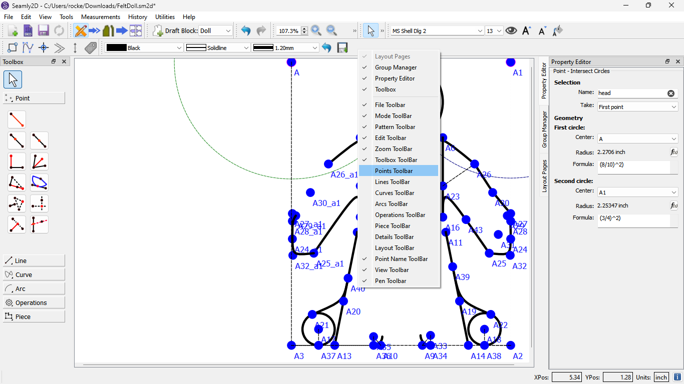

Here I have most of the toolbars toggled OFF - including the Points Toolbar… the Properties display just fine. Like I alluded to… if has to do with BEING in draft mode and having the Properties Editor toggled ON. The Properties Editor greys out when in PIece and Layout modes.
