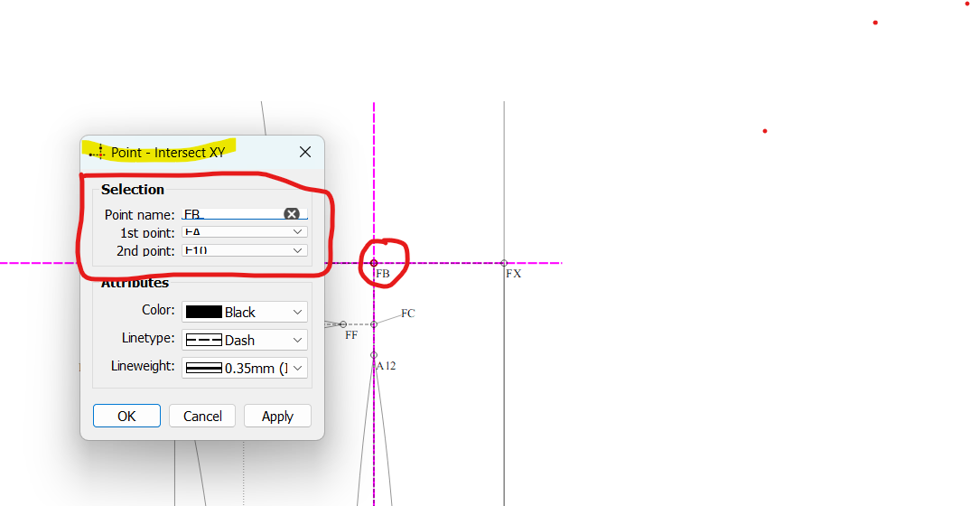

En la herramienta Point Intersect XY, cuando le doy clip derecho para trabajar con sus propiedades, se me muestra asi,(ver imagen), no se puede modificar la ventana y no se pueden ver las opciones.
Me again :see_no_evil: :upside_down_face: :slightly_smiling_face:
In the Point Intersect XY tool, when I give it the right clip to work with its properties, it shows me like this (see image), the window cannot be modified and it cannot be see the options.
PUNTO INTERCEPCION XY
Sin embargo desde la ventana del editor de propiedades si se muestra correctamente.
However from the property editor window if it is displayed correctly.
PUNTO DE INTERCEPCION XY

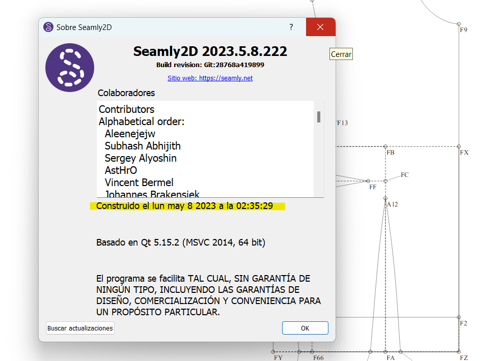

Actualice a la ultima version de Seamly 2D
Upgrade to the latest version of Seamless 2D
VERSION DE SEAMLY
y sigue el mismo problema.
and still the same problem.

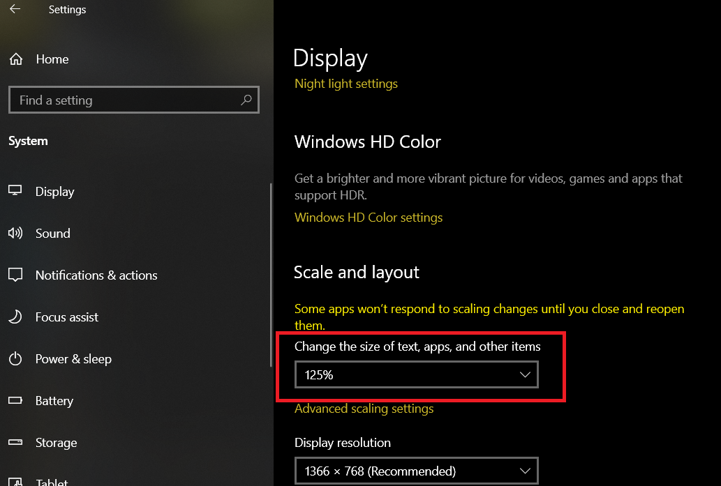

I’m using Windows 10, so I’m not sure what the “settings” look like with Windows 11… but here’s where the you can change the scale and resolution of the System,->Display
Changing the scale makes the system font larger - that is easier to read.
